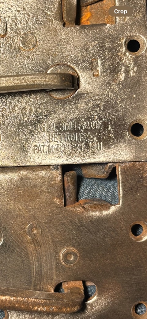

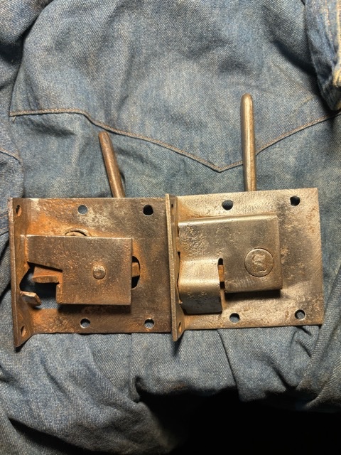

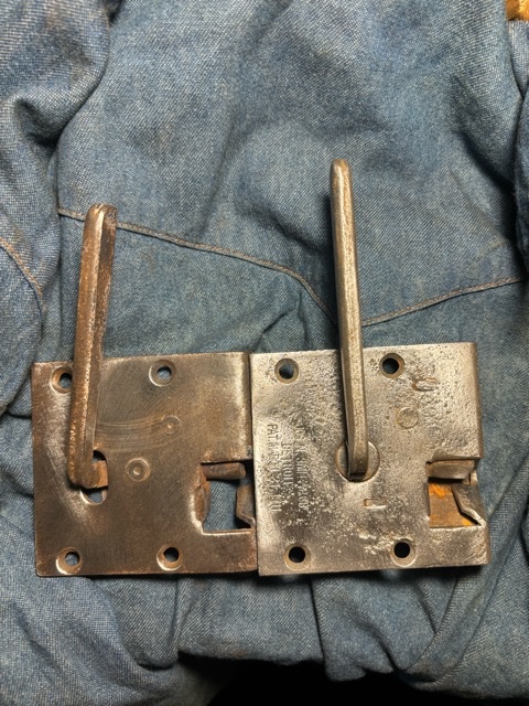

Here are some pictures of the 2 different 1914 door latches.
Both use the exact same strikers and mounting screw locations. Their construction is slightly different but the main difference is where the handle itself is located.

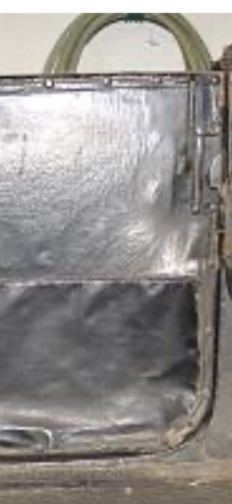

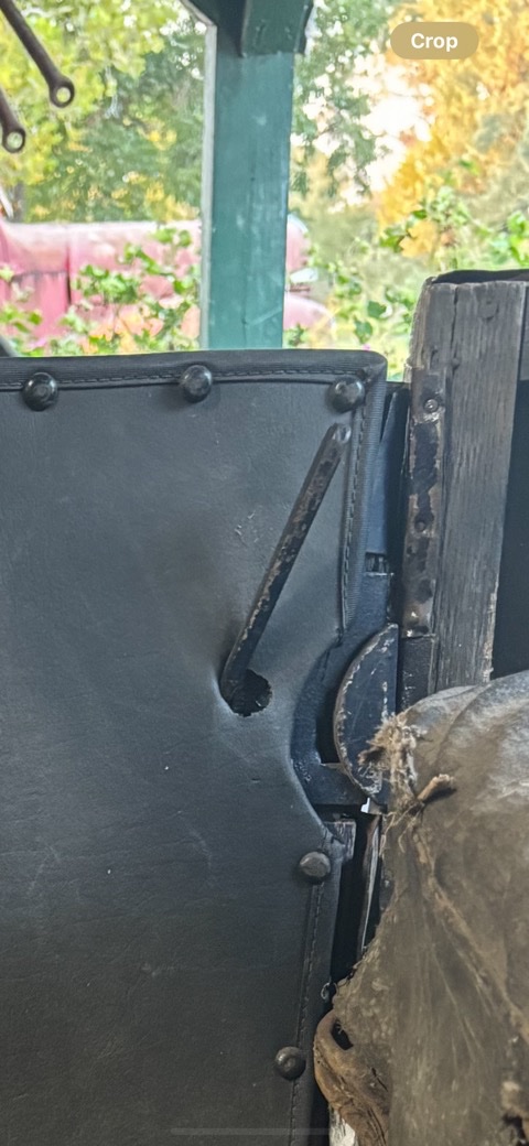

It is important to know in case you are buying a new interior with the hole for the handle as such. I have here a factory photo where the area for the latch is cut out and stitched around. Not sure if they were all like that but if you get a new kit with a hole there is about a 1” difference. It is easy to tell the difference because the one with the longer distance between the handle and the edge has a space and the other is filled in so you can’t see through that area.

They are both real. The one on the left is later.
