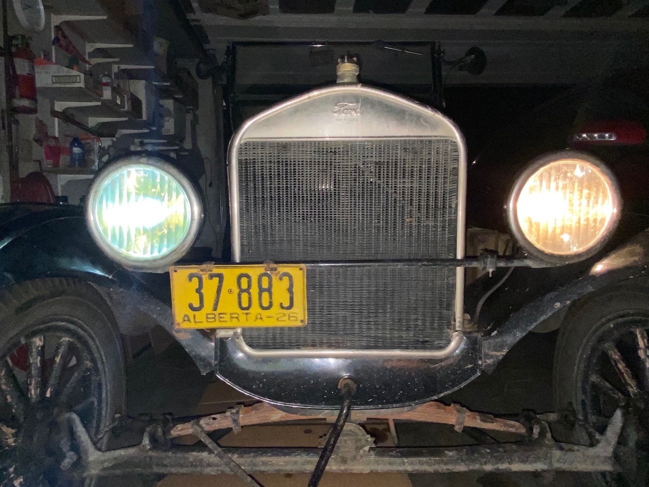

Front view, LED on the left, incandescent on the right. And what about that toe-in, eh?

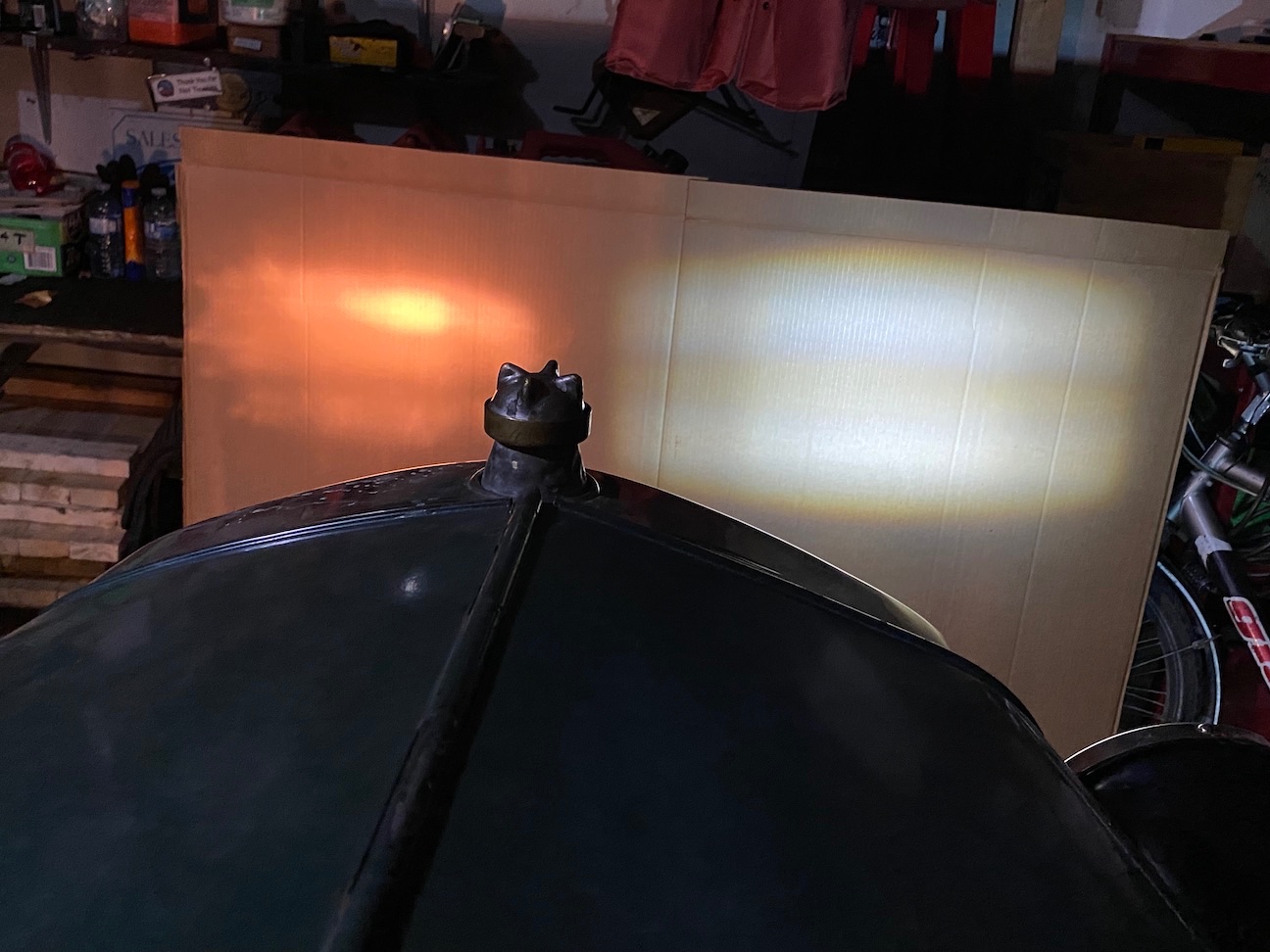

Light switch on DIM:

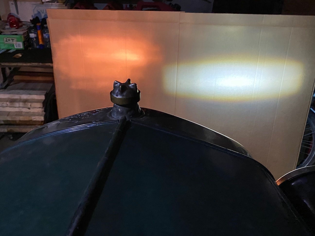

Light switch on BRIGHT

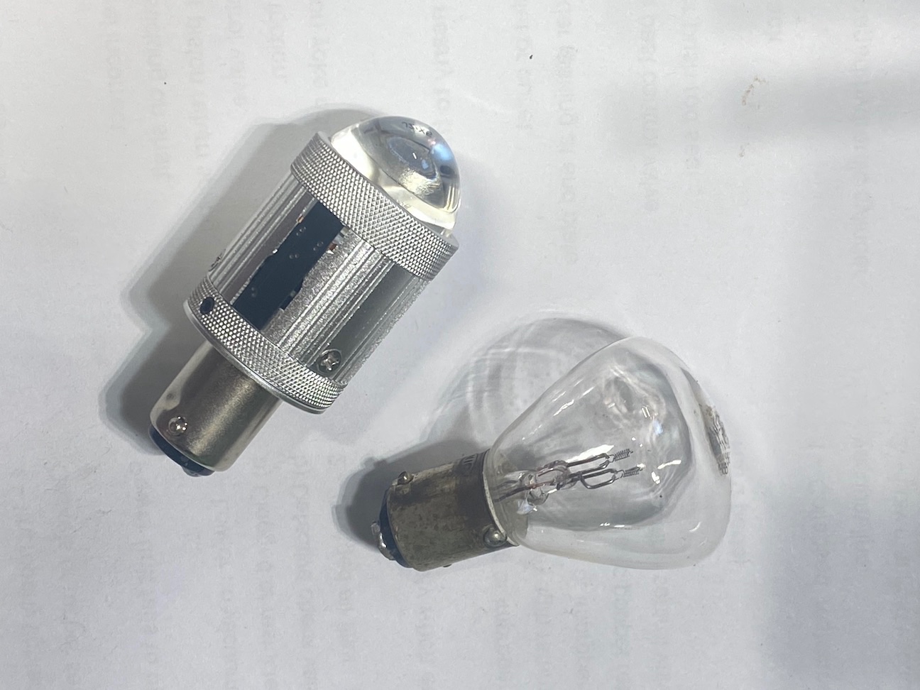

Old & New side by side. LED users are instructed to align them in the sockets such that the thick black band is exactly at the top when installed (or, could be at the bottom depending on which way the external headlamp connector is oriented.) There are two small hex set screws (one visible in the knurling at the black dot) which can be loosened to rotate the lamp body relative to the base. A hex wrench is included with each bulb.

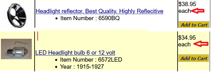

Let's be practical. On a practical level... Being the current draw that each of these bulbs will take from the battery, Incandescent bulbs as standard whether it being 21 candle power or 32 candle power headlight bulbs with a 21 candle power tail light will easily draw four to seven amps that your generator has to work a little bit longer to replenish your battery. With the LED bulbs you can have both headlights and a tail light of LED bulbs. Only take maybe 2 or 3 amps if that, putting LESS strain on your generator to recharge your battery and in less time. Being practical, what would be the obvious choice?.....

I believe the poster is a little confused though. The right headlamp has the LED bulb.

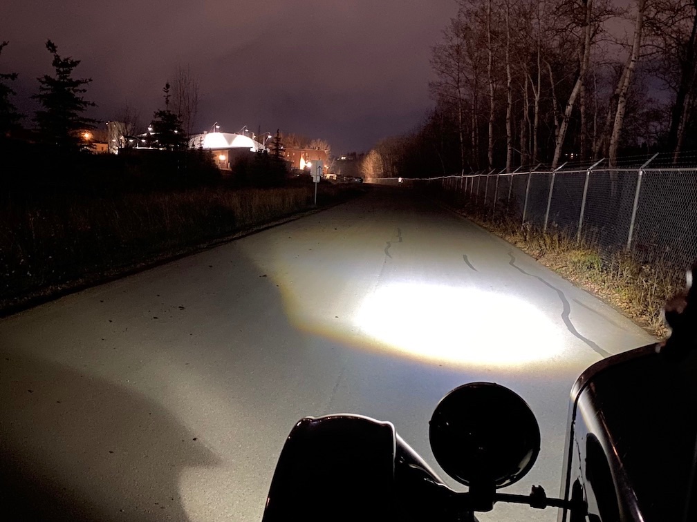

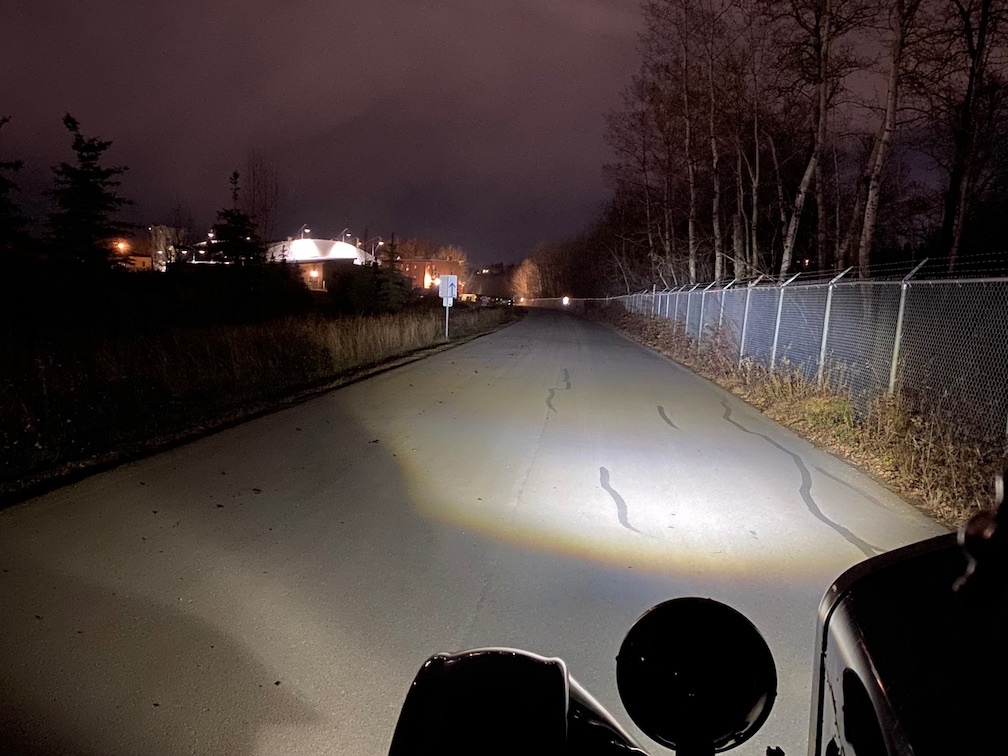

Here are comparison photos of my new LED headlamps in the dark. Dim vs Bright settings.
Photos were shot in low ambient light with no flash. The iPhone lightens things up a bit.
The Dim light pattern suggests both headlamps could stand a slight lift. The Bright setting looks pretty good as is.
