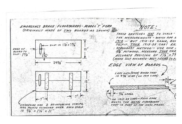

checking if anyone that built a speedster body from the Lee Thevent plans Looking for the hole size and placement in the body for the parking brake ?

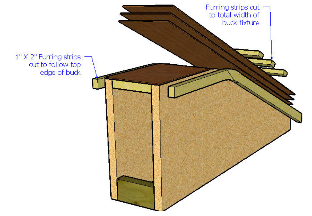

I can do it with Measuring and math but figured why reinvent the wheel if someone can pic or has measured what they did. it is not mentioned anywhere in the plans. He also has plans on making wood fenders ? wouldn't mind trying just to see how they look but not sure if want to go through the work if others have tried and didn't turn out as well as thought or rounded wood seats for that matter ?

If this is the Lee Thevenet speedster body you are referring to then
I found this should work
How to make wood fenders https://www.horselesscarriagereplicas.c ... et_Jan.pdf

Thank You !
That was what I was looking for !
