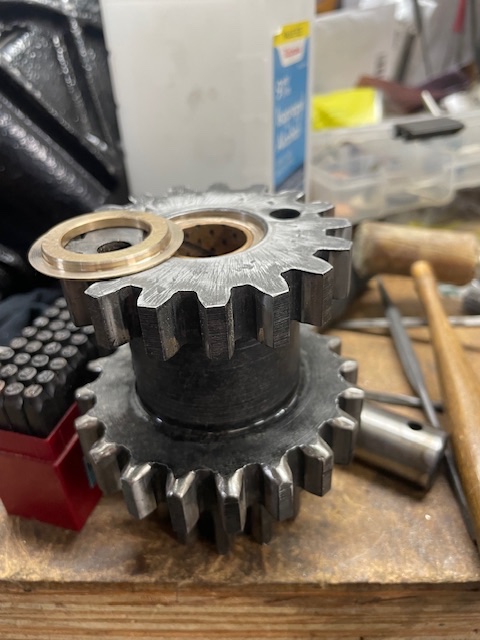

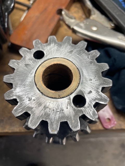

The old idler shaft was worn and 22 mm. The new idler shaft is 7/8 so I reamed the case out to fit it (the difference is about 0.010). The bushings in the idler gear are in decent shape so I was planning to ream them to fit the new shaft and run them as well. My question has to do with the interface between the idler and the case. The bushings appear to have had a thrust surface on the end (see picture), which is worn so the end of the gear is running on the case. There is a little back and forth play in the idler gear. They are straight cut gears so there is no real thrust.
So here is the question, did the original bushings extend past the gear to provide a friction surface? If they did I could replace them or machine out a space and press a bronze thrust washer in the end of the gear to build up the thrust surface.

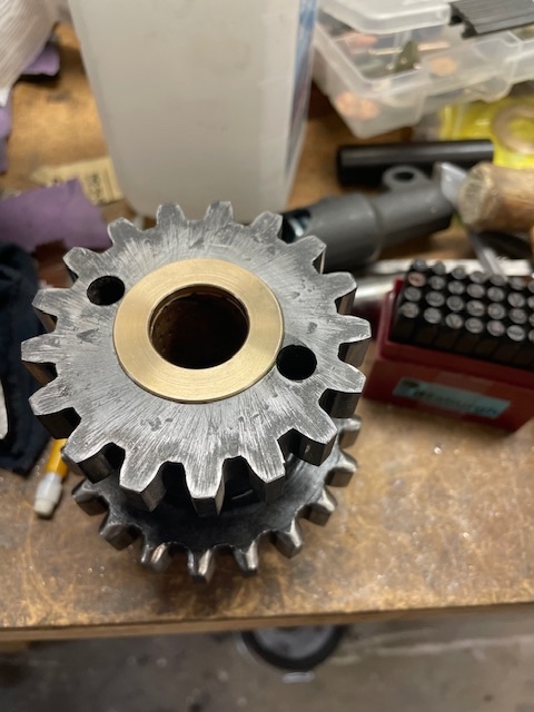

I fit a new thrust bushing to take up some of the fore and aft slack and reamed the old bushings in the idler gear to fit the new (slightly larger dia.) idler shaft. I still need to make a new pilot bushing for between the input and output shaft. Going to work on that tomorrow.
