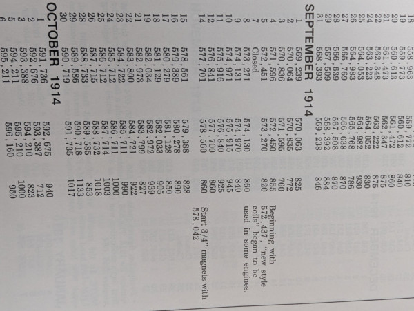

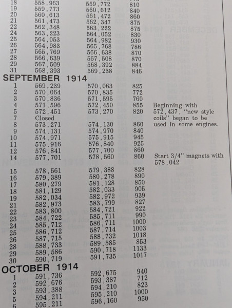

Re: 1914 Manufacture Date Assistance
Looks like September 26th. 1914 according to the listing in Bruce McCalley's book "Model T - the car that changed the world""
Reading better. ?. That was one of 1018 blocks cast on that day.
