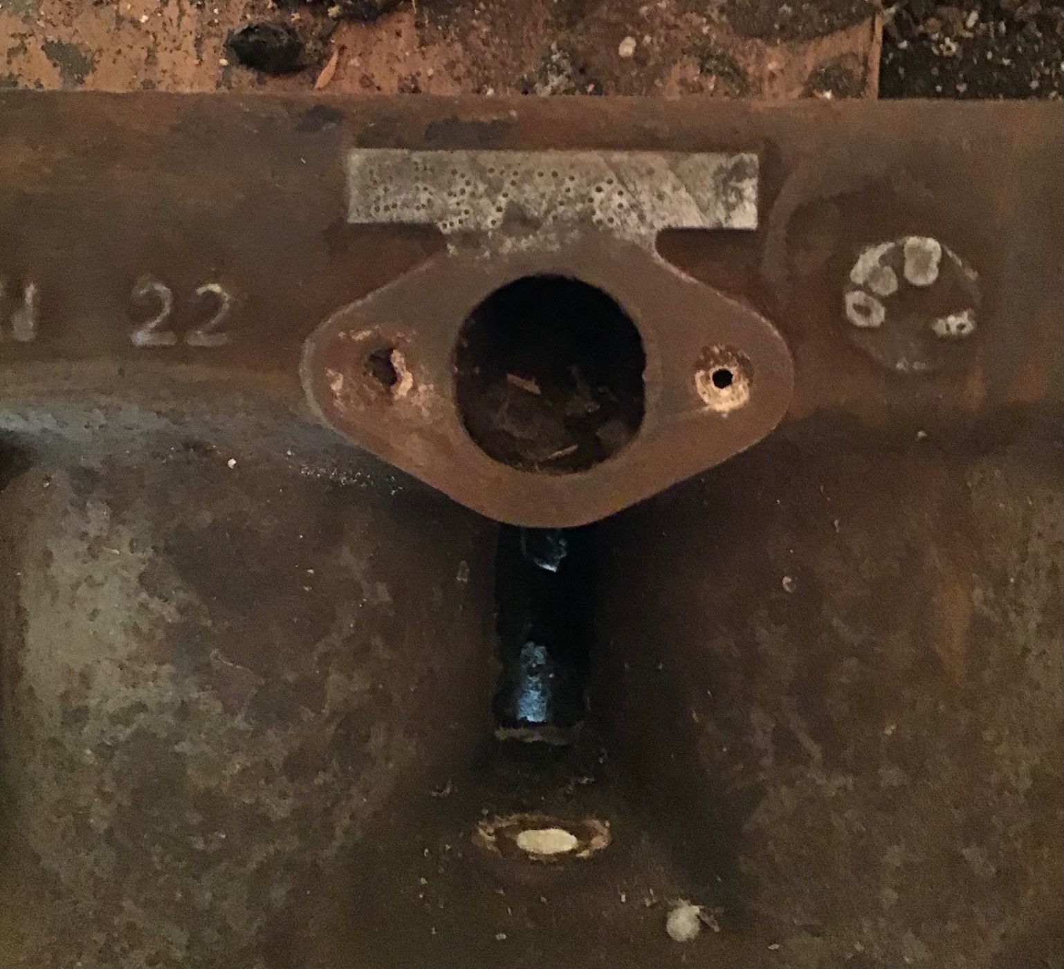

Earlier this year (as I remember) I posted about restamping a block. Several members stated that rather than restamping the pad on the block, directly, that they used a thin piece of brass, cut to the shape of the pad and stamped the new number on the brass plate. then, they glued the brass plate to the pad above the water inlet and painted it to match the engine.
I'm getting read to do this to a vaporizer block that was, according to the seller that I acquired it from, used as a stationary engine that ran long hours. This could be very true as the cylinder bores were worn so much, all four cylinders had to be sleeved back to standard. I have searched for my original post, but can't find it, so my questions are: 1. How thick a brass stock did you use? 2. Did you just form it to cover the number stamped on the block above the water inlet, or did you make it large enough to cover the water inlet boss and the number pad with one continuous piece of brass. 3. I if covered only the number pad, did you mill the pad down the thickness of the brass so the brass plate was smooth and even with the water inlet boss?

OK, I see I have some who approve, and some who disapprove. I should have put this information in my original post, but forgot to. Here is the situation. When my Dad and I restored this 27 coupe (it was his father's car; my grandfather's car), we did a frame off restoration. After sandblasting the frame, no matter how hard we looked and tried, we could not find or see an original number stamped on the top of the right frame rail. To complicate matters, Grandfather had ruined the original block at some time (probably let it freeze) so he went and replaced the original block with a 1922 numbered bare block and used the crank, rods, pistons, pan, transmission, and possibly a few other parts from the original 27 motor, to throw together a "backyard motor". The engine number on the title to the car was changed to reflect the 22 engine number so in reality, we have no way to knowing the original 27 number. In the late 1960's when Dad and I restored the car (the first time), we went ahead and had the 22 block rebuilt even though it had a freeze crack about 12 inches long in a straight line, along the bottom of the water jacket on the driver's side of the block. We had the crack repaired with what looked like solder. It held for about 20 years before failing. After My Dad died, the car sat in the garage at my Mother's house until she died in 2008. Since then, in between four moves and heath issues including a quad bypass surgery in 2009, I have been slowly restoring the car to correct flaws in the first restoration, including new body work and paint, new interior, and a new 27 vaporizer rebuilt block to replace the cracked and incorrect 22 block. Since I didn't have the original serial number, I bought a rusted, cracked 27 block at Chickasha and will use the number from that block for the car since the rusted block is going to the metal recycler. I'm not trying to fool anyone about the engine number, but I have to have a 27 number to replace the 22 number that is on the current title. Yes, I could leave the 22 number on the title, but that is just as deceitful. The vaporizer block I am using, being a stationary engine has a non-Ford number stamped on the pad. It begins with "B" and only has about 5 numbers after that, so the stamped number is far from looking like a Ford number. This is why I want to change the block's number. If I knew a machine shop that would mill the pad to remove the current number I would, but I DON'T.

I Had planned to try to remove the non-Ford number from my 27 block with a hand file or a Demel tool, even before I read the months earlier post about stamping a brass plate. After reading everyone's posts, i think I will revert back to that method. If any file marks are left with the file, I'll either go over the area lightly with a finer file or use a piece of Emory cloth attached to a small wooden block. As for legality, in Texas, even if you are changing the motor number on a title, it can be done (and I have done it previously) at my county office where title applications are made, prior to them going to the state for finalization.kmatt2 wrote: ↑Tue Nov 26, 2024 10:21 pmTerry, As others have said, the brass plate over the original Ford number boss is a bad idea, it would be easy to spot by any offical checking the number. You don’t have to take the 1926-27 block that you are using back to the machine shop to remove the non Ford number. Get a good sharp mill file and a good right angle handle. Take the water inlet off the block and carefully and slowly file the old number off, the number stamping wouldn’t be that deep, be sure to file the complete boss and water inlet area. You should keep the cracked 1926-27 block that you are going to use the number off of, with the crack marked with some paint. Now you can stamp the good block with that number and not worry about how close the stamps you use are to the Ford stamps because you still have the damaged block in case something comes up. By the way you say that you are going to use a vaporizer carburetor so you would need a late 1926 engine number or a 1927 engine number so you should be ok if that junk block had a 1927 number even if the car is called a 1926 on your title. A 1927 car made in late 1926 could have had a later 1927 engine installed at some point. Enjoy your car and good luck at your State DMV.

Terry, a belt sander may be easier to get a flat surface for you to stamp onto, even if it is only used to finish off your file work.

Allen, you are correct, a belt sander would be easier than filing, but a table belt sander is out for obvious reasons and even most handheld belt sanders are so big and heavy that it might be hard to sand the inlet/pad surface evenly without letting the belt hit somewhere else on the block, causing an unwanted injury to the block. I am going to check and see if any company makes a mini handheld belt sander, however I hate to buy a expensive tool for one job. A couple of files and Emory cloth should be a lot cheaper.

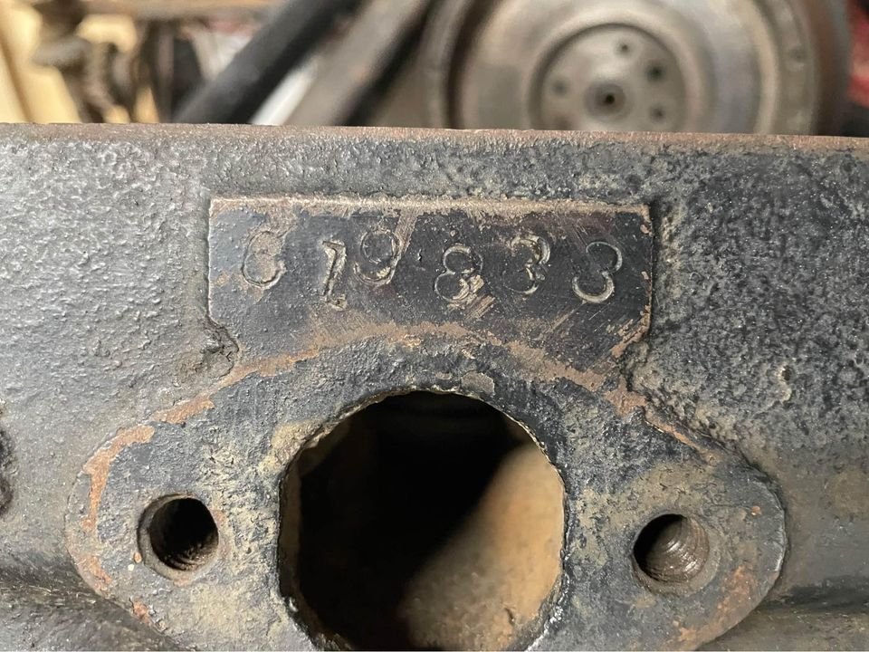

Make a stamping guide out of scrap angle iron or strap steel and drill mounting holes to mount guide using water inlet bolt holes. The following pictures of Ford assembly from around 1918-20 are taken from a Ford made movie on Model T assembly.

I have yet to see a T model engine number stamped all in line and all numbers standing straight up. If I was a DMV inspector and saw this, I would suspect something nefarious was afoot.

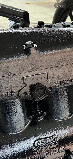

I agree that the numbers were not all straight, at least in the early years. The freshly painted block is mine and the other one is for sale on Marketplace. Arthttps://www.mtfca.com/phpBB3/download/file.php? ... &id=202923
