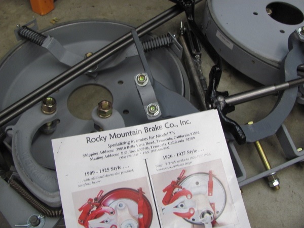

Those R-M brakes he purchased have to be used with a larger drum, supplied with the R-M set up. That larger new drum is sandwiched between the existing small drum and wheel. [ i.e. the new larger drum goes on the wheel bolts, then the original small drum is placed inside the new larger drum and nuts fastened, for the original parking brakes function.] So the fixed drum on his wire wheels makes those unusable.

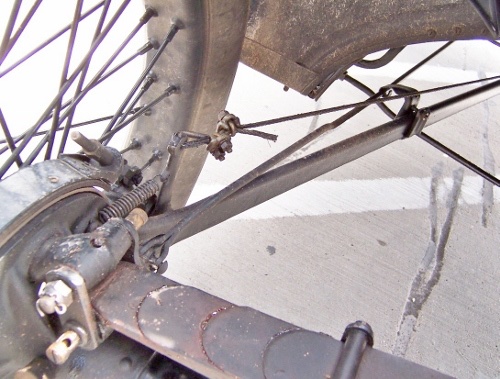

The A-C type are made for existing small drum, so perhaps they will fit his wire rear wheels. This photo shows A-C type on a typical laced wire wheel.

Dan's photo shows a laced wire wheel with spokes laced directly into the wheel rim. Hayes wire wheels have demountable rims, with the spokes laced directly into the outer felloe at one end and directly into the brake drum at the other end. This places them much closer to the brake shoes. If there is any run-out in the drum, you do need to make sure the shoes cannot ride outwards onto the spokes. It is not hard to do.
