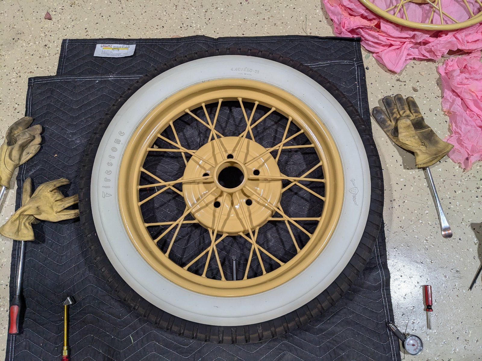

Installing tires on a Model T or a Model A is no one's favorite task to do.  Having installed three sets of tires on Model T's in the past, I have found that tire spoons work well for me.  However, there's still the risk of scratching up the rims.
This past week I decided to have the rims from our 1929 Model A Tudor rims powder coated. The rims had been painted when it was restored in the mid 90s, but they had a few runs and had a few spots where the paint had chipped off. Fortunately there is a nearby powder coater that I have used in the past to coat the frames and running boards on the two Ts that I restored. They did a great job for a very low price and now have a durable, run free appearance.

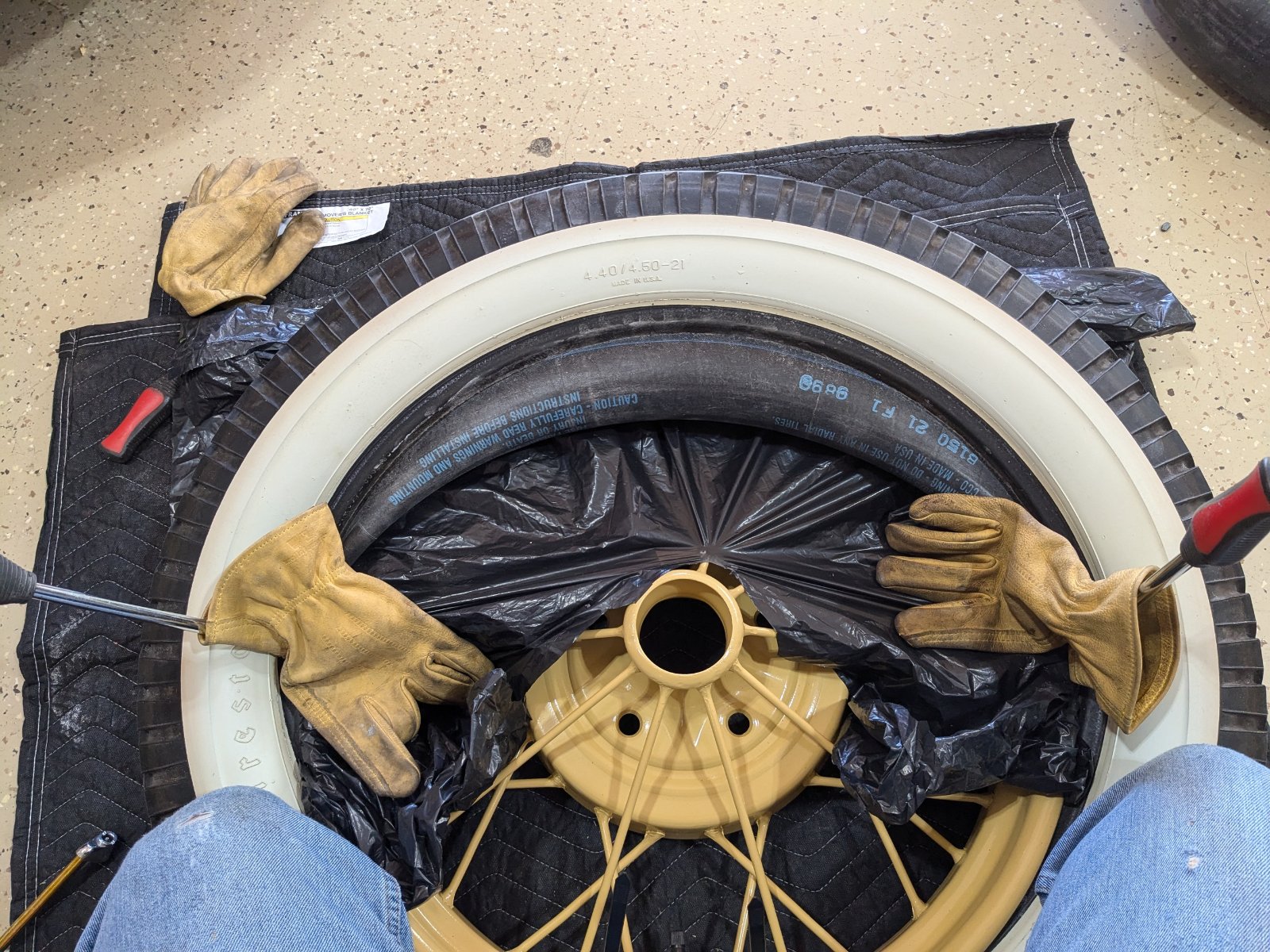

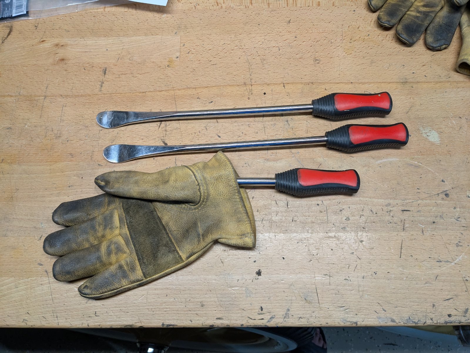

Anyway, I still needed to reinstall the wheels and didn't want to nick the rims when I installed the tires. I decided to try using some leather work gloves to protect the rim from the spoons. The gloves worked great for doing that. I put the spoons in either the thumb or index finger while using them. They not only protected the rims, but are also a little slippery which always helps.
Here are some pictures of the process and the result. Having now installed both T and A tires, I found that it is much easier installing A tires.
Neal

They came from Amazon. Do a search for "tire spoons" on Amazon and it will show numerous sources. I would suggest getting three of the 14.5" long ones.John kuehn wrote: ↑Sun Dec 08, 2024 4:25 pmWhere did you get the tire spoons. Looks like they would work well.

Model A tires can be mounted without tools, I just did six using plastic trash bags to make the tire slide over the wheel.   Model T tires would need the tire irons and would be much more difficult to mount without scratching the paint or powdercoat.  I have used duct tape on the irons and still left marks.  The leather gloves are a good idea.  Art

You are correct. However in my case, the tires are maybe 30 years old and the I couldn't get the tires warmed up, so they were a bit stiff. I did use the garbage bag method which works great, but I was just not strong enough to get these tires pushed over the rim. That's when I came up with the idea about using the leather gloves over the spoons. I also have those big HF tire irons and those ends easily fit into a leather glove.Art Ebeling wrote: ↑Mon Dec 09, 2024 11:48 amModel A tires can be mounted without tools, I just did six using plastic trash bags to make the tire slide over the wheel.
The gloves worked so well that I don't ever plan on removing or installing tires again on an A or T without using them to protect the rims.
