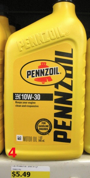

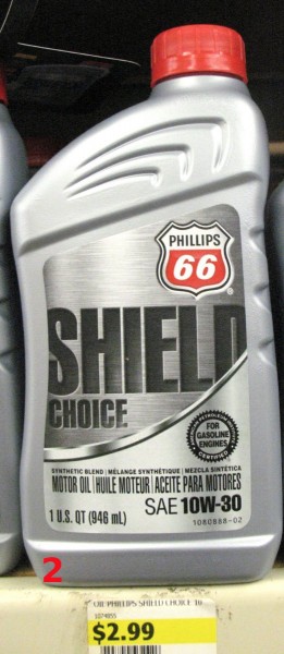

Post by Steve Jelf » Tue Jun 11, 2019 11:41 am

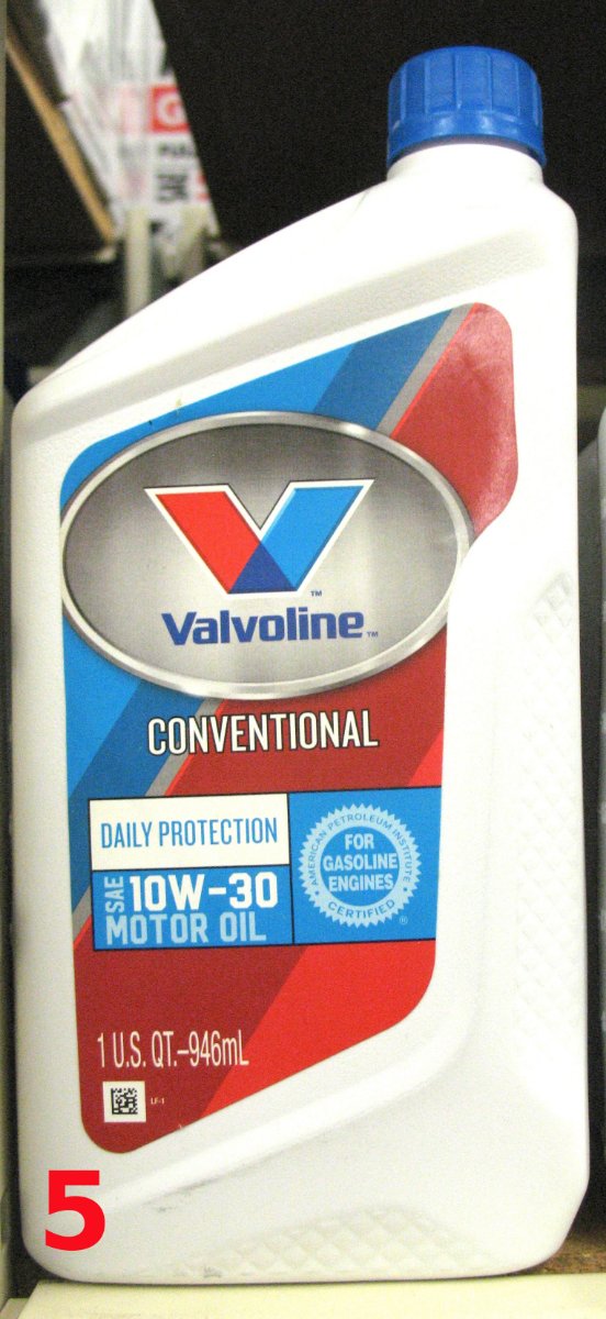

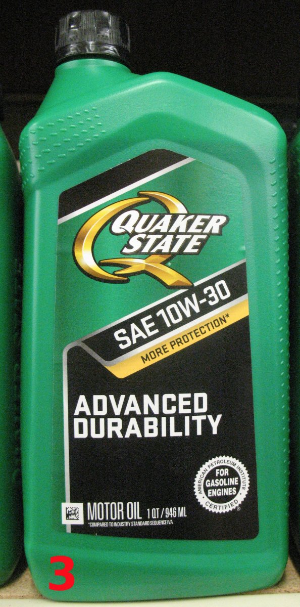

Let's go shopping. Just so we'll be comparing apples to apples, we'll restrict our choices to conventional 10W-30 motor oils. Here's are some we find at Walmart.
1 quart Chevron....................$4.42
1 quart Pennzoil....................$4.68
1 quart Quaker State.............$4.24
1 quart Valvoline...................$4.47
1 quart Super Tech................$2.78
These all have the API certification mark (Starburst) on the container. https://agriculture.mo.gov/weights/fuel ... icants.pdf
Which one is best?
Why is it better than the others?
Are any of them unacceptable? Why?

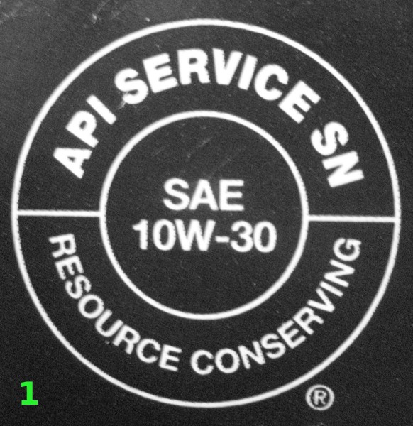

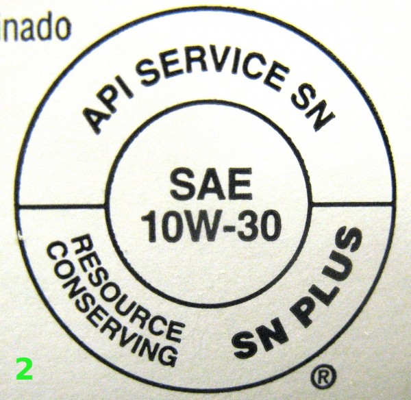

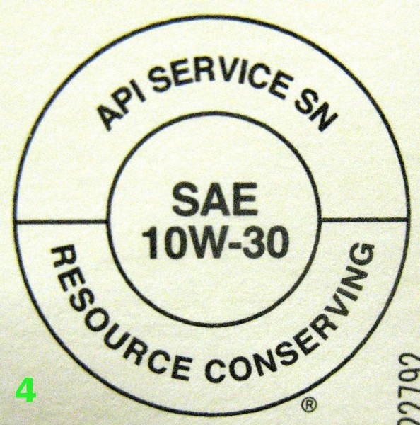

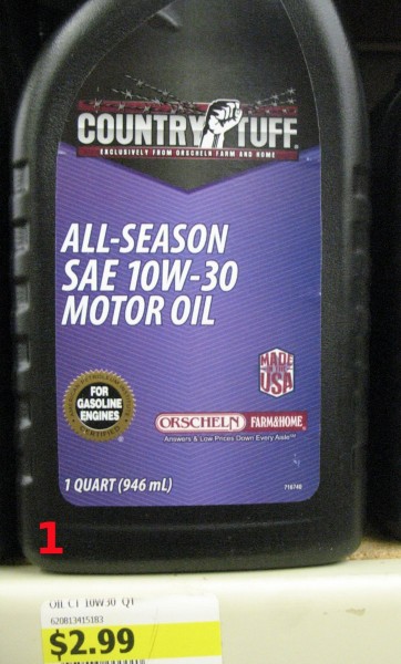

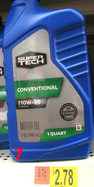

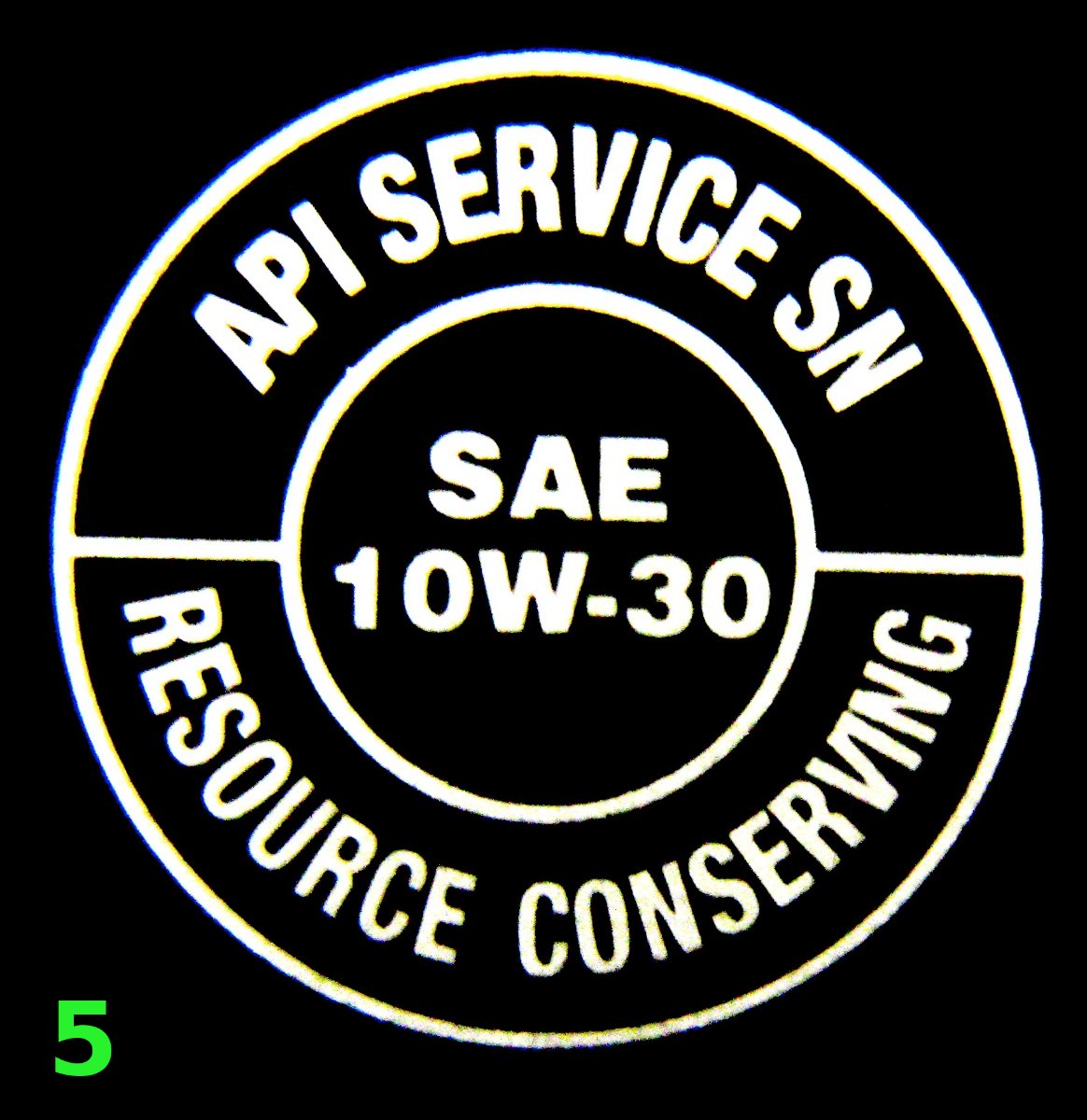

Post by Steve Jelf » Wed Jun 12, 2019 10:37 pm
Scott, thanks for the excellent link. If I understand correctly what I read, it confirms what I thought: 1 The API sunburst shows that the oil has been rated by the American Petroleum Institute; 2 The API donut on the container tells the characteristics of that oil. I looked at oil on the shelves at a couple of local stores. Here's what I found.
Posts: 7413
Re: Best oil, I’m almost afraid to ask...
Post by Steve Jelf » Wed Jun 12, 2019 10:43 pm
Based on the information provided by the API, which of these seven is best? Why? Is there any we shouldn't use? Why? If the API donut isn't enough, what criteria should we use in choosing an oil?

Steve

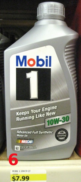

The API donut tells you which classification the oil within meets. All of the ones you posted are SN or SN plus. Based on those posted, the SN Plus is the "latest" in rated oil. Considering the extra oxidation protection, etc., that SN and SN Plus offers, I personally would be fine using either.
What folks don't realize when they say they paid "$1.99" for their oil and that it is "better than oil back in the day", they are likely purchasing severely under-rated oil, which is available in many places. Yes, it is probably better than oil in the 1920's, but perhaps only barely (and maybe not at all). All oil is NOT created the same, is not categorized the same, and usually the lack of quality/superiority is reflected in the price.
One final link to show the differences in ratings: http://www.pqiamerica.com/apiserviceclass.htm
Note: just because a classification is listed "obsolete" does not mean oil is no longer produced to this classification...it definitely is still produced.
I am as big of a bargain hunter as there is. I just recognize that because something is cheap, that doesn't mean it's a good deal or even a good idea. However, I doubt this will sway many who are simply determined to spend as little as possible on their oil. The bottom line, is they are buying on emotion, with little regard of facts.

Yes, I read that page when I looked at the previous link. Based on the donut info, I surmise that all the oils I checked would be OK, and that #2, #3, and #7 (SN PLUS) would be the best. Here are the containers bearing the seven donuts pictured above.

Post by Steve Jelf » Thu Jun 13, 2019 1:22 am
I meant to include just conventional oils, but I see that this one is synthetic.

If price is the best indication of quality, it's easy to decide which oil to use. Buy the one with the highest price. :)

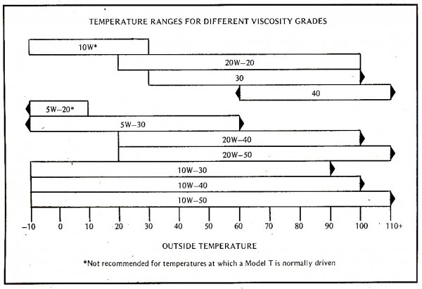

Post by Steve Jelf » Tue Jun 25, 2019 11:56 pm
.... didn't you have a serious problem running 0- w20 viscosity oil on one of your trips ???????????
Yes, I did. It was actually 5W-20. Having read that Ford recommended 20 weight oil, I mistakenly thought 5W-20 would be the same. It's actually a much lighter weight oil, and may have been a contributing factor in my rod failure. Loss of oil through a bad leak didn't help, and may have been the main cause of trouble.
