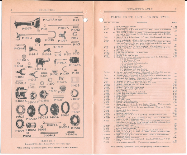

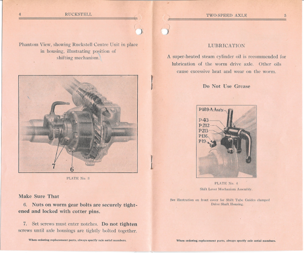

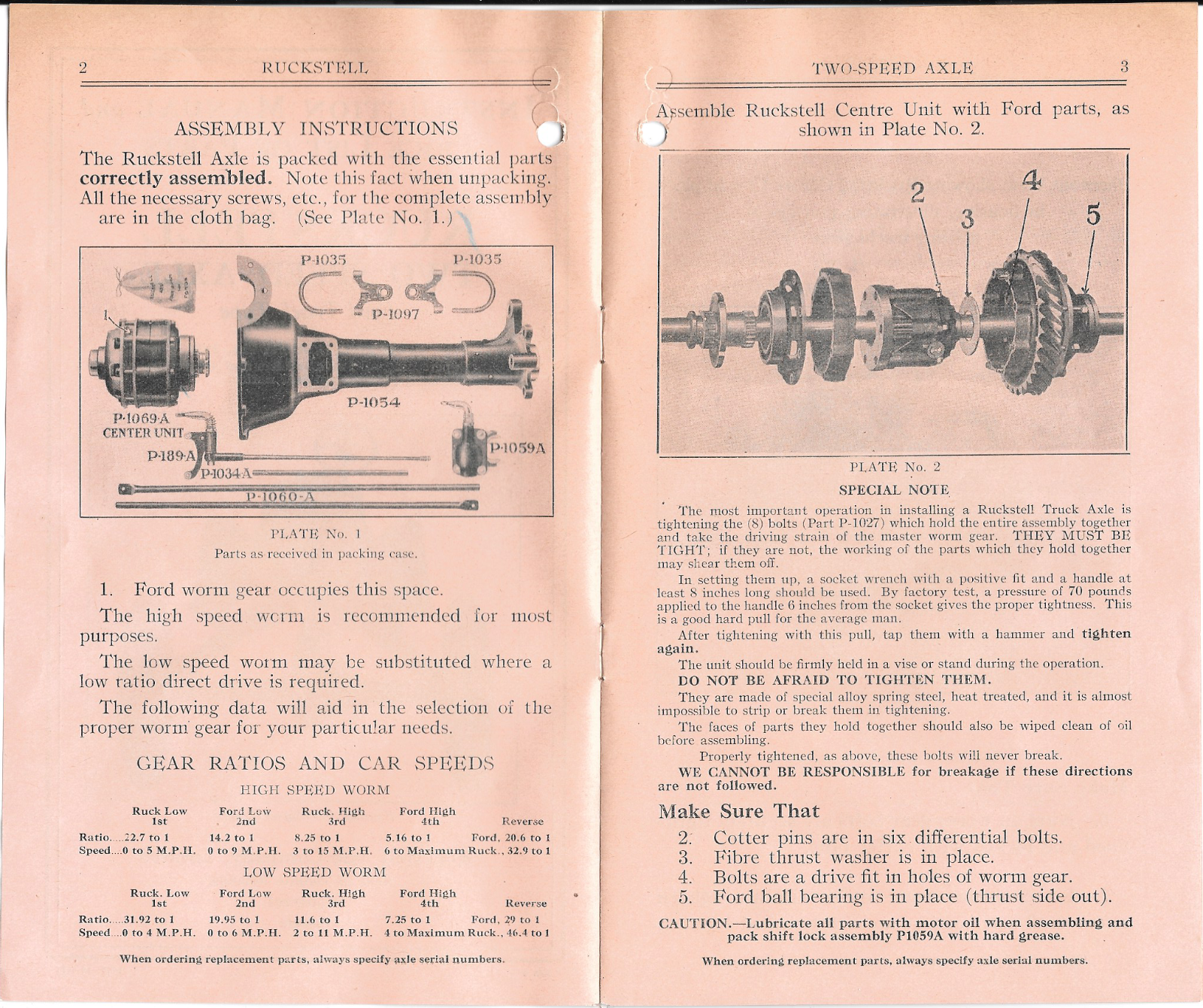

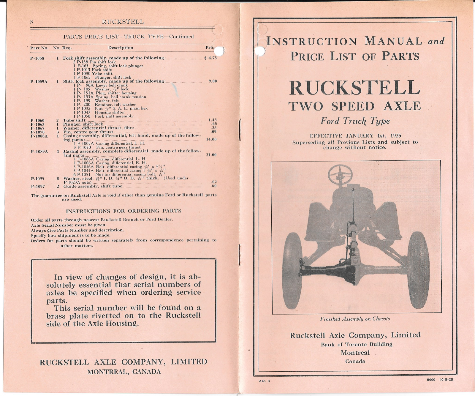

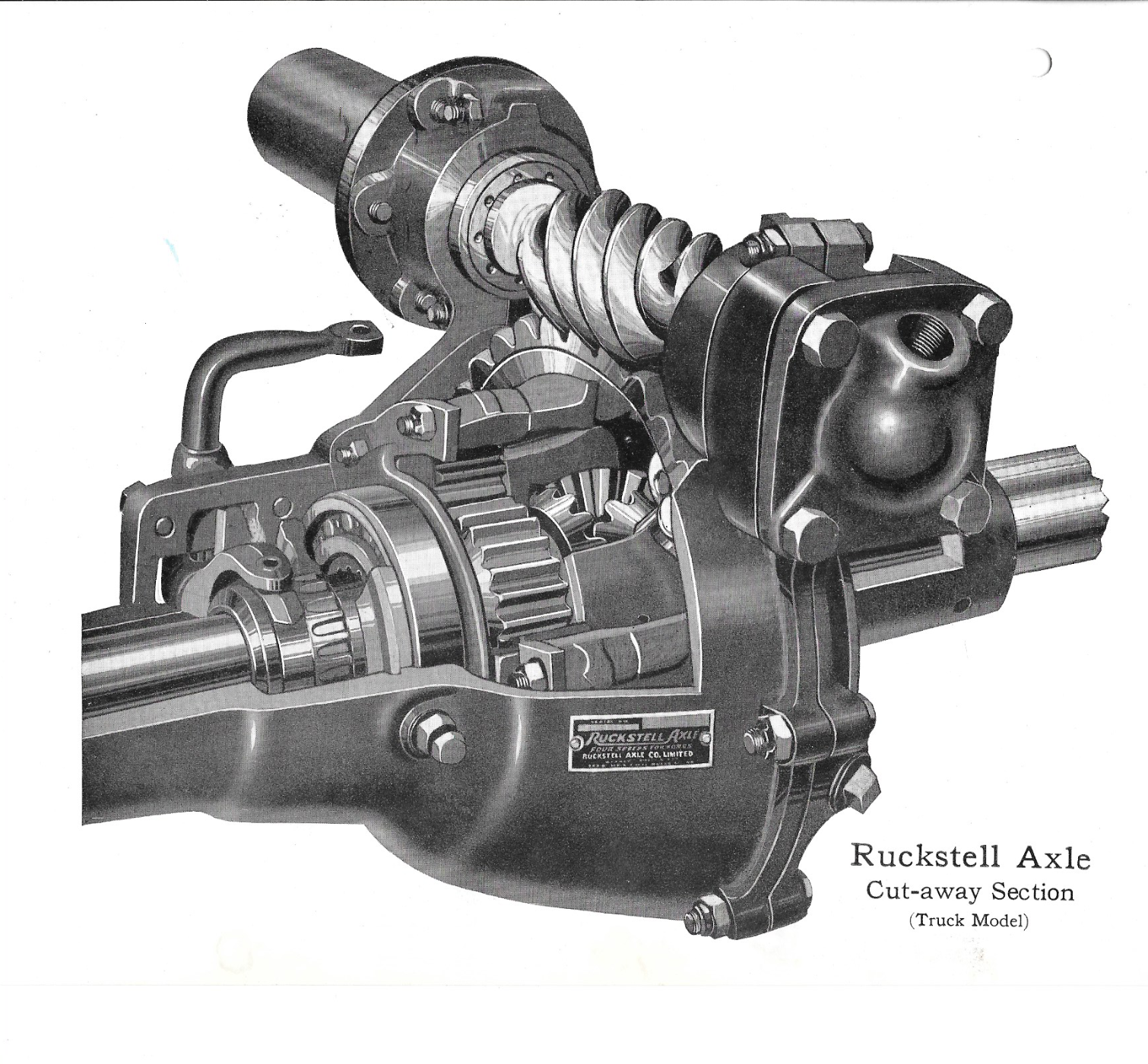

A cutaway view of two speed Ruckstell truck type, dated January 25, 1925. Instruction manual and parts list. Montreal Canada.
