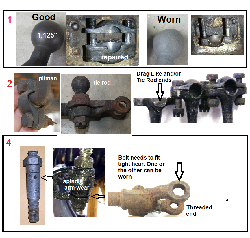

Here is a diagram referencing steering part names
Just some pictures to help visualize/understand what wear looks like. Basically all the ball/socket combinations share the same wear issues, worn ball or socket caused by lack of grease. The tie rod bolt wear either in the bolt and/or the yoke
Arrows point to wear zones

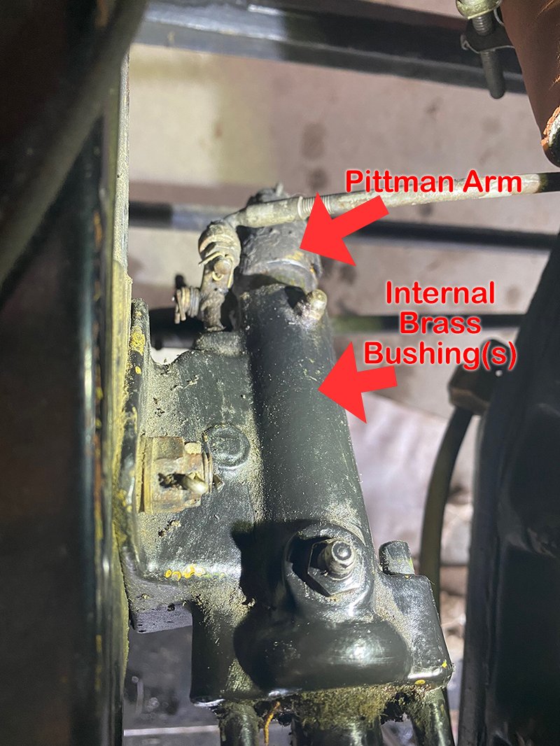

Another area where you'll get slop in the steering is found in the bracket at the bottom of the steering shaft. There are one or two bushings in the casting that get worn and allow the shaft some movement that impacts the sloppiness of the steering. We replaced the bushings in a friends car and it really tightened up the steering in his case.
Others have pointed out that worn bushings or balls anywhere in the front end will contribute to steering issues. To repair some of them requires special tools, another reasons to connect with a club or individuals in your area.
Lower steering shaft bracket

Post by Steve Jelf » Thu Jan 16, 2025 3:40 pm
Tim, what's that odd-looking thing between the arrows? :D
Posts: 2550
Last Name: Strange
Location: Hillsboro, MO
Re: Some general questions
Post by CudaMan » Thu Jan 16, 2025 5:57 pm
To me, it looks like an additional grease zerk to lube the lower bearing of the steering shaft support.
Posts: 5625
Post by RajoRacer » Thu Jan 16, 2025 7:55 pm
To which I consider a valuable install !
