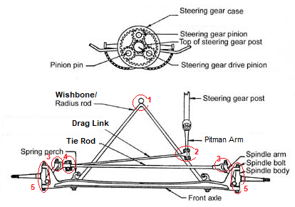

Here is a diagram referencing steering part namesLittleTimmy52 wrote: ↑Tue Jan 14, 2025 8:33 amI have a wide variety of questions, from steering to something electrical, to missing parts, to operation. I will start with steering, my gears are actually fine, the steering is fine, there is just one linkage looking thing that has all the play in my steering system, its this part where the column rotates a bar which moves the other bars that turn the wheels, the part where the first bar on the column connects to the other bars has the slop, and apart from replacing this part, is there any fix, or is it a remove and replace?

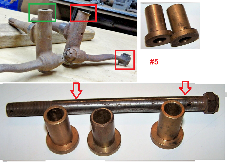

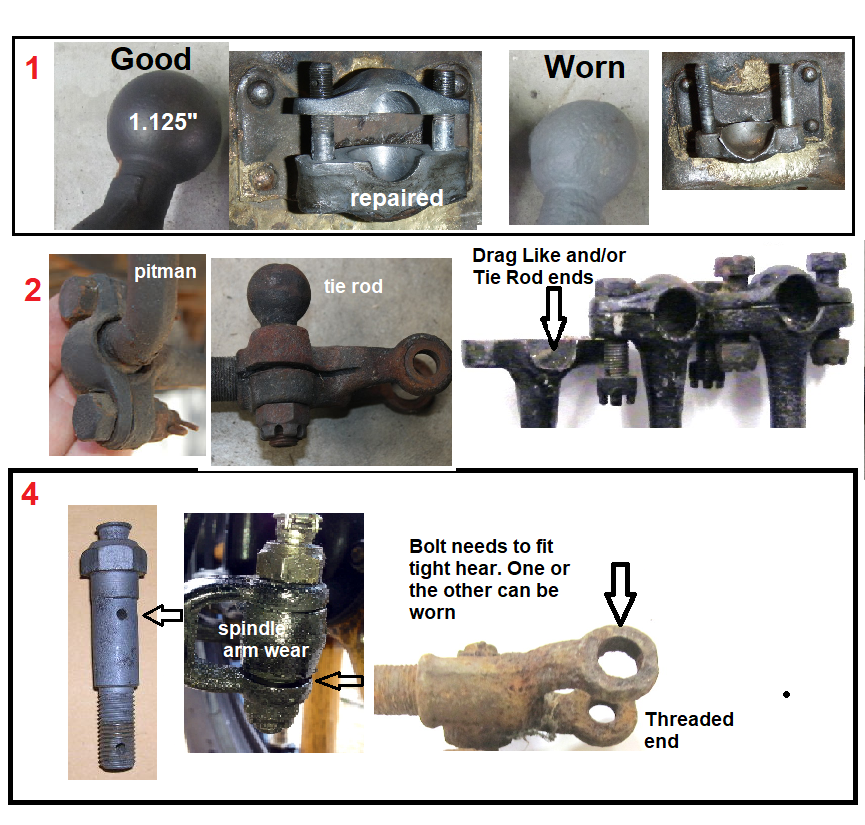

Just some pictures to help visualize/understand what wear looks like. Basically all the ball/socket combinations share the same wear issues, worn ball or socket caused by lack of grease. The tie rod bolt wear either in the bolt and/or the yoke
Arrows point to wear zones

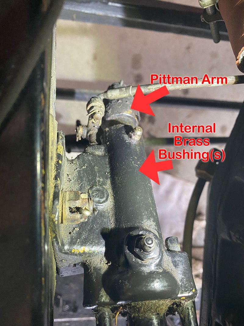

And check the bushing in the frame bracket that supports the end of the "steering gear post" near the pitman arm. jb

I agree - post individual questions with photos. Use available literature to try to learn the correct names for parts because otherwise we are left guessing.
Another area where you'll get slop in the steering is found in the bracket at the bottom of the steering shaft. There are one or two bushings in the casting that get worn and allow the shaft some movement that impacts the sloppiness of the steering. We replaced the bushings in a friends car and it really tightened up the steering in his case.
Others have pointed out that worn bushings or balls anywhere in the front end will contribute to steering issues. To repair some of them requires special tools, another reasons to connect with a club or individuals in your area.
Lower steering shaft bracket

Tim, what's that odd-looking thing between the arrows?
- Posts: 2549
- Last Name: Strange
- Location: Hillsboro, MO
- Board Member Since: 2013
Re: Some general questions
To me, it looks like an additional grease zerk to lube the lower bearing of the steering shaft support.
- Posts: 5591
To which I consider a valuable install !
