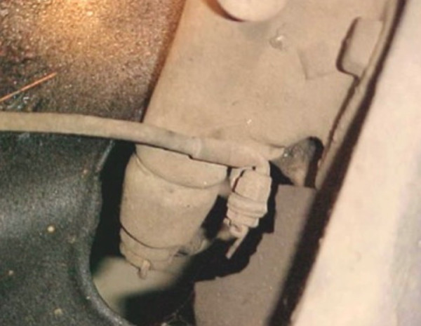

https://jmp.sh/s/ir06Grbdmiy1DaDIjL31
Here is my spark lever, somebody tell me if that's normal or if it needs to be changed. it's a 17 I don't know if that means anything because I know some things have changed between the years I'm not sure if this is one of them. Typically I have it all the way up for starting and then as it warms up I advance it until that big notch and basically leave it there, I do as of recent play with the advance while driving with slight engine improvement (well by ear). Is leaving it advanced most of the time fine?

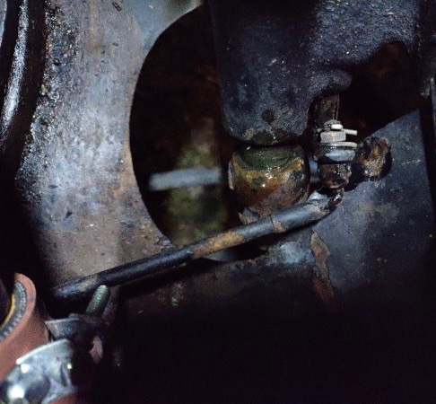

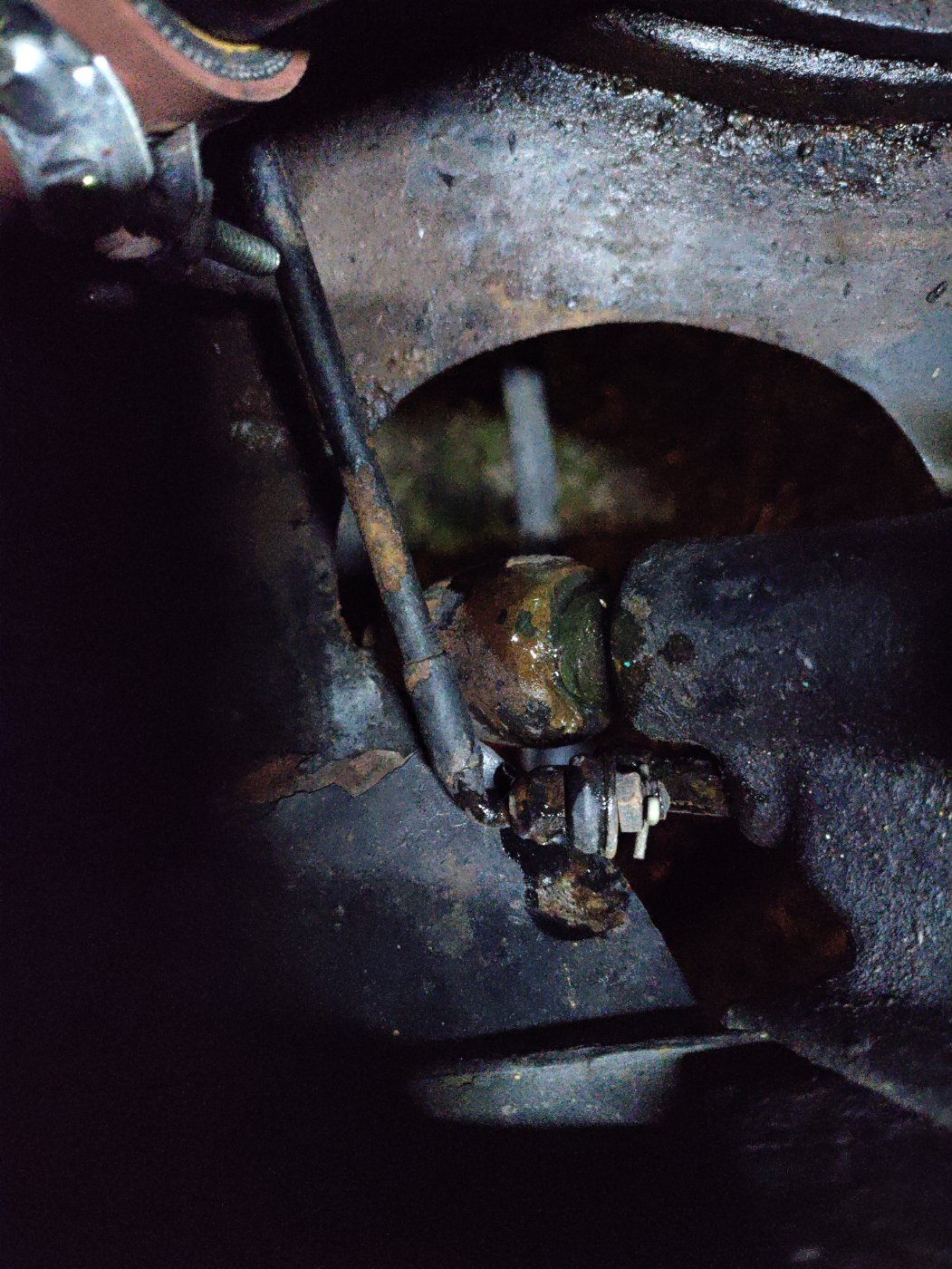

I know precisely why now it only goes to this big notch before springing back the part that physically moves is hitting the metal sheet now I don't know if it's supposed to be like that or not but if somebody wants to look at the video and look at this attached image and tell me I would greatly appreciate it. Thanks
As you can see the oil spot below is where it hits that's why it springs right back up and it doesn't go very far
- Posts: 4042
Re: driving questions
Your hand lever is a mechanical linkage to the timer rod from the tiny lever on end of the hand lever to the timer case.
The timer rod sets the range of travel and of course the range of retard and advance. Yours appears to be unable to provide full moment. Issues could be poorly bent timer rod or the rod impinging on radiator hose or something on its travel to the timer case.
- Posts: 4622
Open the hood and lean over a bit so you can see if the timer advance rod is moving freely. If it’s hanging up somewhere you should be able to see it as you lean over, move the spark lever and watch it closely.
If it looks like it’s hitting or dragging on something remove the rod from the top of the timer case arm. It should come out easy.
If not and it seems like it’s in a bind when you take it out that’s probably your issue and the rod needs reshaping so it doesn’t drag or hit something.

As per my poorly taken photo it is indeed hitting something which is that metal shielding or whatever it is between the frame and the engine it looks to me that either the shielding is wrong or the whole steering column and everything is shifted as the whole column is to one side of this shape cut out of it and as you can see it is hitting this metal shield, so I don't know what to do from there. It moves fine really until the little linkage looking thing hits the metal shielding.John kuehn wrote: ↑Thu Jan 16, 2025 9:43 pmOpen the hood and lean over a bit so you can see if the timer advance rod is moving freely. If it’s hanging up somewhere you should be able to see it as you lean over, move the spark lever and watch it closely.

The shield is the splash pan and its probably right. The timing rod on my car has alot of bends in it to clear everything in its way. It was done right, unlike my throttle rod that was hanging up inside the block.
If you have to bend a fresh rod or alter an existing one, I would first detatch the rod on the timer end and move the timer so that no. 1 cylinder sparks at top dead center when the piston reaches top dead center on the compression stroke. You can tell by disconnecting all four plug wires, pulling no. 1 spark plug and slowly cranking it over and looking for when both valves are closed and the piston approaches the top of its travel. At that moment turn the timer until the plug sparks with the ignition on. Set the spark lever all of the way up. Now the rod should fit between both the timer and the steering lever holes. Bend a lighter gage wire such as a piece of rebar wrapping wire around the obstacles and use it as a baseline for bending the real rod.

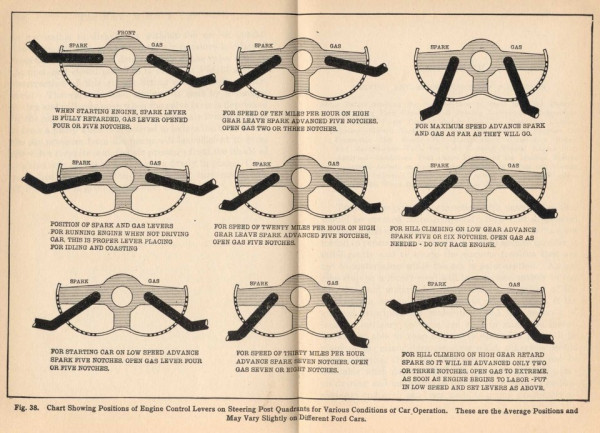

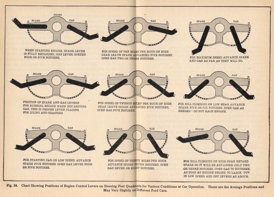

Here is an old Model T era chart, that, for the most part, gives a general understanding of the lever settings for driving the Model T. Some say it is not accurate, but it has helped me.

I know precisely why now it only goes to this big notch before springing back the part that physically moves is hitting the metal sheet now I don't know if it's supposed to be like that or not.
Here is the comparison of factory placement of the swivel end timer rod used to 1920 or so.
The rod on your T is mounted incorrect, so the swivel is causing interference in the travel or the rod. Plus it seems that rod is way forward under the hose, should be more in a line to the timer case with the rod being under the metal return coolant pipe.
The chart is from Murray Fahnestock's book. I believe it's for driving on BAT, and doesn't apply to MAG. It shows too many timing positions for MAG driving.

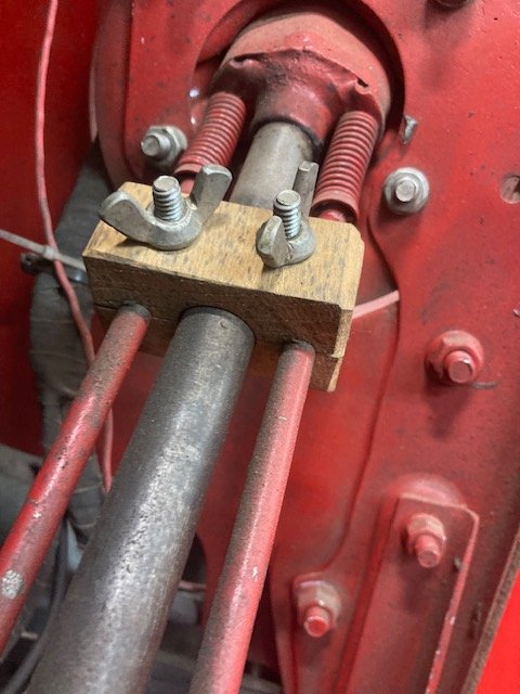

Hi Lucas,
Levers that will not stay in place can be cured with a lever brake. Easy to make, I use a hard wood, drill the steering shaft hole larger than the
shaft & the lever hole smaller than the rods. Drill the bolt holes & then cut in half with a band or hack saw. I like the wing nuts because you
don't need a wrench to make quick adjustments. As fare as timing adjustments go slow engine speed less timing, fast engine speed more timing.
The same with fuel more load more fuel, less load less fuel. Craig.
