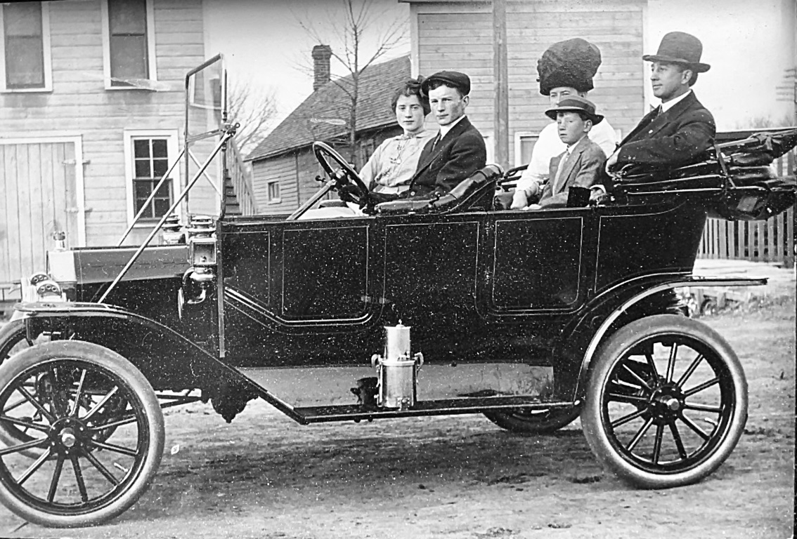

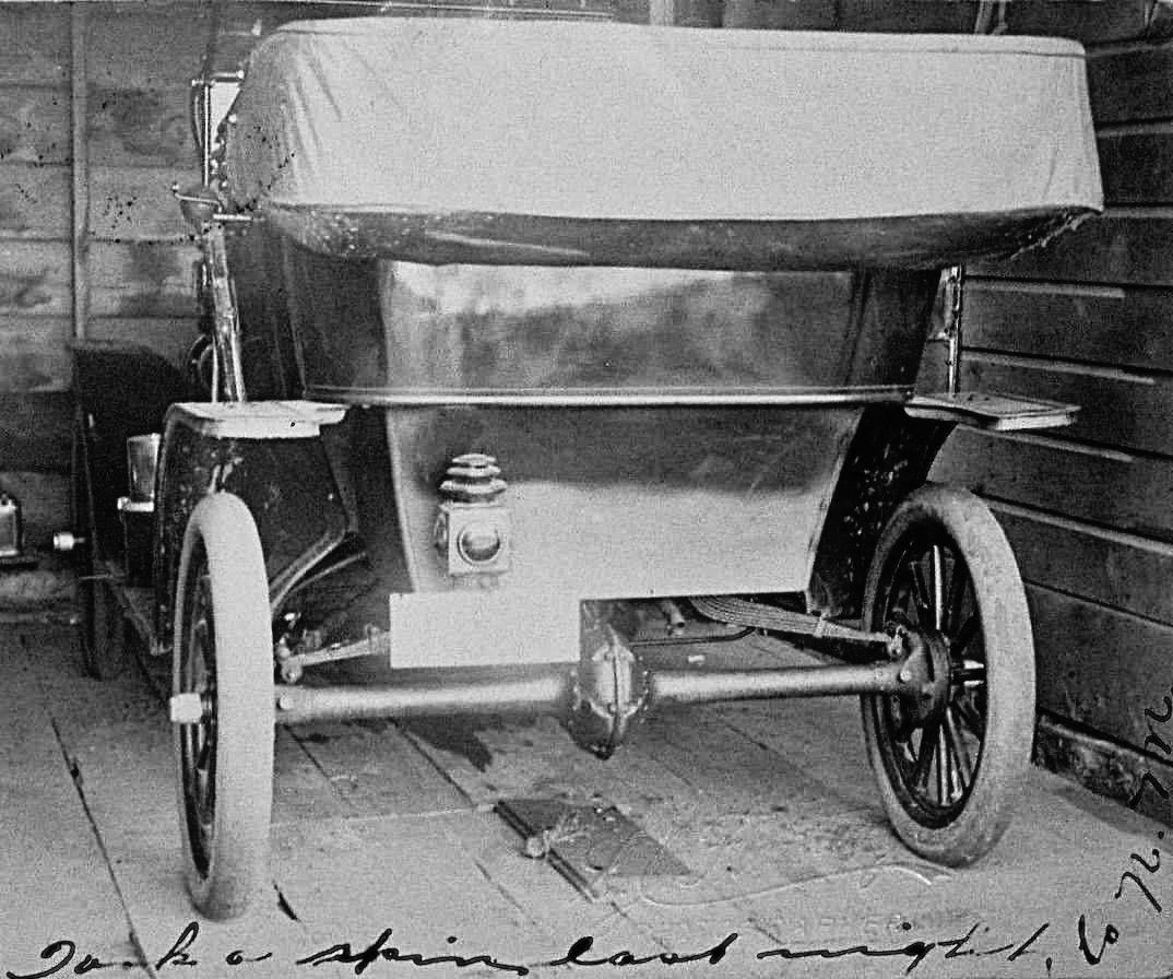

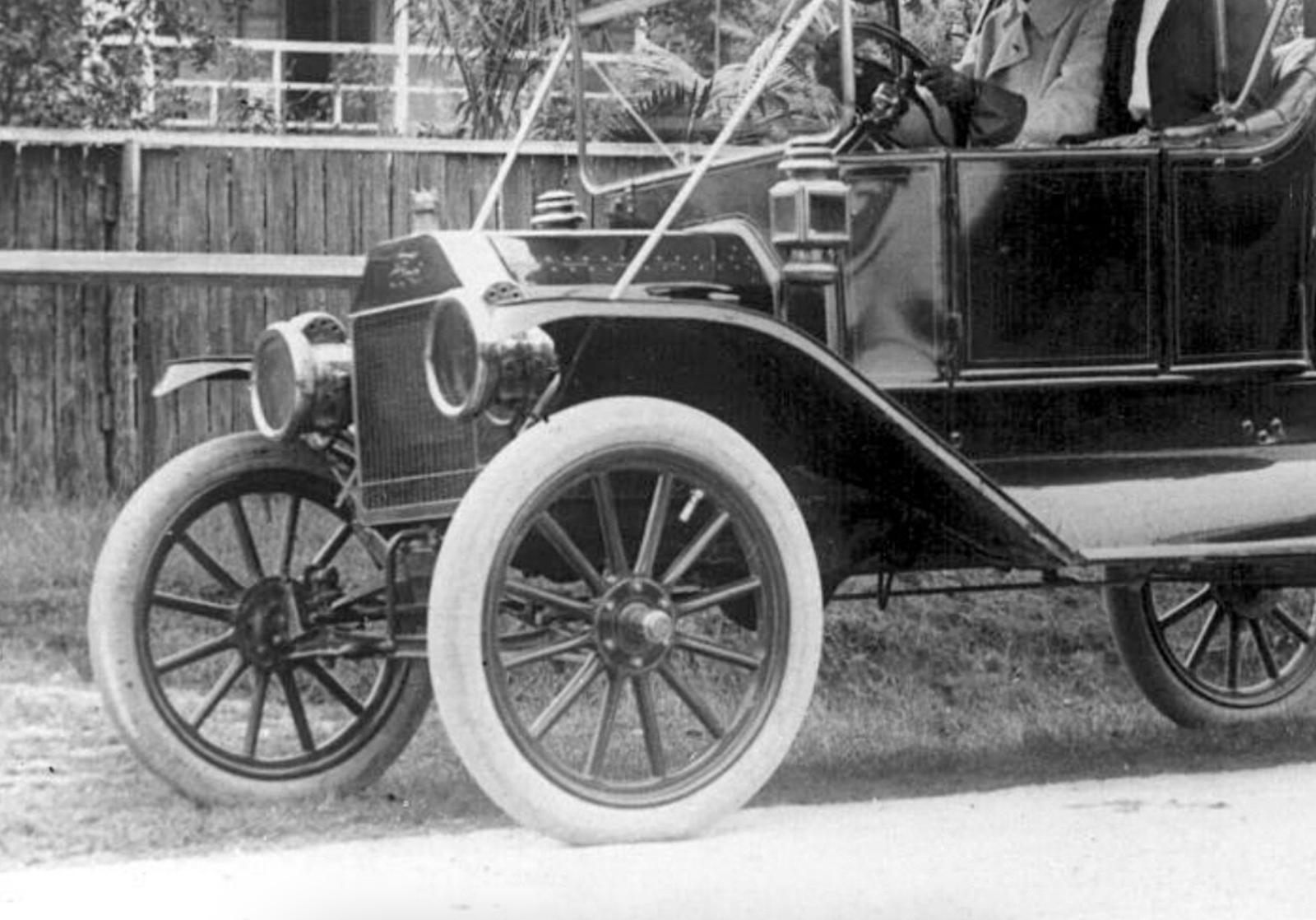

Gloss black.
The photos above are a great reference for pinstriping.
Note there are no "boxes" on the hood and no pinstripe on the back below the the seat platform.

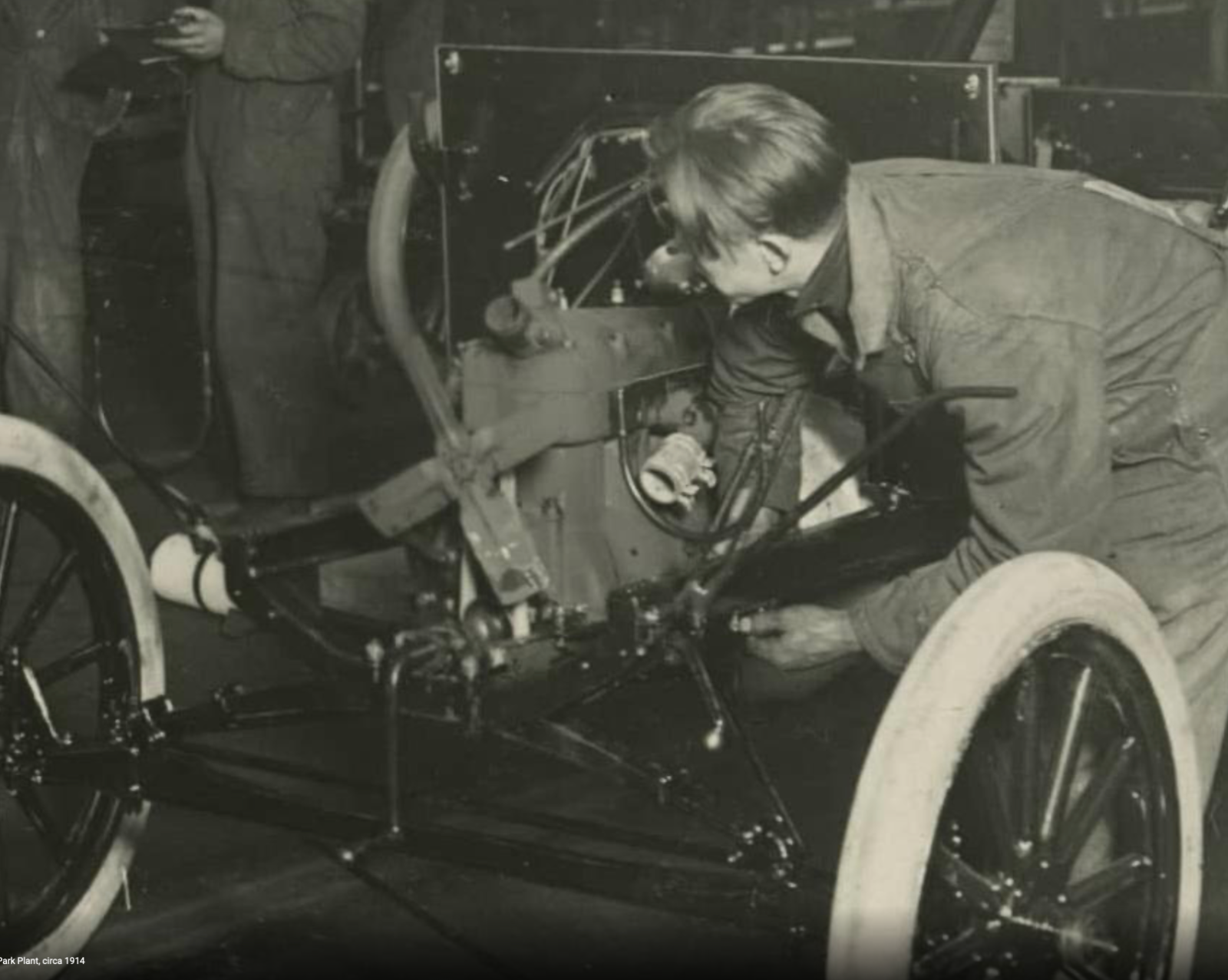

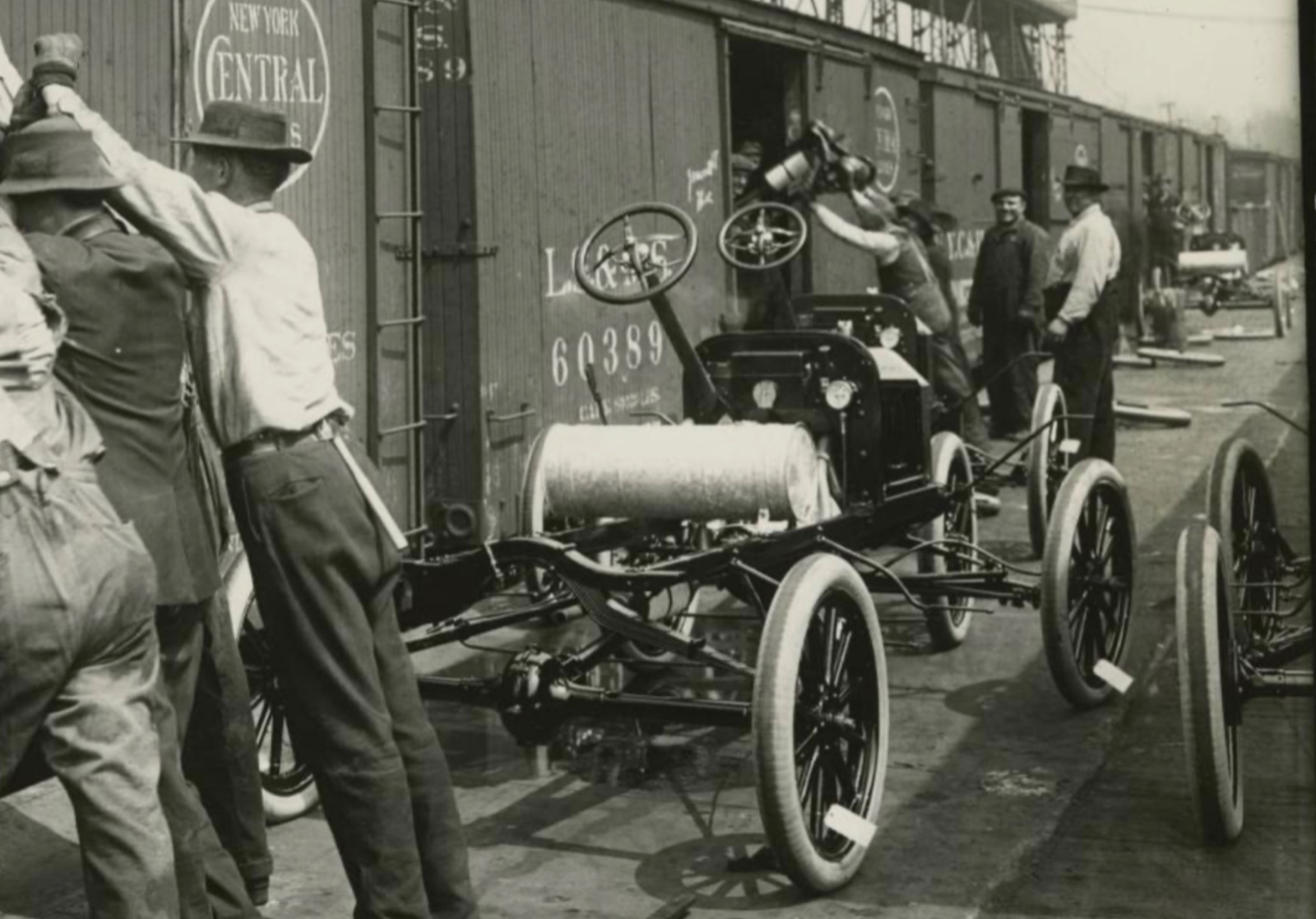

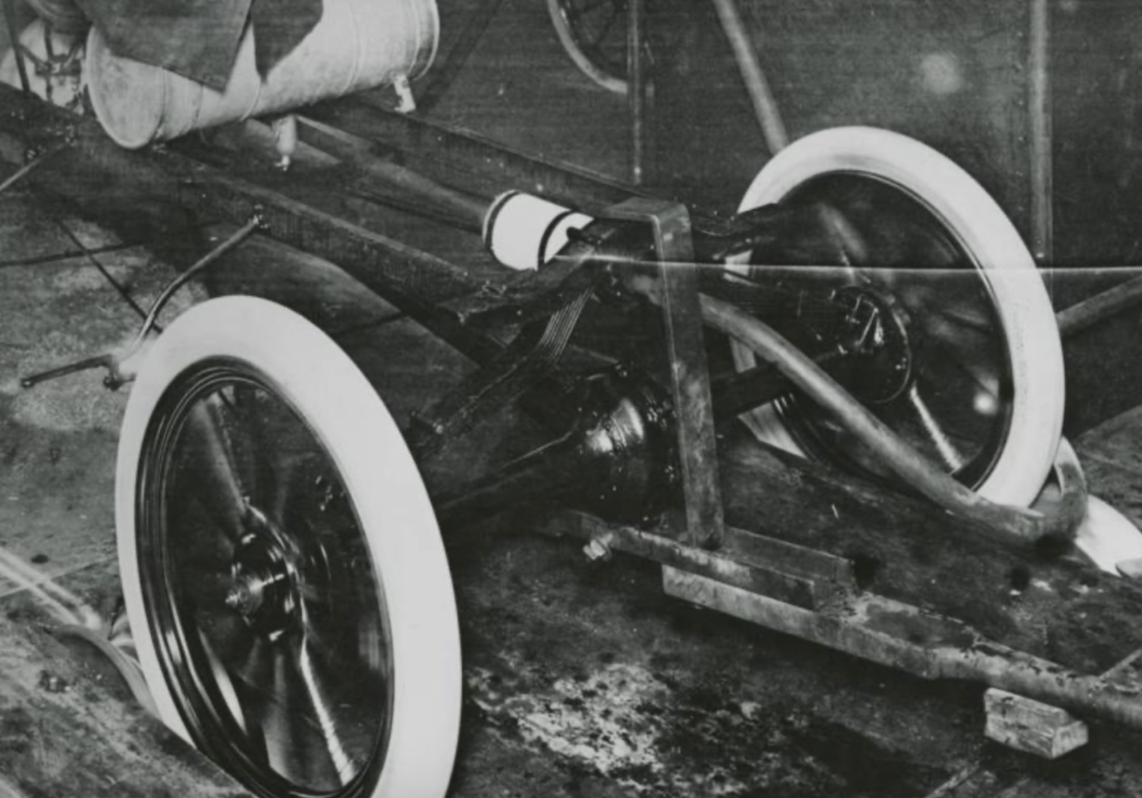

Not many pure 1912 chassis photos around unfortunately. Here are a few 1913-1915 examples. Definitely glossy.

Keith, I think I can make out a box pinstripping on the rear seat bottom. It's looks faint but there? It does appear to have a break where the lower rear seat hinge is though? Pretty clear that the hood is not boxed on the top section.
