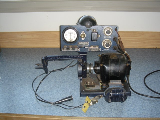

The article above can also be useful when testing the generator on a dynamic as shown below.
Ron Patterson

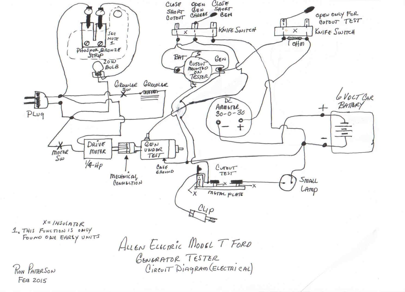

Re: Generator - 1927 versus 1928
Now you all have a electrical schemetic of the Allen Electrric generator tester.
Go for it an make one.

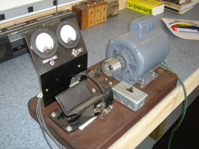

Here is a photo of one I built copying the Allen Electric design.....................
If anyone has questions about it I have many other photos of the mechanical details.
Ron Patterson

Ron Patterson
Tom
If you are planning to build a generator test stand, I suggest you use a trouble free diode type "cutout"
Relay type generator cutouts are nothing but trouble you don't need.
Ron Patterson
