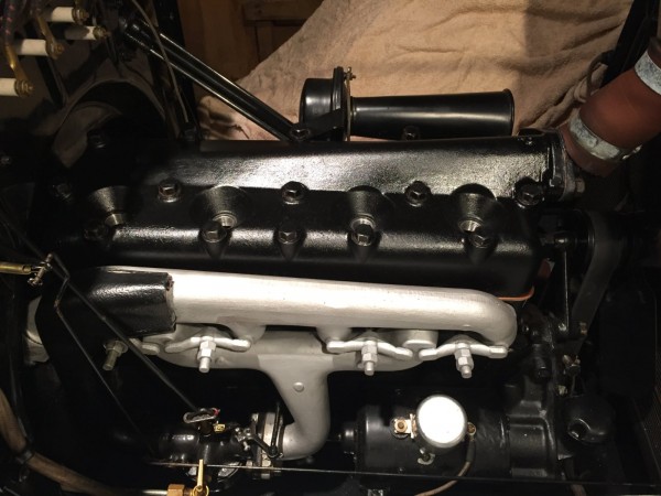

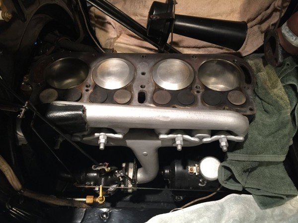

Got it done today without a hitch, and will run it tomorrow. Had the head off about 600 miles ago to replace the valves and add adjustable lifters and it looks like everything is working pretty well inside.

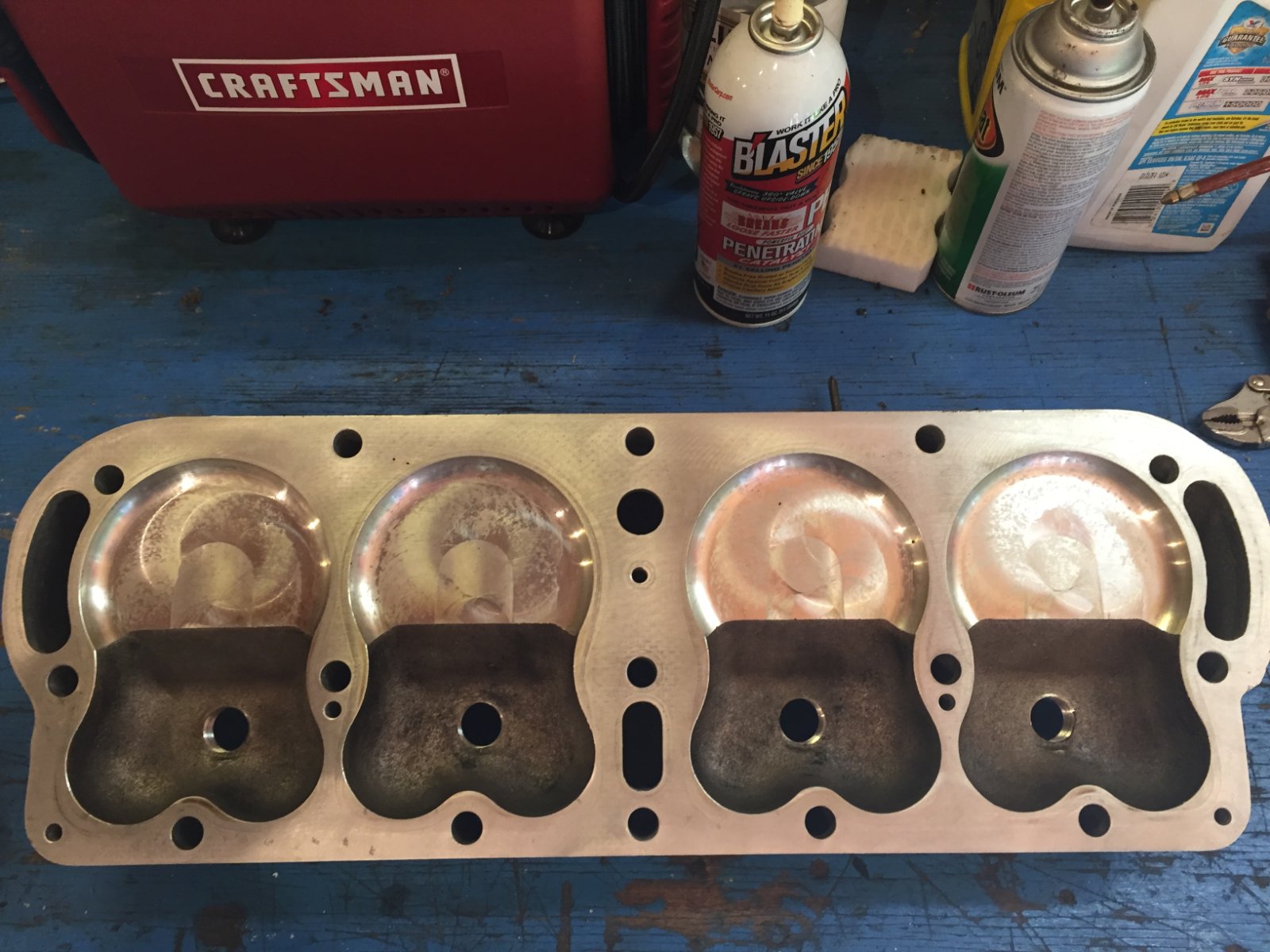

Not advice but a comment on the head design: The combustion chamber has a squish area above the piston which creates a lot of turbulence during ignition. This speeds up the burning of the air/fuel so less spark advance is needed. It also increases the efficiency of combustion which leads to more power.
