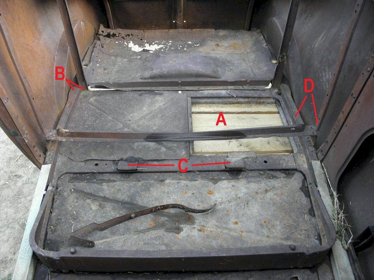

Found an early '26 coupe trunk floor pan.
A) There were three different wood battery covers and this example has the earliest wood.
B) The "C" pillar is early, like this one, if the foot rests on the floor, while newer one rest on the rail on the outer edge.
C) Early '26 coupes have two rear seat rests while later ones have one central seat rest.
D) The early side window brackets connect down to the seat back support, while later ones land straight down instead.

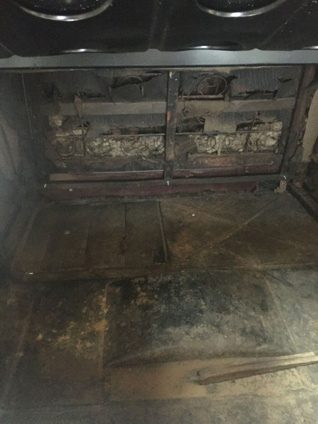

Here is a picture that I found of the trunk floor of my 26 Coupe with a build date of 5/6/1926. I can get a better picture if need be.

Re: 1926-27 Coupe Floor Pan Differences
Thanks to both of you for the pictures.
