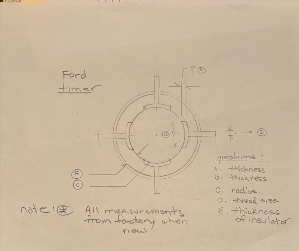

Don’t have timer available. Could someone answer questions in photo? FYI: am going to make insulator and the 4 contacts.[/size]

Don't forget to make the insulators for the threaded posts going through the commutator metal housing.

Some thoughts. I made the race ring from delrin and cut the contacts moon shaped. Easier to cut the contacts from a bar and the ring to imbed the contacts. Connected the contacts and terminals by threads. I got the dimensions by measuring an NOS timer.
Good luck.

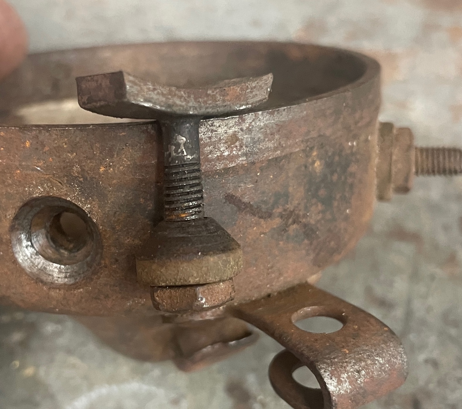

Dimension approx. from a used Ford pressed steel roller timer.
A. contact thickness 0.120"
B. contact length 0.800" contact width 0.400"
C. contact radius ?
D. thread 10-32NF (overall contact + thread length .900")
E. thickness insulator 0.335"
other: contact conical insulator thickness 0.265"
C. contact radius ?

Re: Ford timer
Steve:
The timer Dan posted is the one I want to build new internals.
Dan: I was thinking I could use a 3” pipe and mill segments out of it. However, my timer case is at different location. The radius I could (pipe) use could be 2-1/2” or whatever. I don’t have the old segments handy.

Dan:
The posted measurements are they from the posted pictures? If not where did they come from?
Thanks,
John.
Thanks,
John.
- Posts: 4104
Re: Ford timer

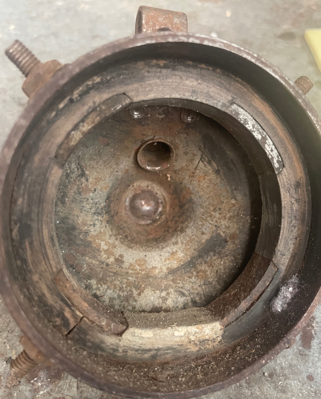

Those measures were made from my used Ford timer in the pictures . Used digital calipers on the parts shown.
- Posts: 7309
Re: Ford timer
The steel in pipes is rather soft. The steel in drawn tubing is likely harder and more consistent. The steel in timer contacts may well be something different again. It would be a shame to start the project with materials which are not up to the demands of the application. Time spent working this out may be time well spent.
Can anyone show some light on the subject?

Dan:
Exact measurements taken? Timers wear at different rates. What would you say is the wear factor in your timer internals? I’m trying to build one as if it were brand new. Would a loss of 10%, 20% etc … be a good value of your photo attached?
Not that I am anal about it. I am curious as to the measurements when new and figured if the measurements were available I would build one that way.
- Posts: 4487
Re: Ford timer
Really, rather than asking for insulator thickness and contact radius, knowing the inside diameter of the contact ring would be more helpful, I believe. That's ultimately the dimension you want to control.

Re: Ford timer
Jerry: exactly, when new! Have any idea what the value would be? However, values requested would be needed to complete project.

Re: Ford timer
Addendum: You may/ may not know when you install just the insulation ring, pressing it in there is a lip you need to navigate, slight as it is, that value needs to be accounted for.

The goal is! I have a worn out ford timer for my 26 coupe in which I want to rebuild, as I have the equipment to do so. That’s it!
I don’t want an aftermarket timer.
It was of my opinion someone in this community must have persued this project at one time and could have supplied answers. Although, I have received great suggestions. I am only a simple man trying to solve a simple problem.
As far as Ron’s suggestion. His solution is spot on if I were to start manufacturing the part. I am well aware of the costs associated with obtaining ford diagrams, as I have attempted it in the past.
Again, alls I want is to fix my car and not trying to start a manufacturing process. It’s a hobby not a career.

Re: Ford timer
As Jerry states, you should be concerned about the diameter. Well, anyone have a new aftermarket timer who is willing to take a measurement?
