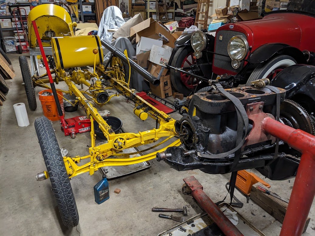

For what it's worth, no one drive their model T more or as hard as I do. A recent engine problem on our return trip from Canada caused me to have to disassemble the engine in old #4. Broke a connecting rod. Last time new rings were installed was 25+ years ago and they were Grant rings. On disassembly, as I examined the parts I was really impressed with the condition of everything and the wear showing. If I listened to everyone's advice I'd have put new Hasting rings in during my re assembly, but those old Grant rings were part of my amassment and so that' what went back in old #4
Ed
