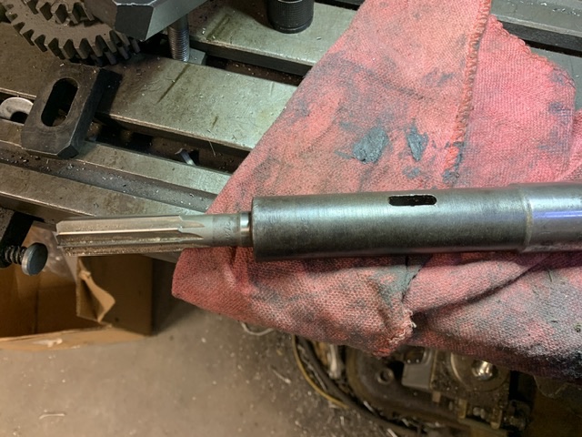

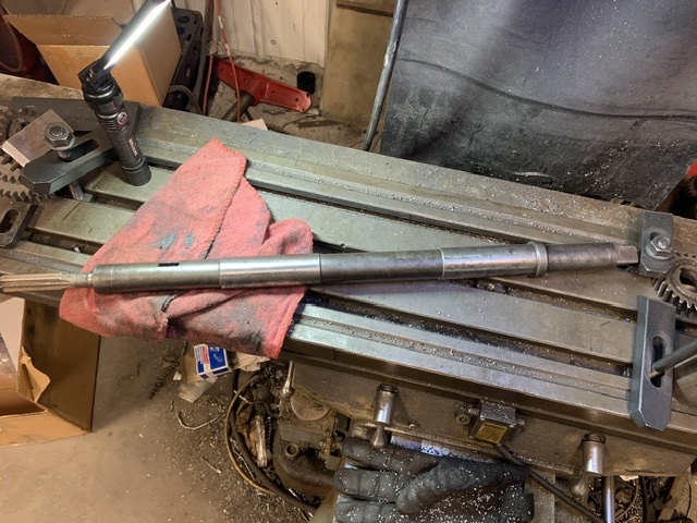

Anyone else got one of these? I am looking for a new reamer for it. Number 2 MT 3/4” Short reamer. May see about making some if there is a market. Email me at address in pictures. Thanks Dan

Dan I have two of these tools. One has the right reamer, the other came without it . I purchased the right reamer fot it on eBay but it was too long. I was going to have it gound down to the right length but never got around to it.
Im thinking it shouldnt be hard to replicate what I did. Imho they are a valuable tool. Both mine index off the cam bearing holes in the block. Another manufacturer Stevens, I believe, indexes off the bored holes in the cam bearings.

Dan,
I had one with a worn reamer.
I could not find a MT2 replacement reamer.
I bought a regular reamer (3/4" I think).
I used a standard MT2 dead center and faced off the point.
I drilled and machined an interference hole in the MT2 center and pressed in the reamer.
I don't remember if I had to turn down the shank on the reamer.
Works fine.

If I'm not mistaken, that would be an end cutting reamer. Any other reamer will simply follow the existing hole and not be of much use to line ream with. The end cutting nature of this reamer will help to cut its own path, correcting for any misalignment.
My thought would be to get a standard reamer, cut it to the length you need, then take it to a cutter grinding shop and have the end sharpened appropriately.

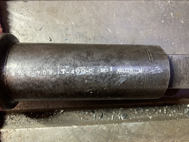

Allan: If you blow up my last picture and look at the number check the number.
It is a 27-Z number. Also there is a T 400 number. Don’t know if this a ford tool but it has a z number. Dan

Many of the original tools for this use a shell reamer head on a arbor that pilots on the front and center cam bores. MSC lists an "economy" 3/4" shell reamer for around $45.00. This way, no need to modify the shank on a chucking reamer and you can make the arbor larger diameter right up to the shell reamer to keep things much more rigid. A properly ground reamer cuts using the chamfered end of the flutes, not the OD of the reamer, so its important to make the arbor as stiff as possible.

I had noticed the numbers on your tool Dan, and the Z number means it likely is a Ford workshop tool. I just wondered if a new cast bush in a newly machined block would require aligned reaming. It seems counter-intuitve to add the operation to the engine build. It is not as if there is a great load on the bush, nor great speed in the rotating camshaft.
