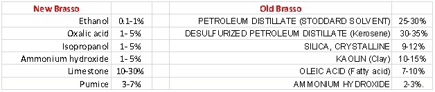

When I was in the army sixty years ago Brasso was the go-to we all used. No more. The stuff bearing that name today is NOT the same, and there are several polishes I consider MUCH better. I use Mothers because it is ubiquitous, easier than most, and inexpensive. I have tried most of the others that turn up in these discussions, and found there may be a few that are slightly better in some minor way, but lack one or two of the qualities I mentioned.

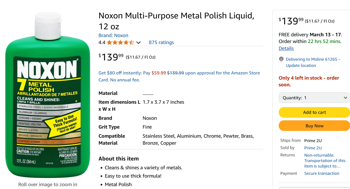

I inherited a bottle of Noxon 7 Metal Polish when I bought my house years ago. It's good stuff and I use for certain things. Unfortunately, it was discontinued a few years ago. I go to a lot of estate sales and that's where I pick up a lot of "sundries" like mineral spirits/paint thinner, WD-40, denatured alcohol, motor oil, 2-cycle oil, Brasso, etc. for cheap. If I ever come across a bottle of Noxon, I'll be sure to pick it up.

We didn’t test brasso. Like Steve, I used gallons of brasso during my time in the Marines. The new stuff isn’t the same.
I also use Noxon for initial cleaning of highly tarnished brass. It’s discontinued. I have used barkeeper’s friend, but the follow up is more work to get out the minute scratching. When the Noxon is gone I’ll probably fallback on the vinegar/salt/flour mix for the heavy tarnish. What worries me is Salt and Vinegar removes tarnish and kills weeds, but it also my favorite potato chip flavor.
I haven’t tried it but I would assume properly applied wax would help, but don’t let anyone talk you into lacquer.

Wasn't familiar with NOXON so I did a some web surfing
https://www.rbnainfo.com/product.php?productLineId=435
Ingredients
Water
Diluent: Adjusts the concentration of ingredients in a product to deliver target benefits.
CAS #: 7732-18-5
Calcium Carbonate
pH Adjuster: Controls the pH level of a product to ensure stability and maximize performance.
CAS #: 1317-65-3
Oxalic Acid Dihydrate
CAS #: 6153-56-6
Pumice
Polish Ingredient: Imparts shine or gloss to a surface.
CAS #: 1332-09-8
Tall Oil
CAS #: 61790-12-3
Isopropyl Alcohol
Solvent: Solubilizes or dissolves at least one other substance to form a solution.
CAS #: 67-63-0
This ingredient appears on one or more Designated Lists:
CA Non-Cancer Hazards Chemicals that are identified with noncancer endpoints and listed with an inhalation or oral reference exposure level by the Office of Environmental Health Hazard Assessment pursuant to paragraph (2) of subdivision (b) of Section 44360. more info…
Ammonium Hydroxide
CAS #: 1336-21-6
AOEC Asthmagens Chemicals designated as asthmagens by the Association of Occupational and Environmental Clinics. more info…
Aluminum Magnesium Silicate
Thickener: Enhances the structure of a product.
CAS #: 1327-43-1
C13-14 Isoparaffin (Aromatic Mineral Spirits)
CAS #: 64742-47-8
Still available

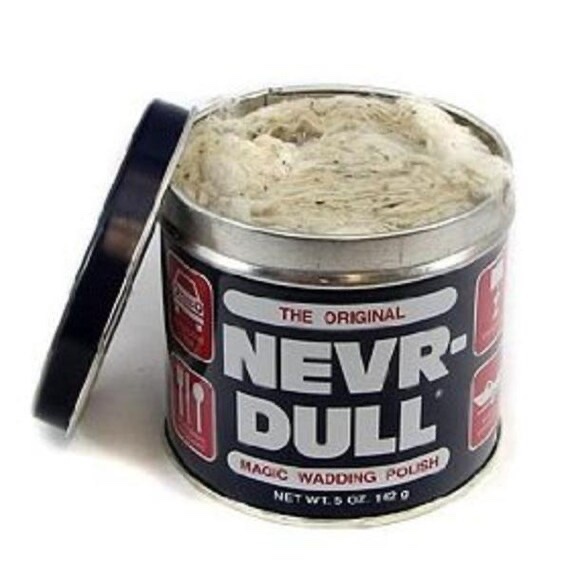

Nevr-Dull ingredients
Nevr-Dull polish is made of cotton wadding that's soaked in a solution that contains mineral spirits, aluminum oxide, calcium carbonate, and other ingredients

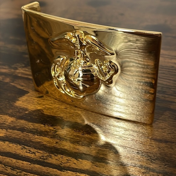

In the Marines, for a few extra dollars, we could buy anodized brass buckles, brass tie clasp and brass uniform buttons. Like Baldwin door knobs, the brightwork was very brightly polished and never needed to be polished. I wonder how difficult and expensive it would be to get Model T brass work anodized and who does it.
