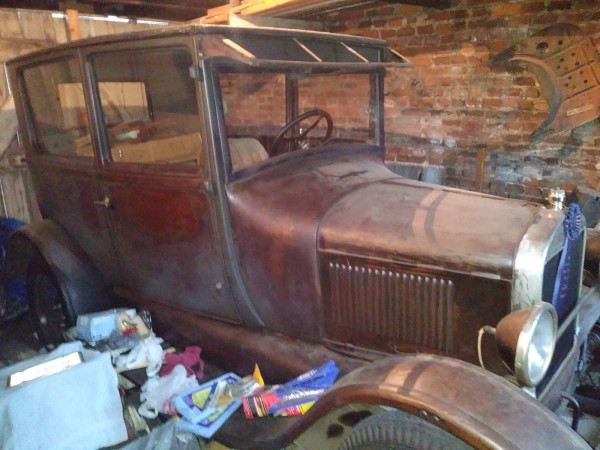

Post by JohnM » Sun Mar 16, 2025 8:11 am
Yes, my unrestored 27 Tudor sedan had body color beltline with pin stripes and black windshield frame. But, that is not necessarily evidence they ALL came that way.

Re: 26-27 Paint Questions
Post by jab35 » Sun Mar 16, 2025 11:05 am
John: Beautiful photo, reminds me of a Richard Eagle (RIP) painting.
Windshield frame and interior window trim were all black based on everything I've read, jb

Board Member Since: 2010
Post by JohnM » Sun Mar 16, 2025 7:36 pm
You are very kind James, Rich did have an eye for the colors of oxidized steel. :)
