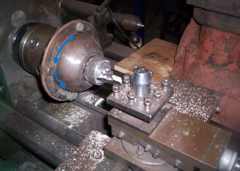

Going to re Babbitt the fourth main soon.
When it goes time to line bore to size , I will be using my lathe, which surface on the ball do I use to indicate off ?

Post by speedytinc » Mon Mar 17, 2025 12:26 pm
The machined edge under the mounting flange. This is where it contacts/centers itself in the motor.

Post by Mark Gregush » Mon Mar 17, 2025 2:58 pm
Where the flange meets the ball part, there is a machined surface, that is where you center off.

Post by Kerry » Mon Mar 17, 2025 9:24 pm
I made use of a T wheel hub flange plate as a face plate for the lathe years ago, still using it, centre the ball cap at the machined surface near the ball cap flange.
