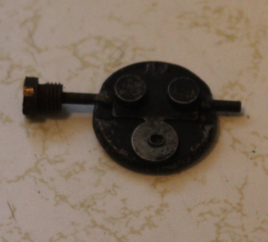

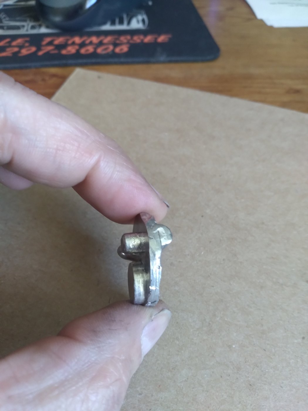

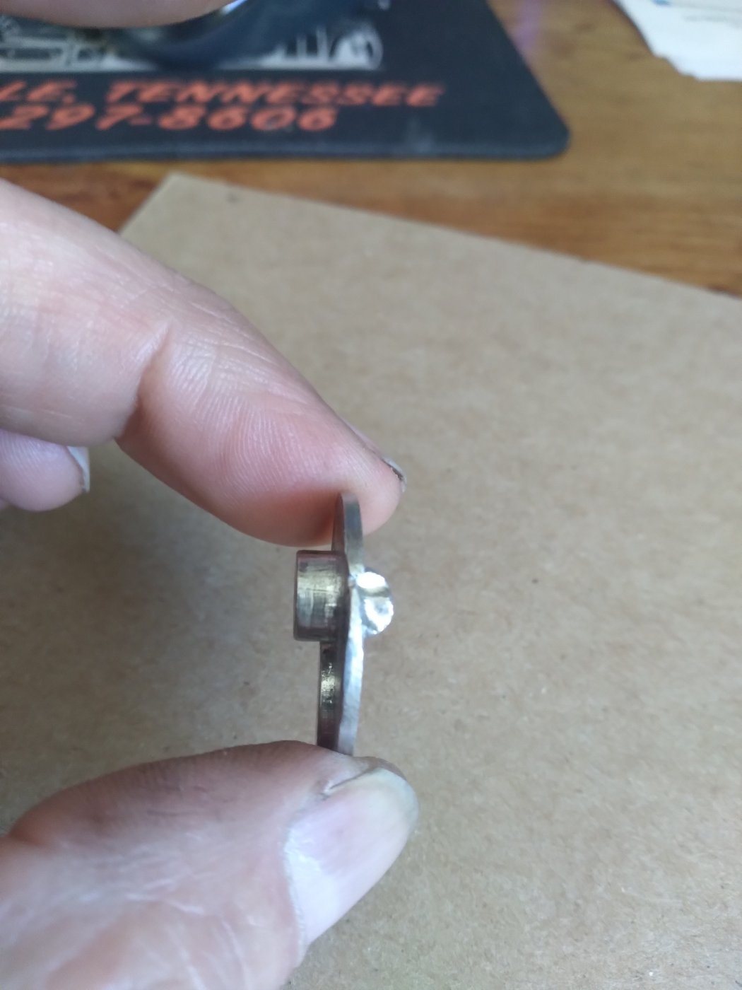

It's been 11 years ago that posted looking for information to identify a carburetor. Turned out to be a Wizard or Simmons, no markings on it.
https://www.mtfca.com/discus/messages/4 ... 1401892072
Since then that carburetor has been sitting on the shelf collecting dust. I'm now retired and thought I would take a shot at bringing it back to life.

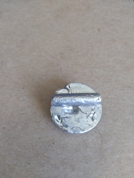

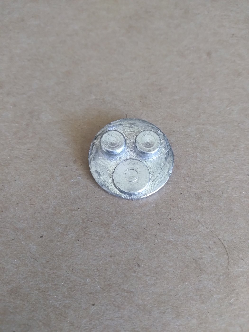

The two things needed for it are the flapper and the main jet screw or spray nozzle. I decided to start with making a mold and pour a flapper, since I don't know of anyone making and selling flappers. I've been working from pictures and a drawing of flappers that I found on the forum. I made my mold based off of the drawing, the one dimension missing from the drawing is the thickness of the flapper body. I'm wondering if someone that has one could measure it and post that dimension. Also, any additional information would be greatly appreciated.
Roger
Roger

How does the weight of your new casting compare to the weight of the original?

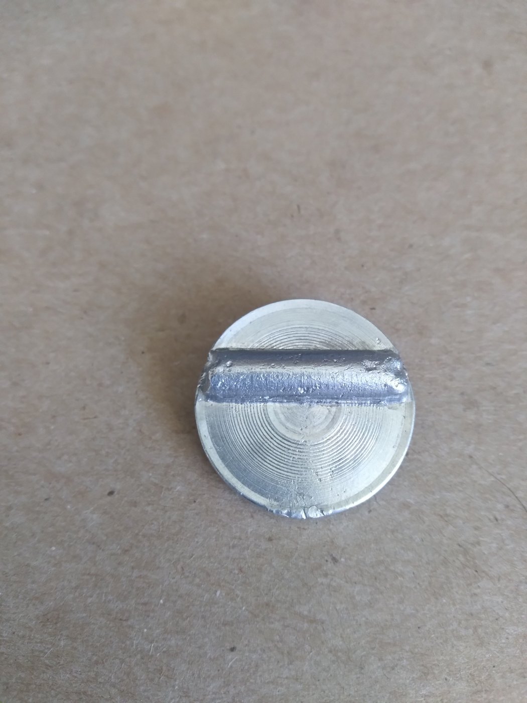

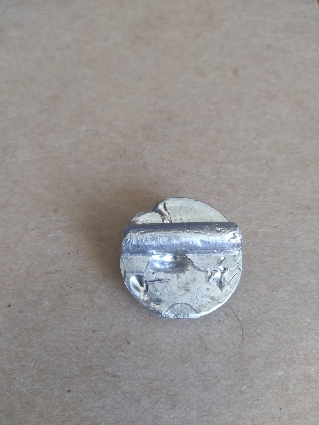

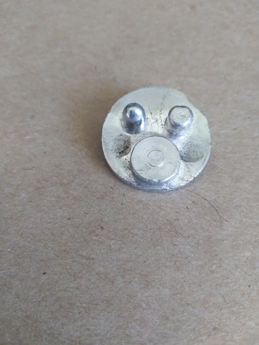

Joseph, the second one I cast weighs 14.125 grams, not too far off.
Kevin, it is pretty much to size now, just need to bore the hole for the pin. I was just testing out mold, I poured solder in to make my test parts.
I'll refine my mold a little more in order to get closer to 11 grams.

The originals were made out of a white metal, probably zinc. If you used lead to make the flapper it will probably not hold up and more than likely won’t run correctly. If the weight is off, the mixture setting for the idle will not match the required mixture setting of a higher RPM.
I had a guy make a mold and cast some out of lead. I couldn’t get him to do zinc. I’ve sent a few of the lead ones to a couple people to try and cast but was never notified of any success. I have 1 good original flap and one lead one left that I kept for future reference on making a mold. I will check the thickness and post tomorrow when I’m back home.

How bout machining from solid…? I currently make several Winfield components that are equally difficult to hold onto, and would be willing to look closer at the project. Could also use 3D modeling to predict the weight and balance before making any cuts…
If continuing down the casting path, get some old babbit. Tin based so a bit lighter than led

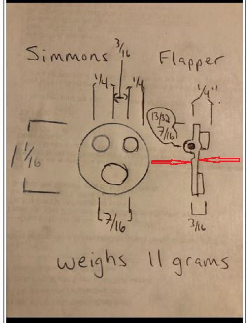

Kenny, thanks for the additional information on the type of material, please do post the dimension in question. Also, can you confirm the other dimensions on the drawing? I don't know who made the drawing, I think I found it on the forum years ago. I'm not planning on trying to make one from lead, just using lead to test out the mold, I thought maybe brass or aluminum. I'm thinking the type of material maybe isn't as important as the balance.

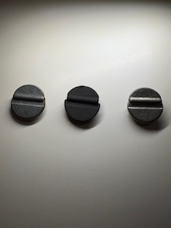

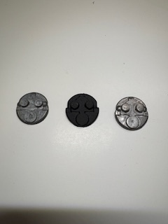

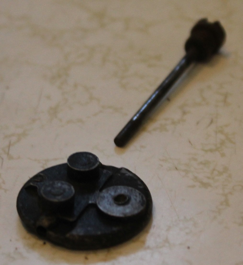

Here’s a few various flaps. The left (top) one is original and out of an NOS Simmons that’s never been ran. It weighs 10 grams.
The center flap is a 3D printed one that weighs 2 grams and is very accurate. The right one (bottom) is the one I had casted that weighs 17 grams.
I have the file that’s been modified from a 3D printing program to a usable CNC type FILE if Kevin or someone wants to give a shot at making them. Let me know and I can email it.

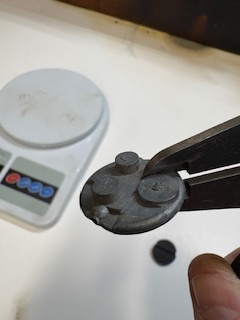

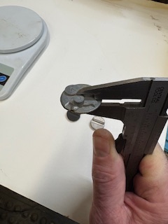

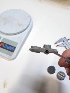

The measurements are both the same at .125”. They are offset though for the various functions. Let me know if there is a different measurement you need.

Another suggestion when sand casting, is to use a thin rod and introduce relief channels in the mold to help draw the metal and eliminate the irregular edges and bubble voids as is seen in your first attempt. Easily trimmed/filed off in final finishing, but produces a more pure casting.

Well, I think it's time to complete my story on my attempt to make a flapper for my Wizard / Simmons carburetor. I also needed a spray nozzle / jet, so I contacted both Corey W and Scott C, Scott didn't have enough demand to go into production of the spray nozzle / jet. Corey couldn't help me with the flapper, but he did give me the overall dimensions for the spray nozzle / jet, so I made my own from a NH jet. After Kenny sent me 2 files for the flapper, I abandoned my attempts to make my own. I bought some casting zinc and melted it down and poured into a piece of pipe. My son being a journeyman tool n die maker; I gave him the files. One file was a 3d model file, the other file he had no idea what it was, maybe a program file for machining. So, he wrote his own program for the type of machine was going to use to make the flapper with. He made 3 flappers; one went scrap with a drill bit broken off in it, one with tiny defect in the edge and one perfect one. I gave the perfect one to Kenny for the files he sent me. In the end I ended up with a carburetor that idles smooth and preforms very well at all speeds. It preforms much better than my Holley NH sway back carburetor.
