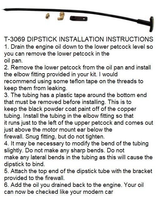

T-3069 DIPSTICK INSTALLATION INSTRUCTIONS

Frank thank you for the illustration what you pictured is what he purchased i will take a second look at it. The man up in montana is still making the ones he sold at the winter clinics itreplaces the drain plug on the bottom of the engine and can be mounted on both sides of the engine it also has a more period looking dipstick and is superior to this set-up. again thanks for the help and thanks to all the others here who responded.
