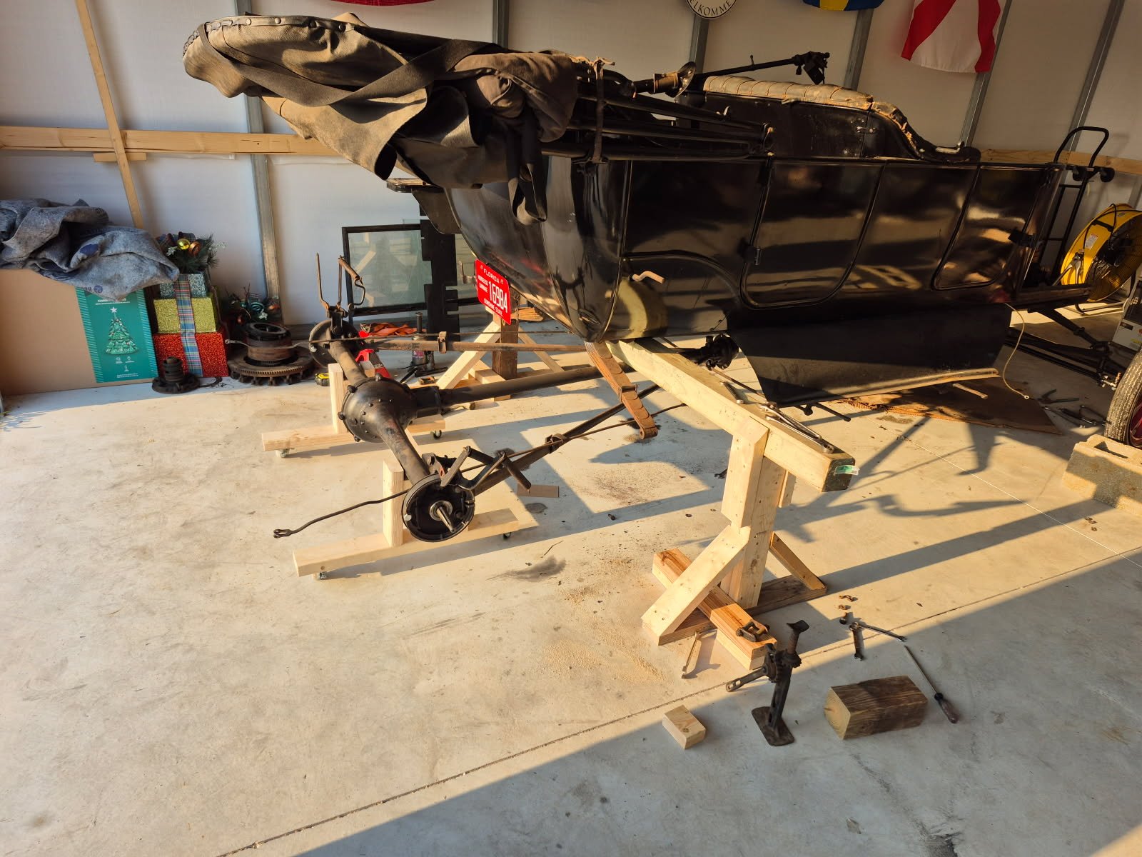

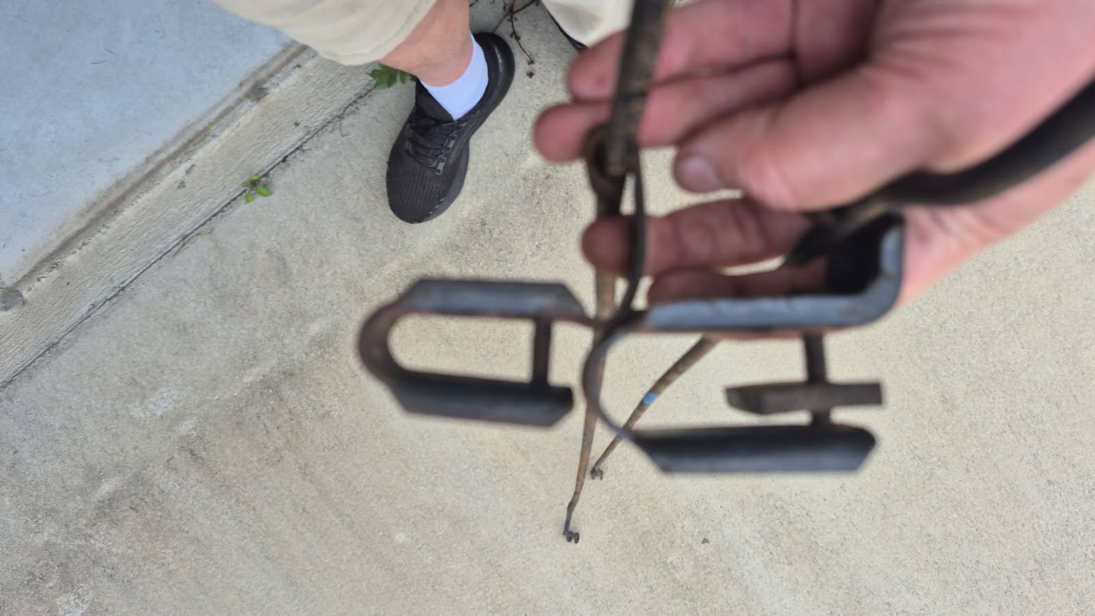

Continuing on with the restoration of the running gear, up next is the rear axle. Daisy has obviously seen a lot, had travelled across the US in '16, and must have been driven hard, as every time I dig into something she show's me she's hurtin all over.
So, out she came... She has two different brake rod supports... one maybe from a TT?? Given wider U, which required a wood shim...whatever worked, was good enough! Some interesting wear pattern on the 4th main... The axles are gonna be garden stakes, had some serious lateral play going on so diff shim no doubt shot given the drums were eating into the brake shoes, a shattered keyway on one of the axles, roller wear...

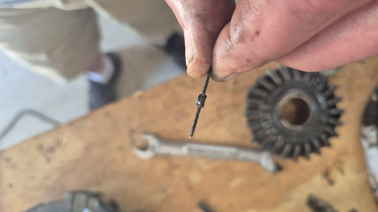

The pinion castle nut was pinned with wire bent over each end, but once removed, the nut was finger tight! I spun it right off, and the pinion gear simply slipped off the key/shaft!!!!

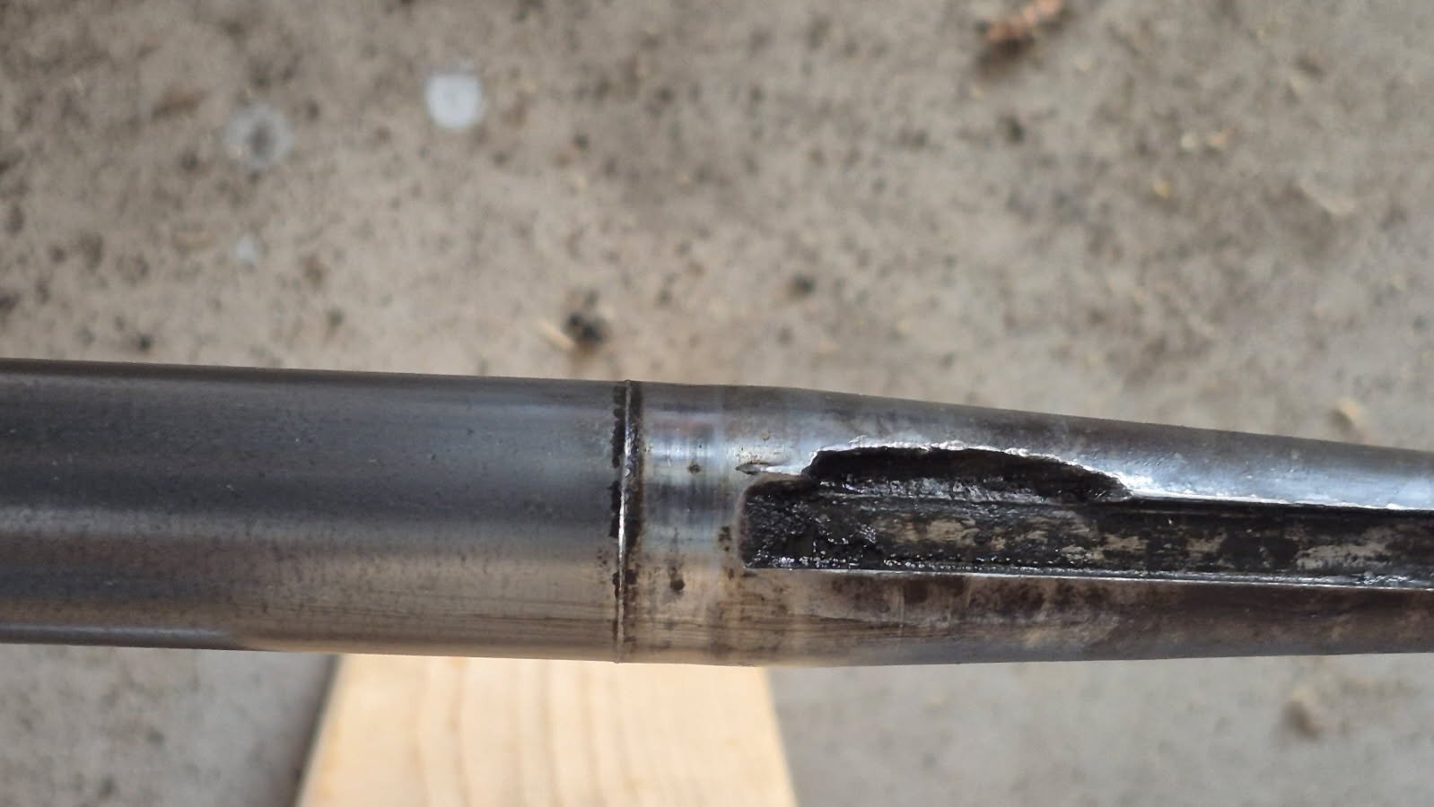

I have NO idea why ya'll have such trouble pulling the inner sleeve off the driveshaft... mine simply slipped right off!

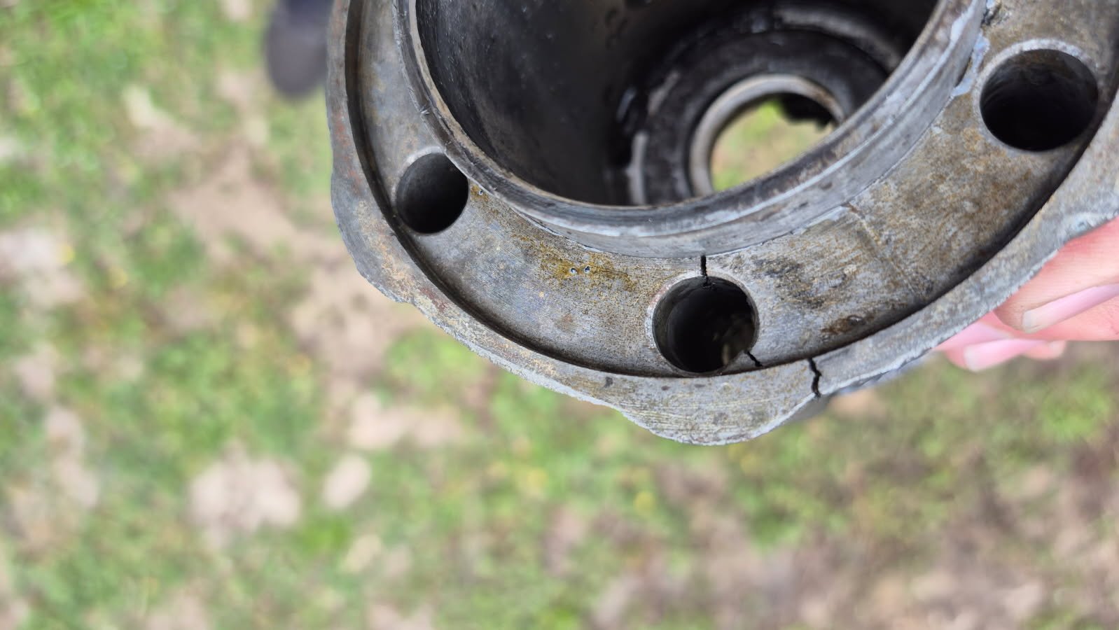

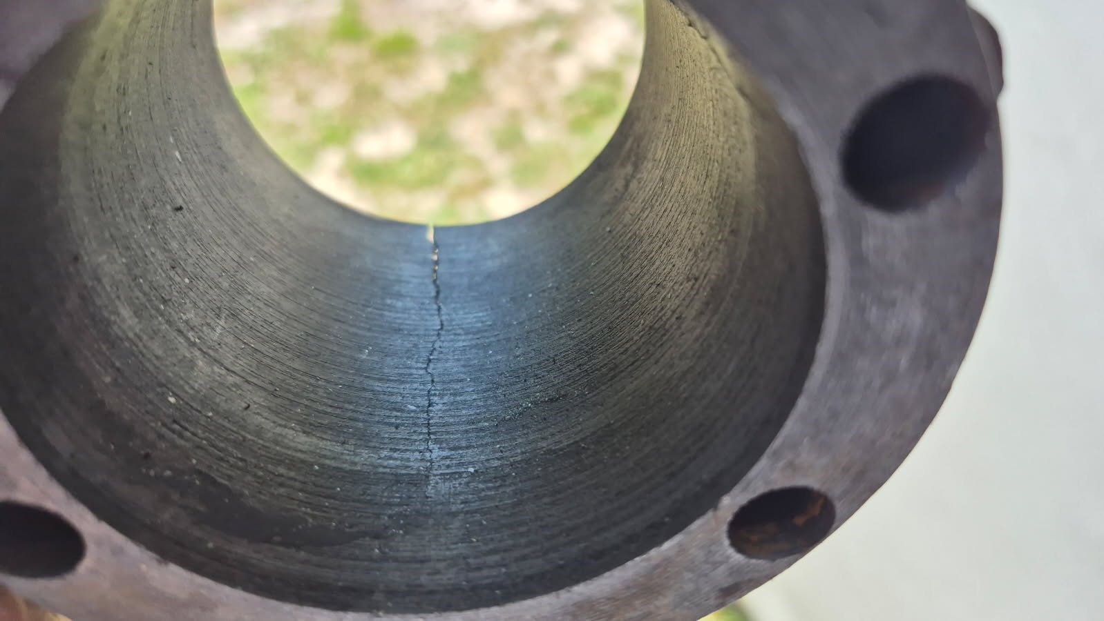

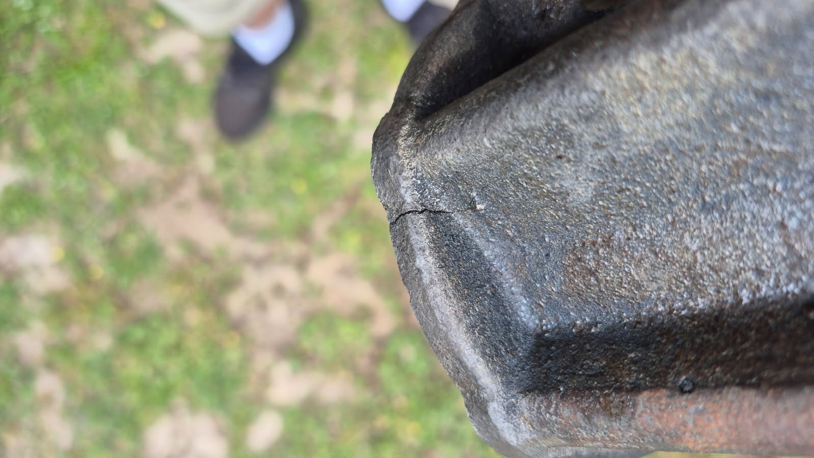

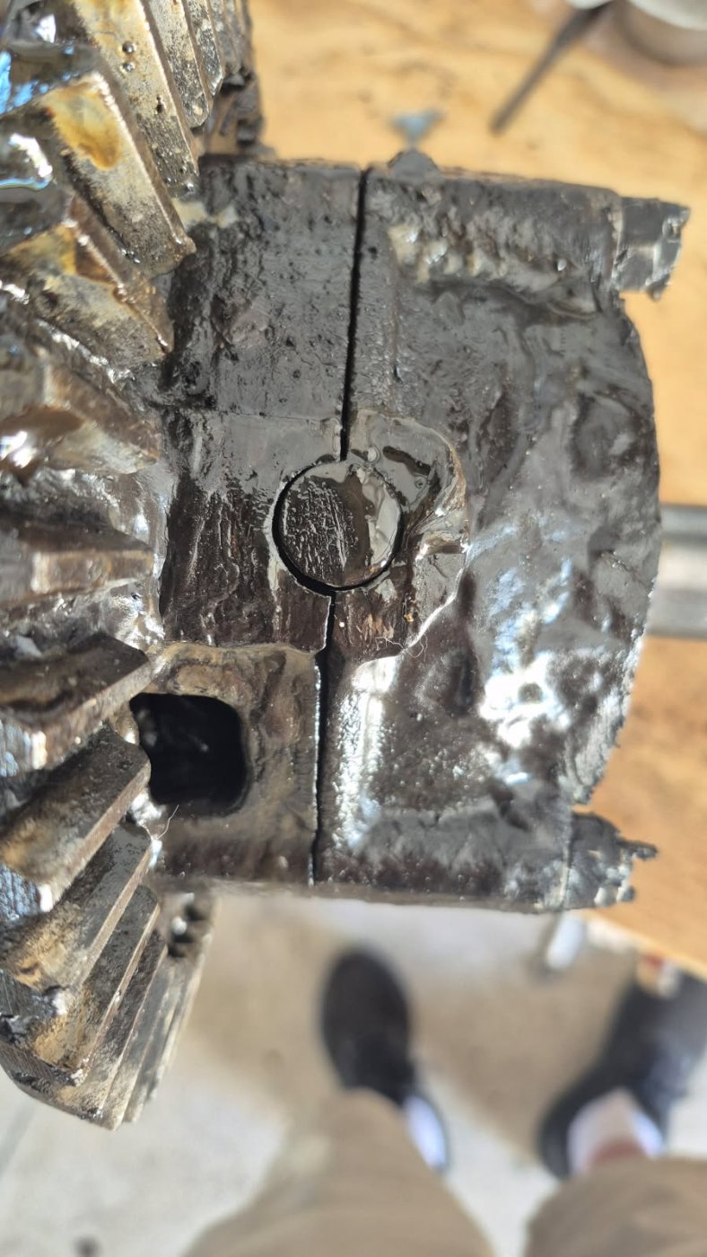

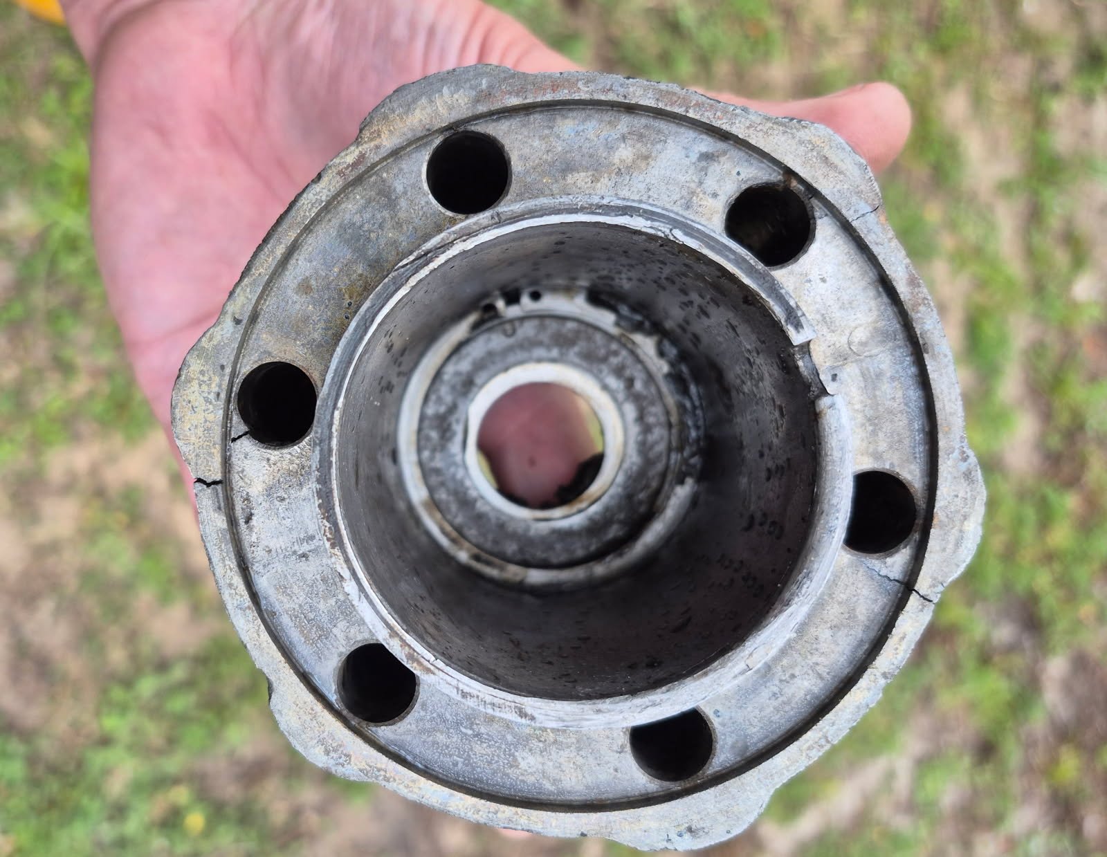

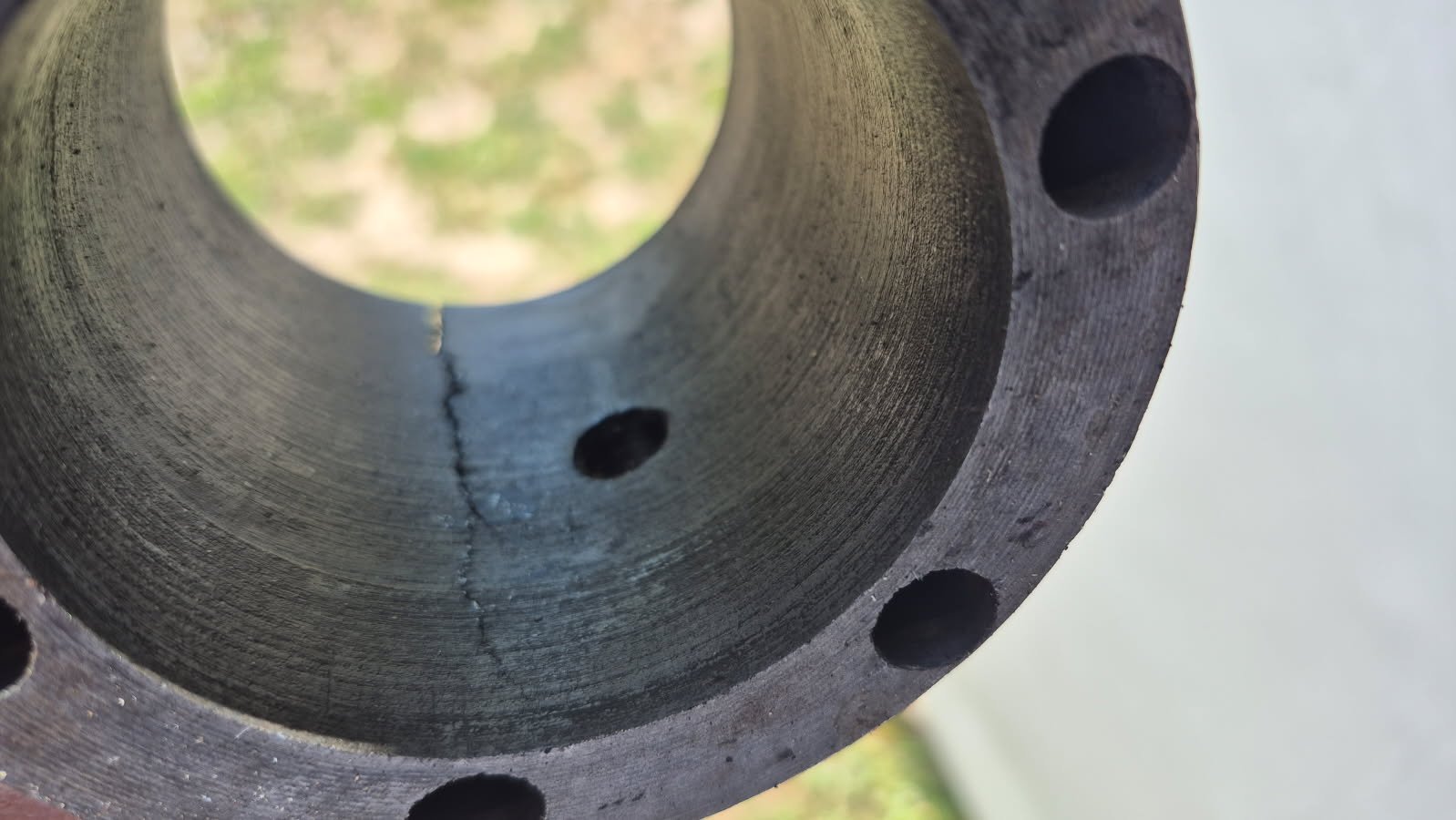

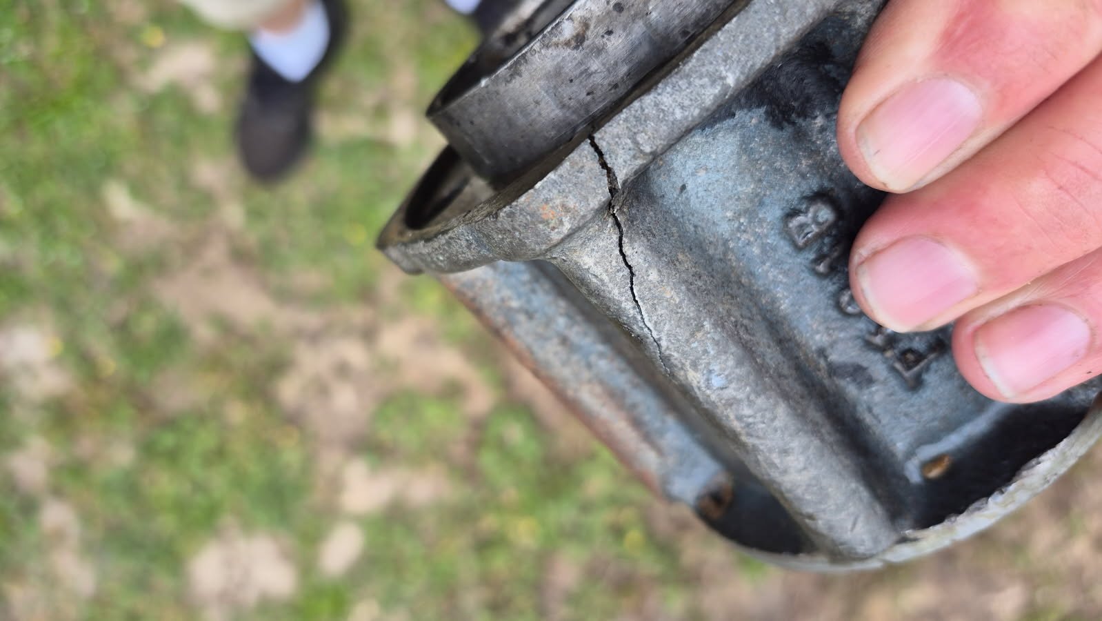

Along with showing the first of many discovered cracks... The spool outer sleeve showing it's wear...
The U-jount appears to actually be in pretty good shape, some wear, but no discernable slop, certainly not like what I pulled out of my TT...and no serious wear in the front bushing, at least not enough to reflect any wiggle/play in the driveshaft.... But as good as she looked at that end, the pinion side is a disaster. The spool bearing was so worn it had a good 3/16"+ slop.

The spool unfortunately took a beating with all the flopping/banging around inside, as it has multiple cracks...

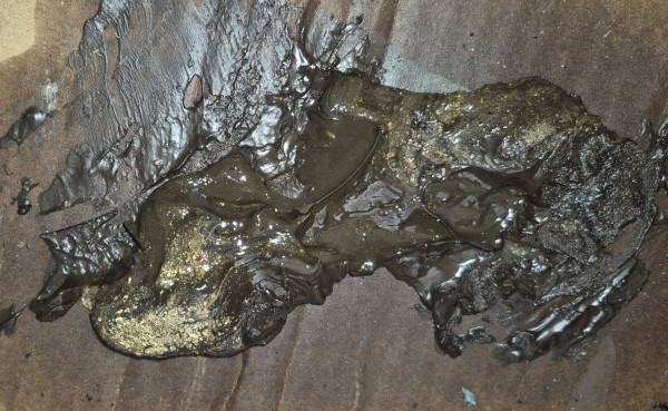

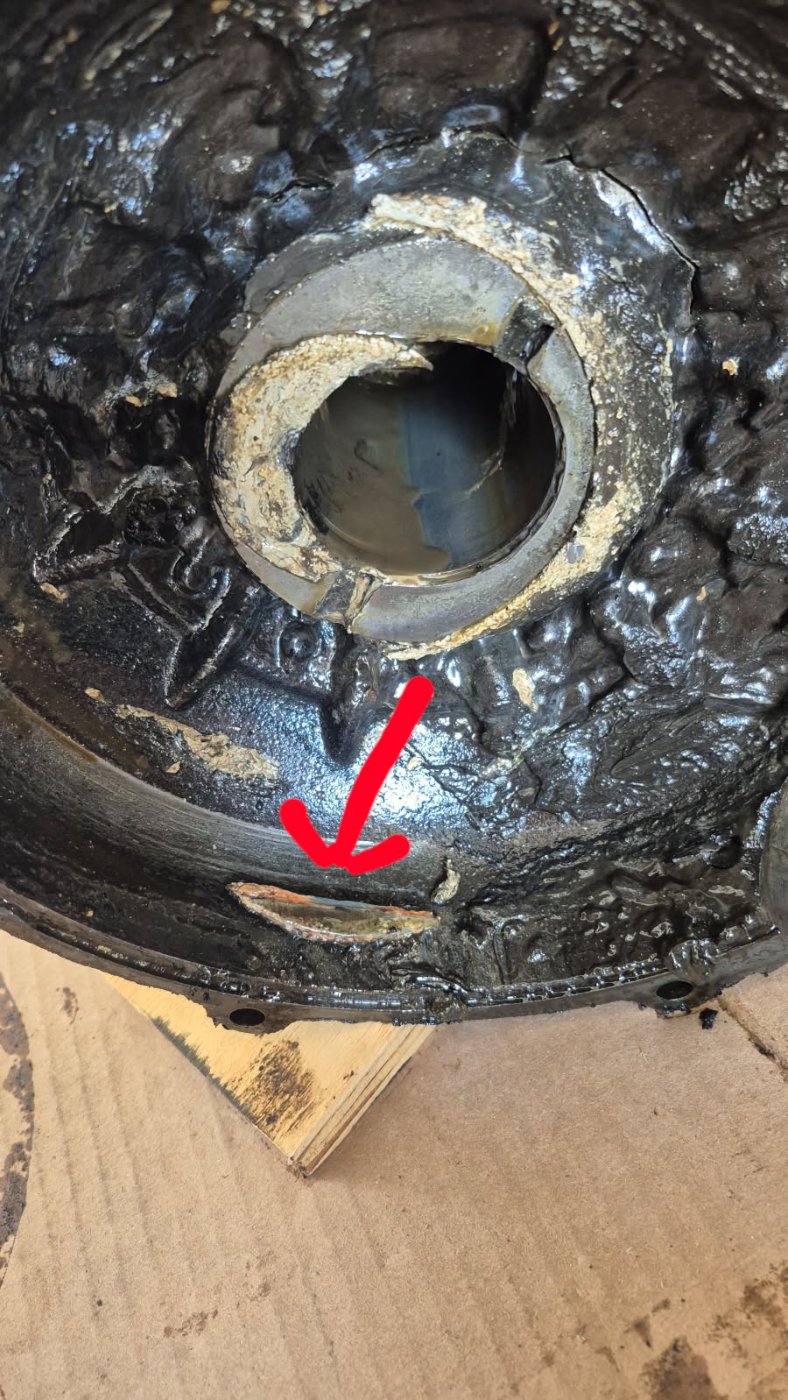

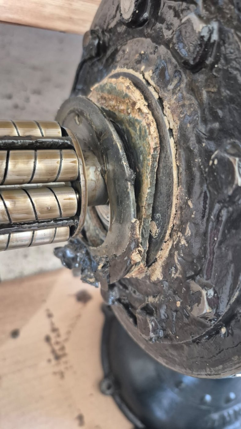

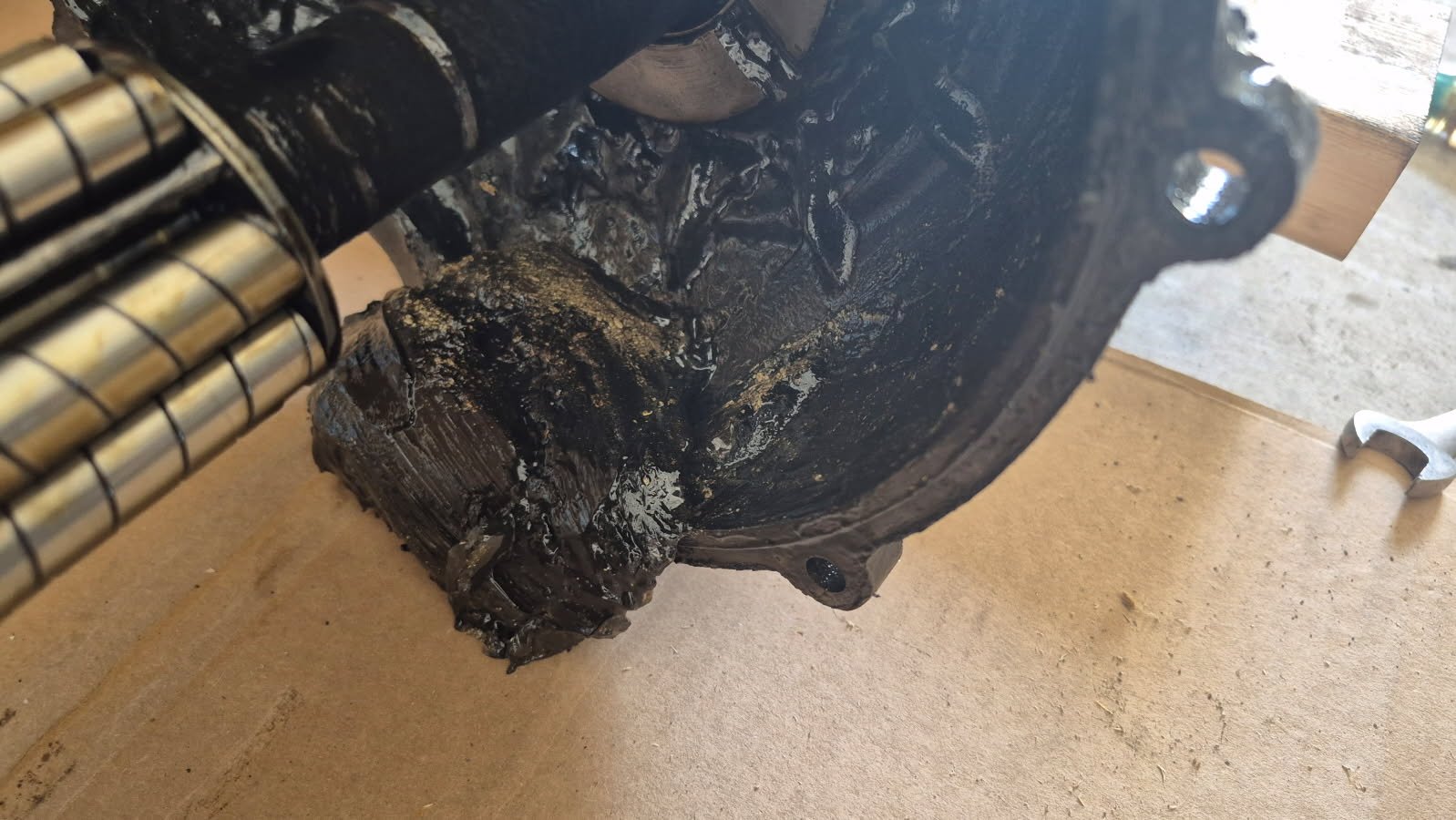

Case split, of course the usual 110 yrs worth of sludge...

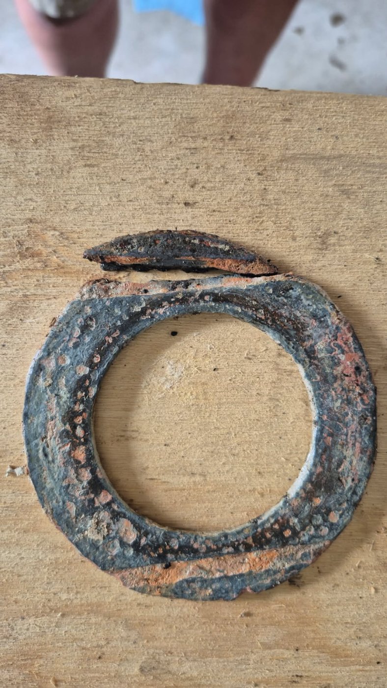

The babbit thrust bearing was dissolved to sludge... obviously 100 yrs worth of water/acid doing their job... but... also had a big chunk broken and embedded in the sludge....

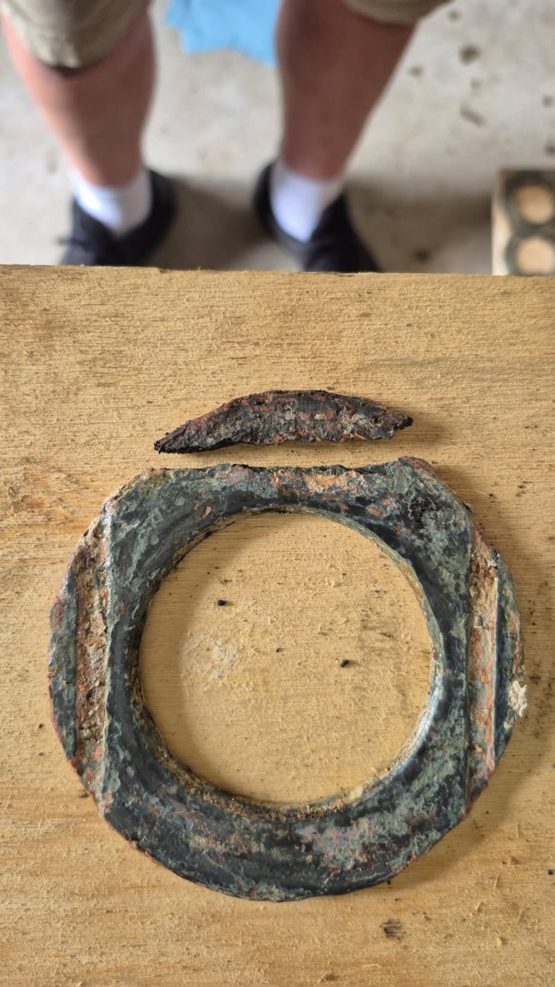

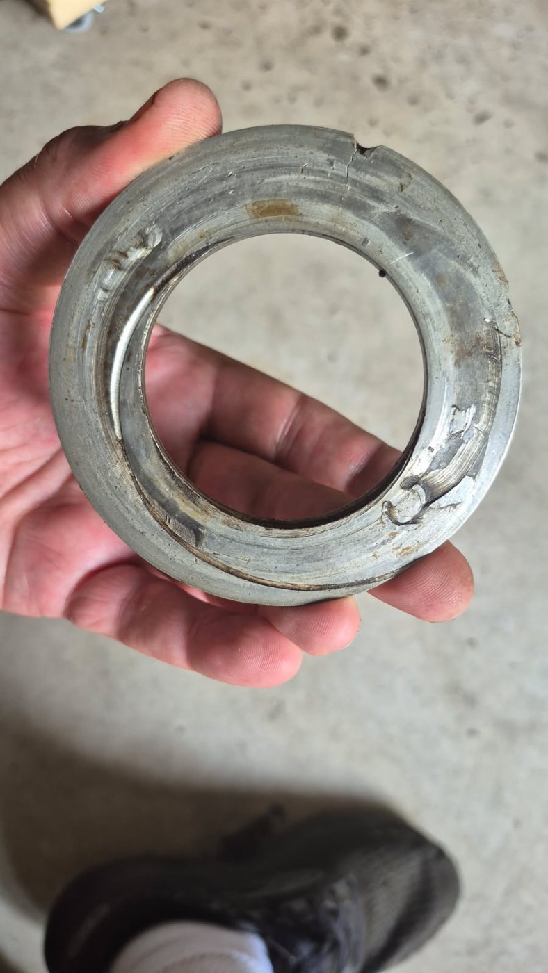

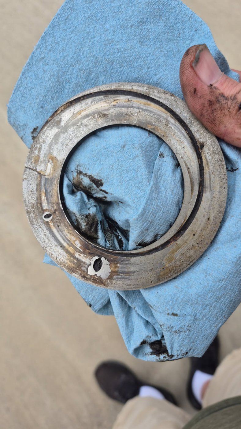

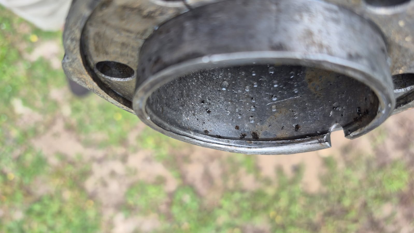

The right side thrust bearing is a totally different design, appears to be steel, with a spiral lubrication channel. It too though has stress cracks...
While the pins are intact (but worn), the steel washer locating holes are wallered out, so much so allowing them to drop and eat into the diff carrier....
I have only been able to twist out one outer roller bearing sleeve... the other one I can twist about 1/8" inch, but no joy past that (and yes, the grease cups are removed). The inner sleeves however are being obstinate, and not budging....

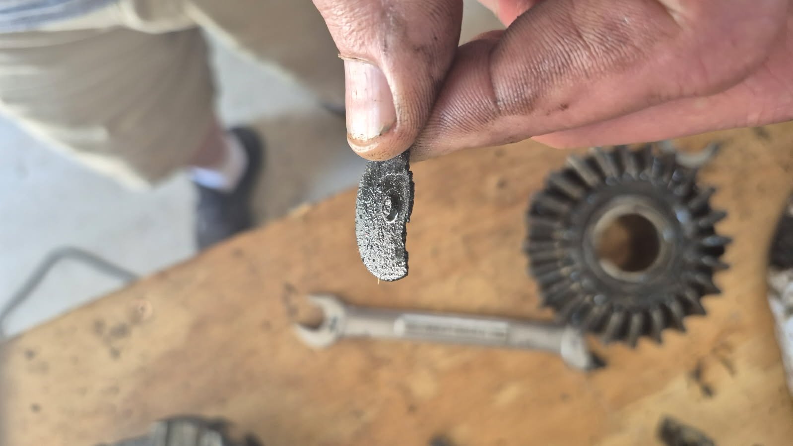

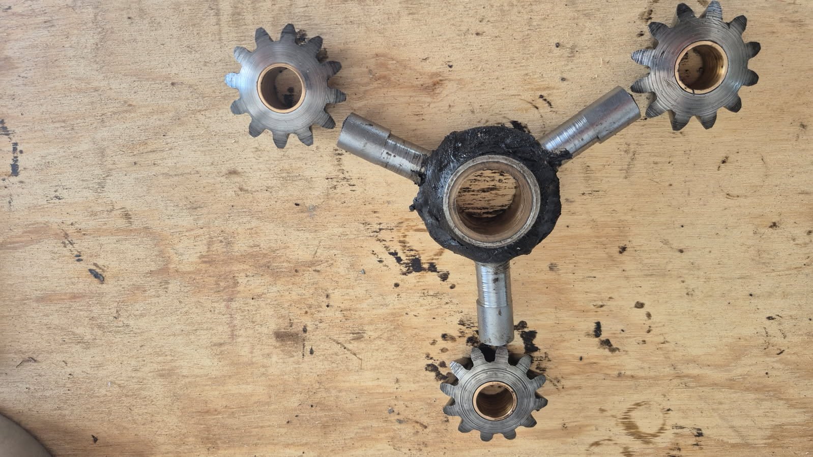

Being an early style diff carrier, the halves were attached via stud/nut, not bolt. While the nuts were cottered (with bent wire), all 3 studs were loose allowing separation of the case. No doubt why Ford redesigned to bolts. I wondered why the nuts weren't wired together in series, but not sure there was clearance to do so.
The spiders, early style with bronze bushings, were badly worn...
The center fiber bushing was literally compressed into 'one wafer thin mint'....

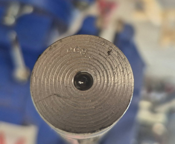

One axle I know for a fact is original....
The other axle has a stamping that's not quite clear... is it an H/R/B - C/G - S/8...????? Anyone know???

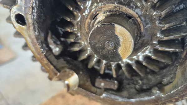

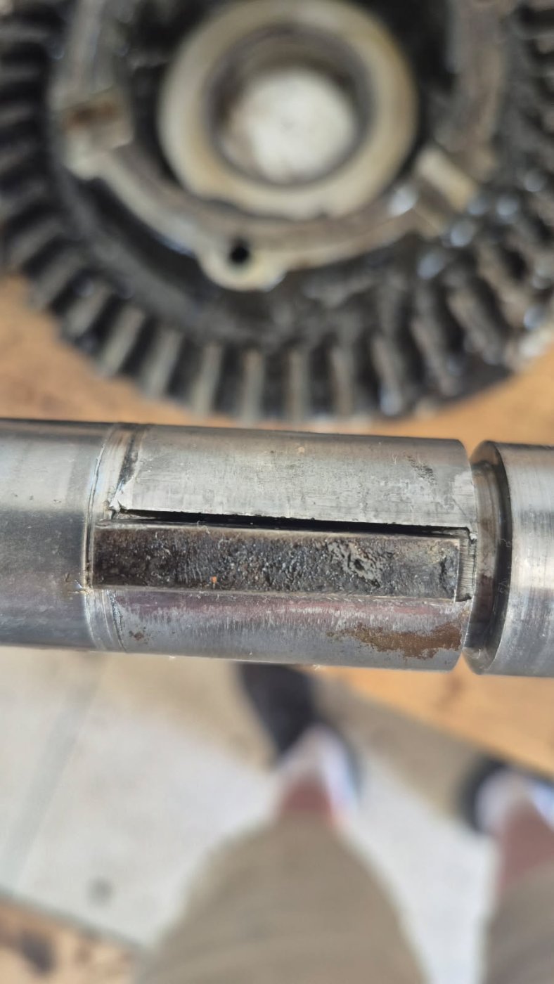

While I still had to press the axle gears off, they did show torsional wear given the keys and axle key slots were badly worn...
Getting back to the driveshaft roller...boy did it endure a lot of torque twist with as much wear clearance existed....
I'm surprised it's still intact... Needless to say, Daisy has seen a lot of hard miles, and obviously endured a lot of high torque conditions...

Lots of bronze from the spider bushings glistening in the sludge!

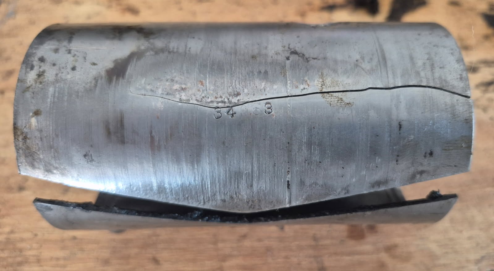

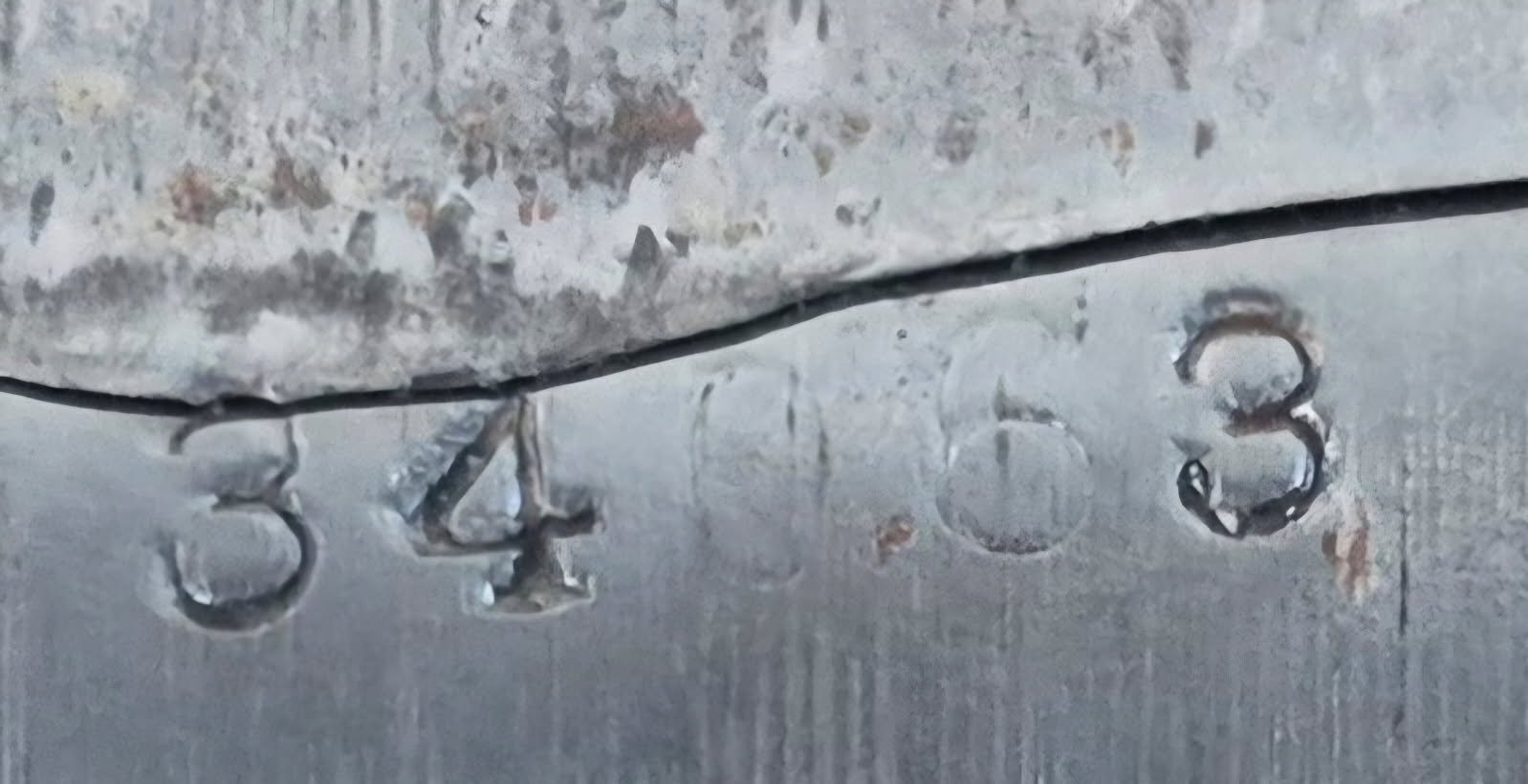

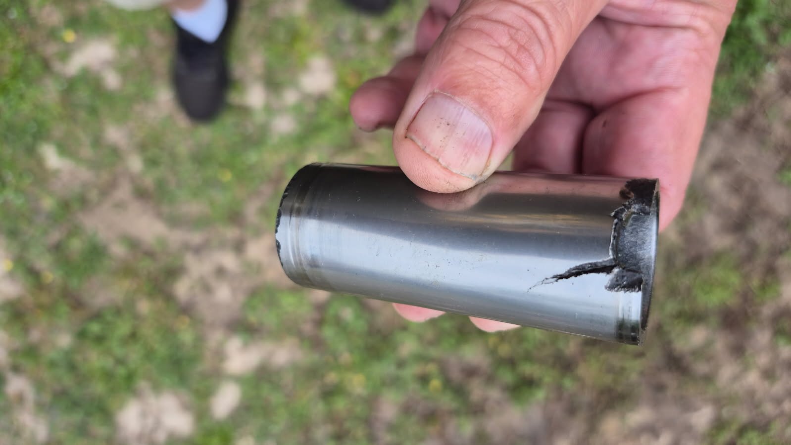

The one roller sleeve I pulled was cracked...not sure what would cause a sleeve to crack....excess heat?? Fnding lots of stress cracks in many components though.... I may have the outer shells professionally cleaned & magnafluxed, not that I can see anything...but...
Curious about the stamping on the sleeve.... 340.63
Anyone???
Anyone???

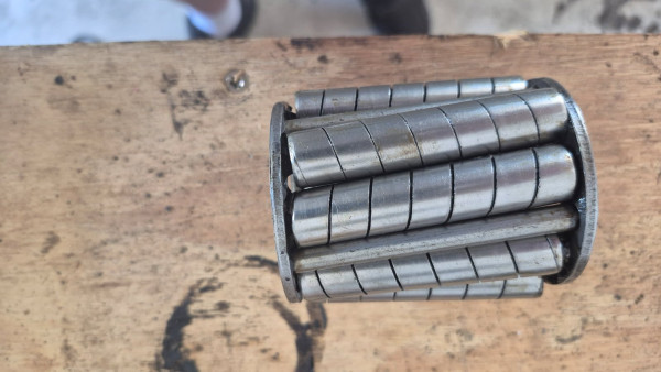

The DS rollers avg 0.553

Ya, the rollers looked good, but trash so says the micrometer.
Beyond that, the cage support pins are so wallowed out you can see the twist in the pic, but so ovaled out and thinned pins I'm surprised it was still intact. Looking to be all original never rebuilt, and showing it's age. Well, can't say never rebuilt, I doubt Ford pinned the diff case nuts with bent wire, but not sure what was replaced given all early period parts...

The outer and inner axle rollers are just as worn out unfortunately.
Interesting how much difference between the left & right axle side though...
High & low for each roller
Right outer: .4975 - .4960
Right inner: .4975 - .4965
Left outer: .4960 - 4945
Left inner: .4960 - .4940

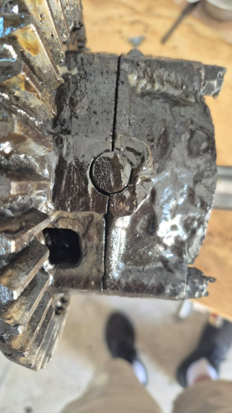

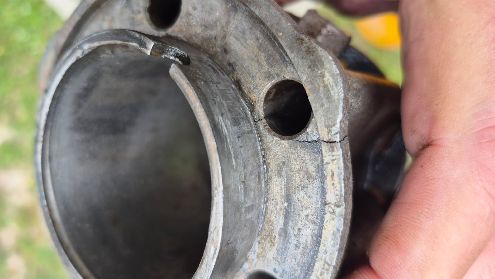

Given all the cracks in the spool I considered it junk, but decided to press out the bearing sleeve anyway just to have a look see internally... yup... Just about another 2 piece of a 2 pc DS!
Cracks were deep, two major ones 60 degrees apart.

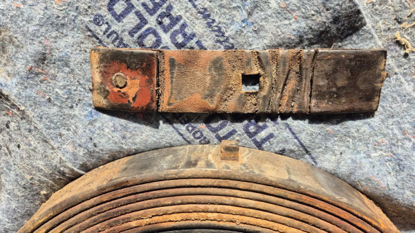

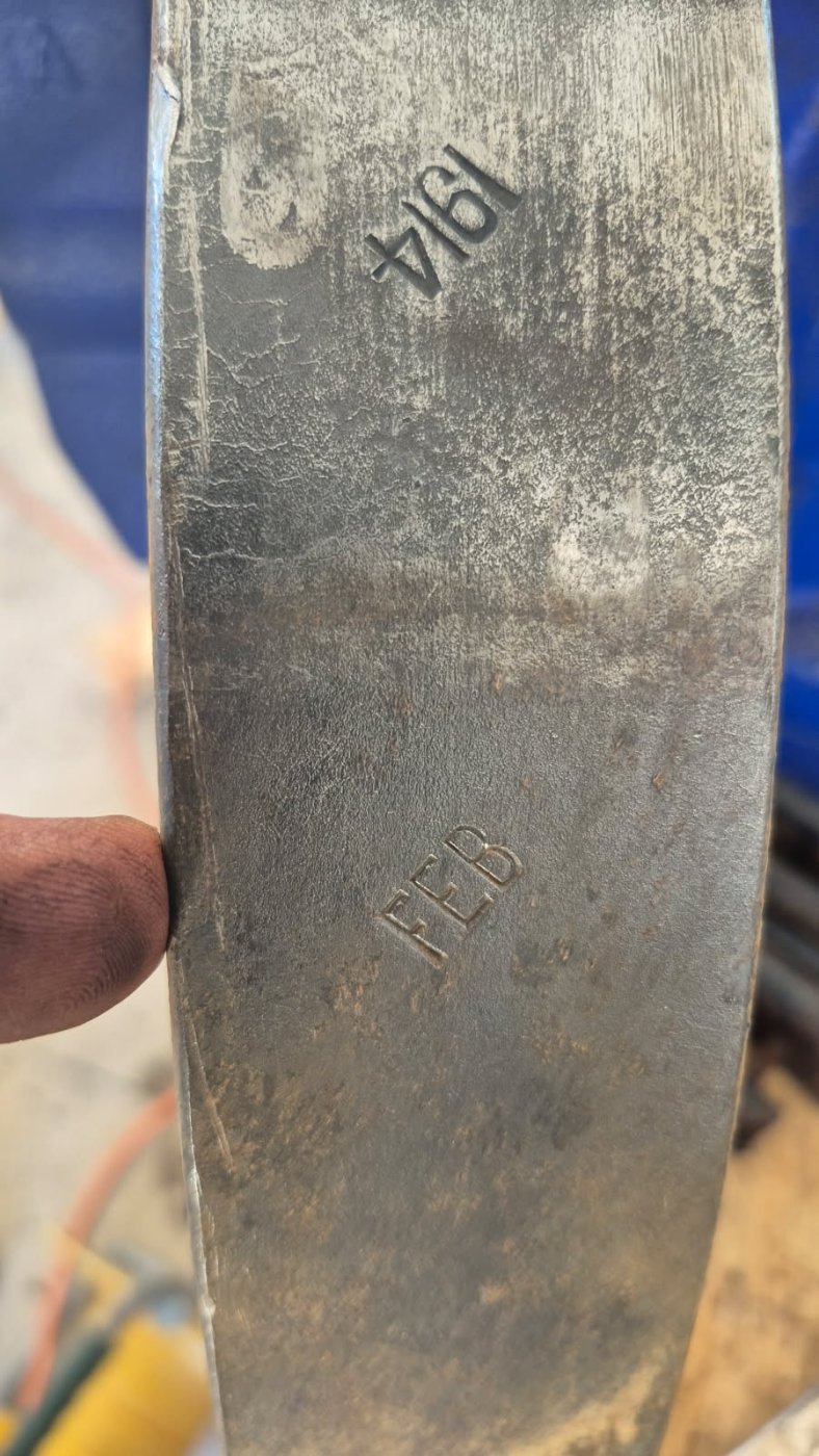

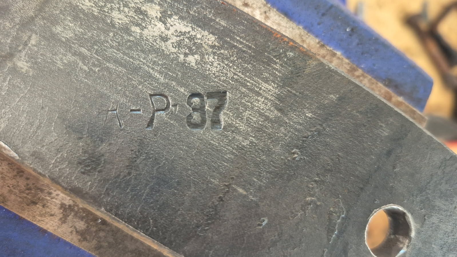

Daisy was a March 14 build... her front spring was stamped 1913... pulled the rear spring, carries a Feb '14 stamp.
There is another stamp, clearly - P 37... but with another leading stamp not fully clear... A? R? Anyone know what that stamp references??
Interesting how the leather pad drew up accordian on one side and not the other...

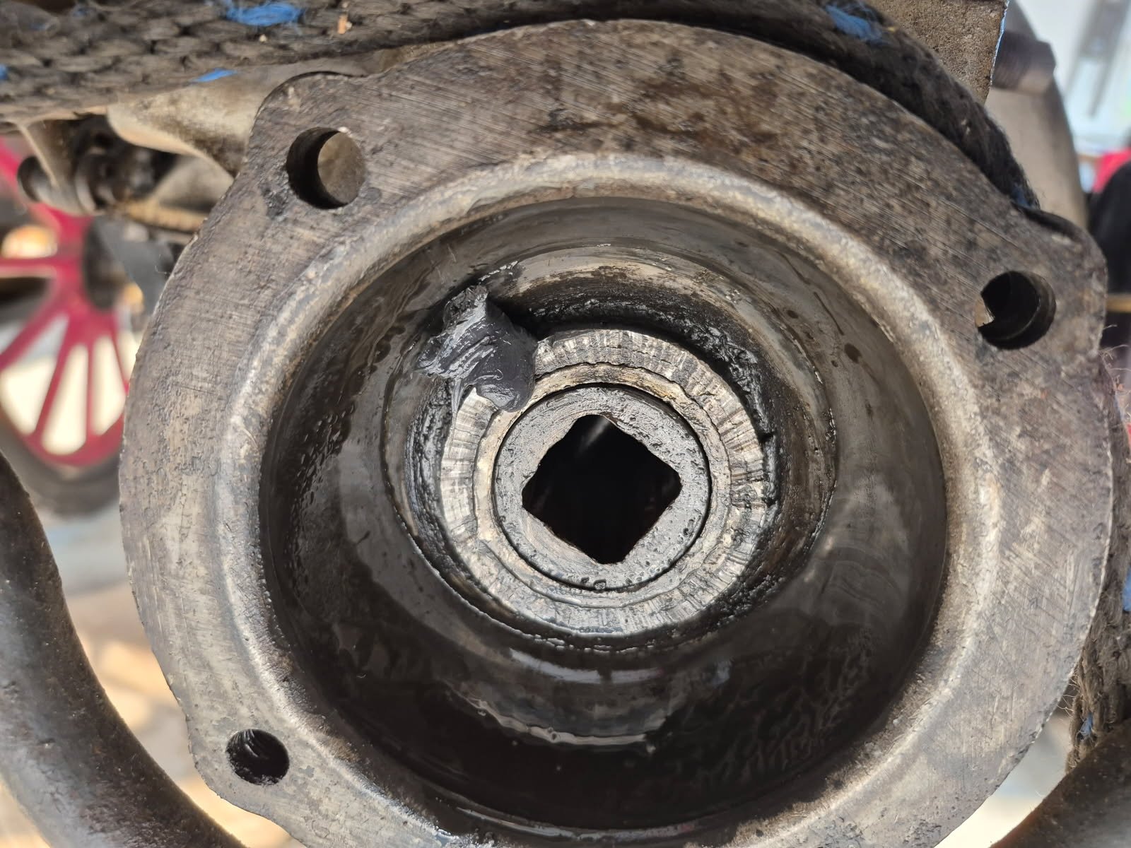

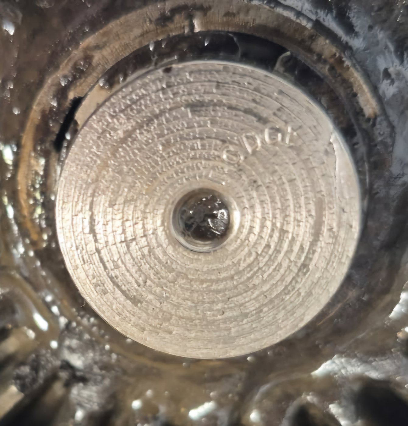

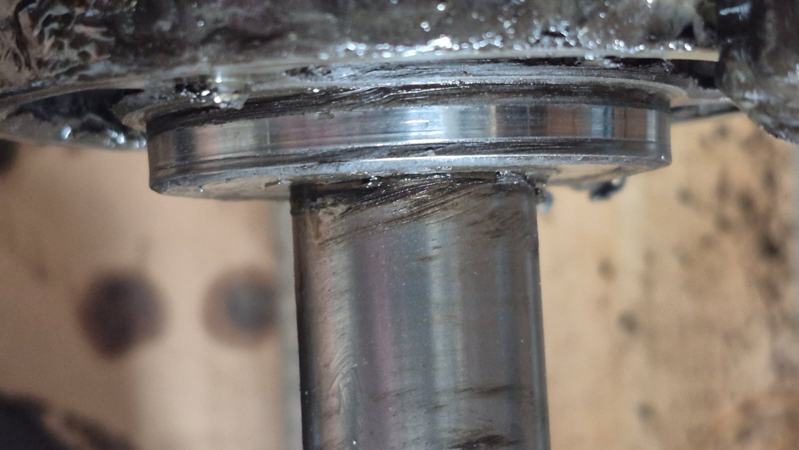

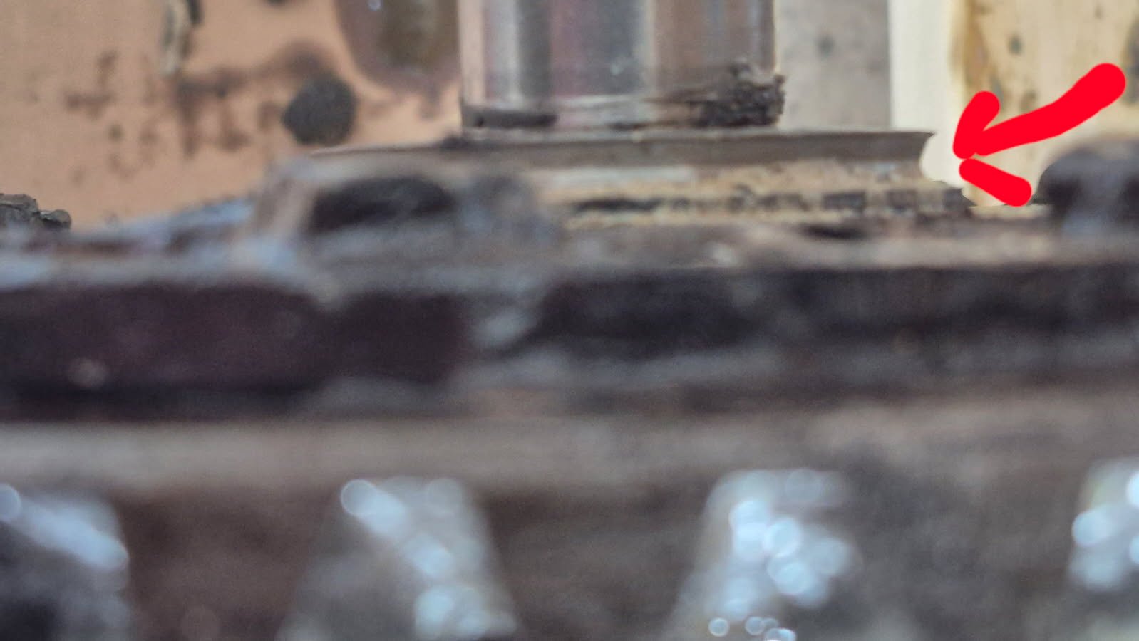

Realized I hadnt posted this other wear point, at the driveshaft thrust bearing from all the flopping around...

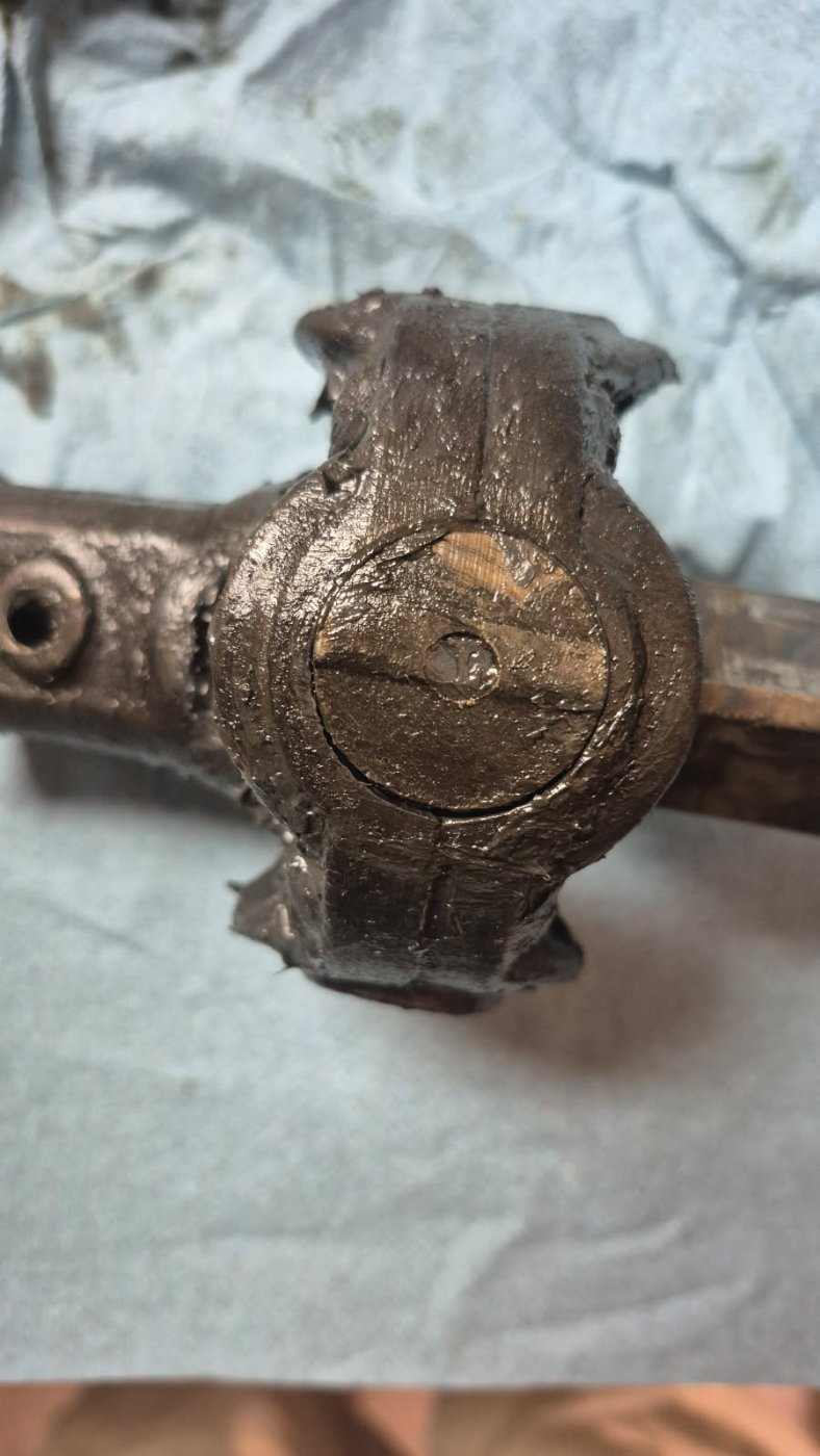

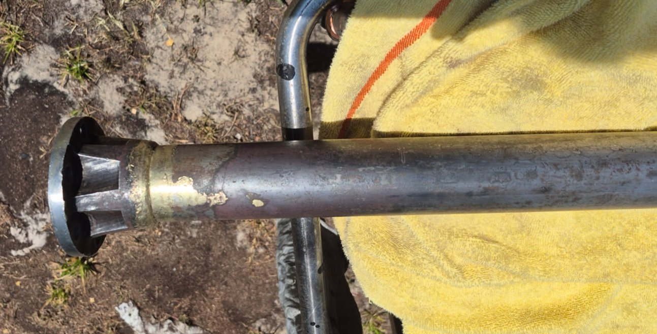

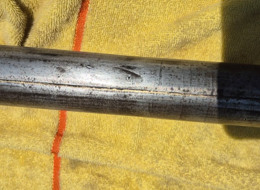

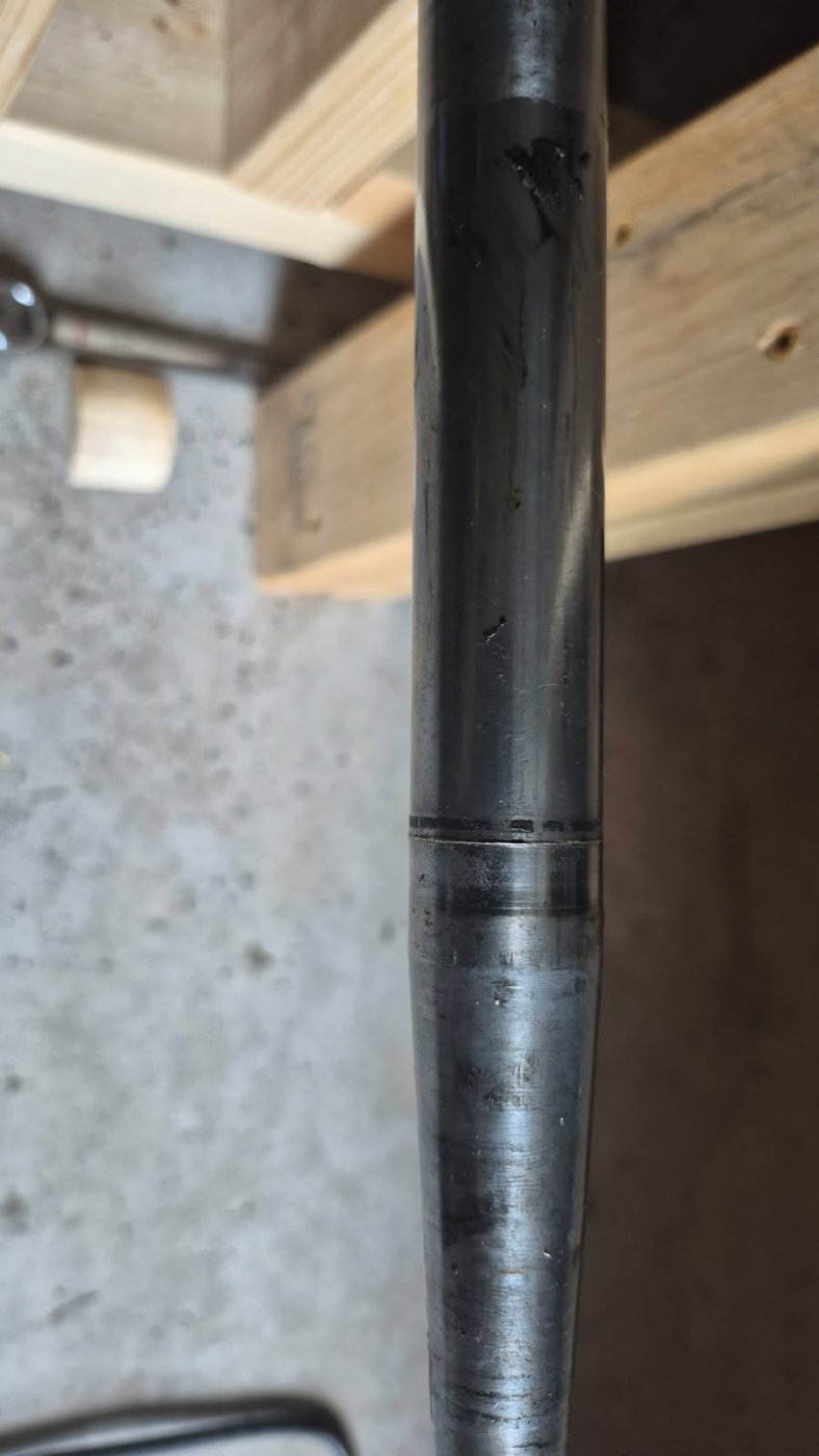

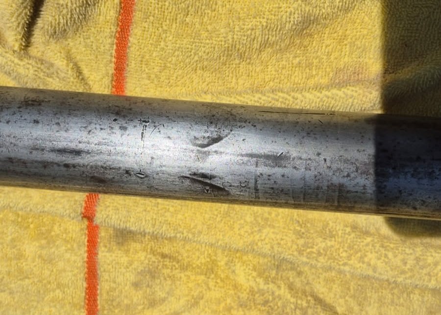

While the internals of the drive train are well worn from some obvious long use, the external components of the car are pristine. I'm used to descaling most every component, frame, springs, axles, etc,and dealing with heavily pockmarked metal. But not Daisy. All her externals, chassis to body are solid.

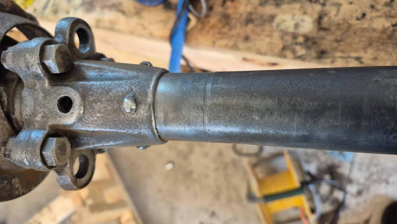

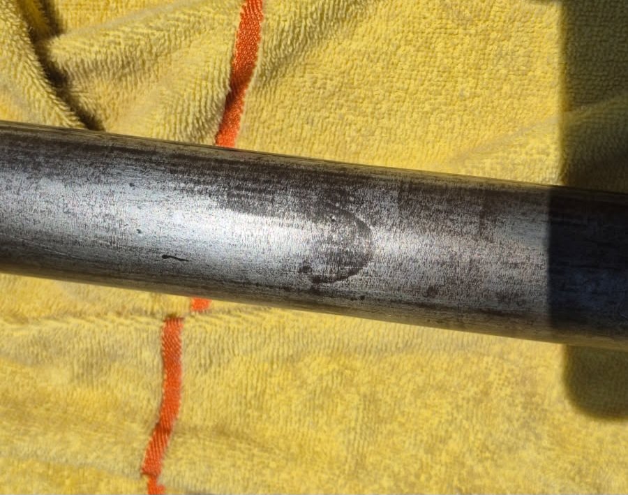

Here's some pics of the torque tube: I noticed something interesting on the tube, about mid-length, 4 equally spaced 'U' depressions, obviously some type of 4 point vice/grip. Not sure if these are manufacturing marks, or something else that occurred later. Anyone else ever see these?

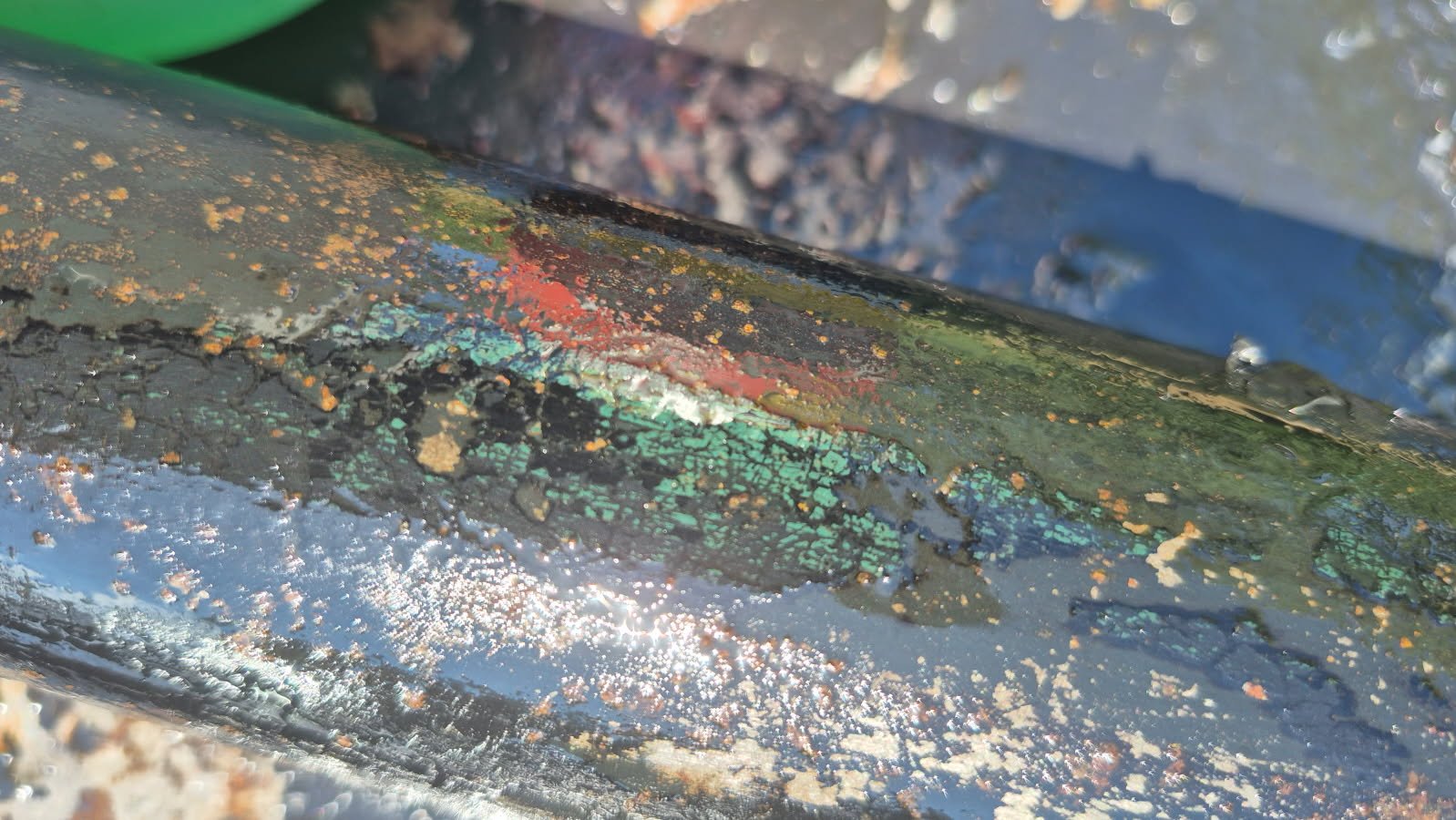

Radius rods were interesting though.
Like components of the front & rear axle, the forged forks are also Dodge.
But stripping the paint I ran thru layers of black, slate blue, green and red. Apparently somebody liked to dress up Daisy periodically. Meanwhile, the torque tube only had black & green, while the axle housings only showed black. The wheel spokes, though currently red, only show black under that, but, appears to be a similar red to the RRods.
Quite a kaleidoscope.
