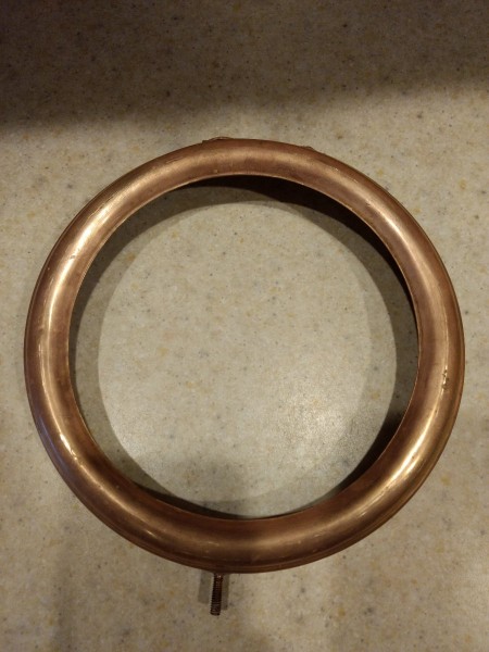

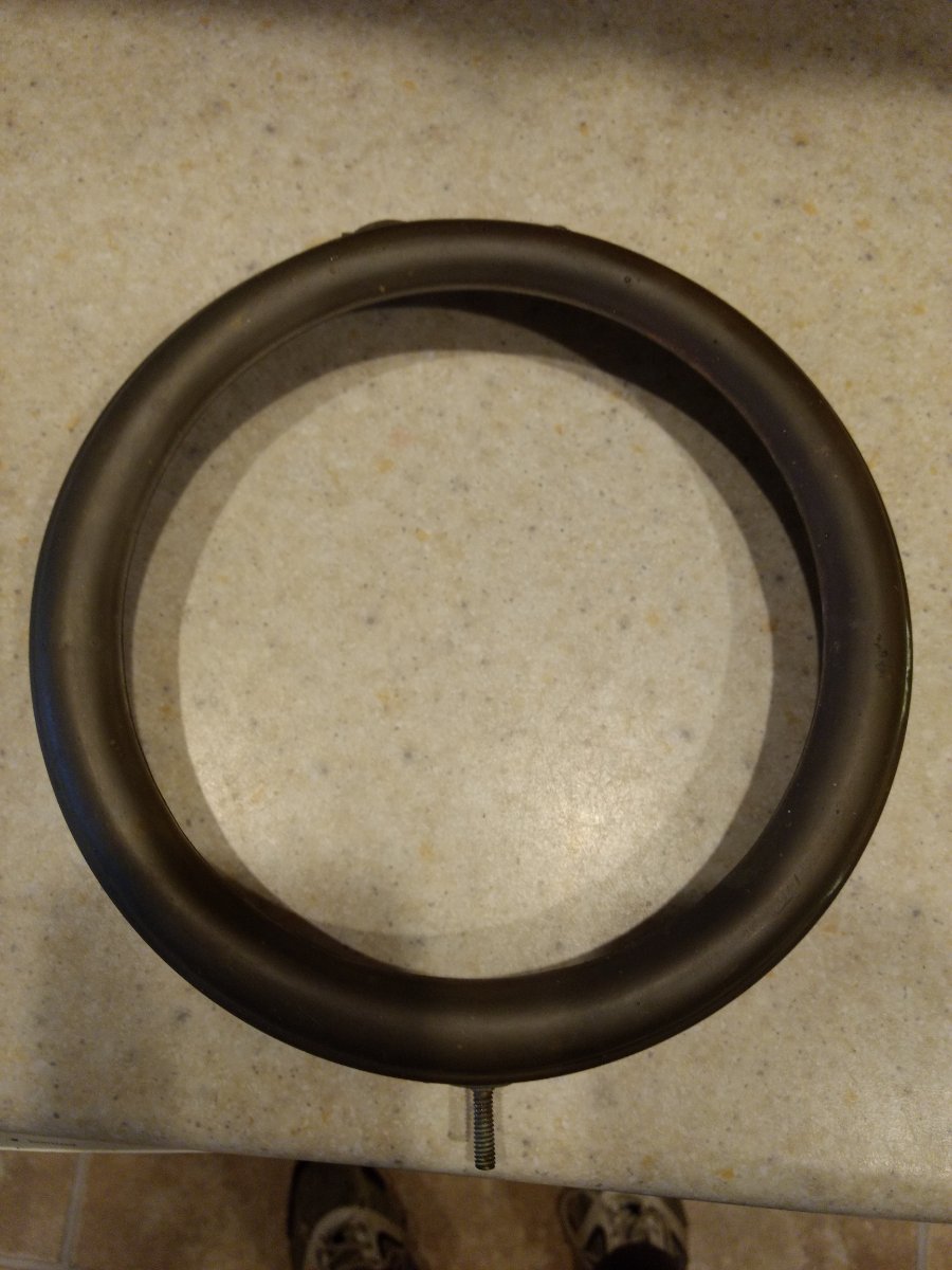

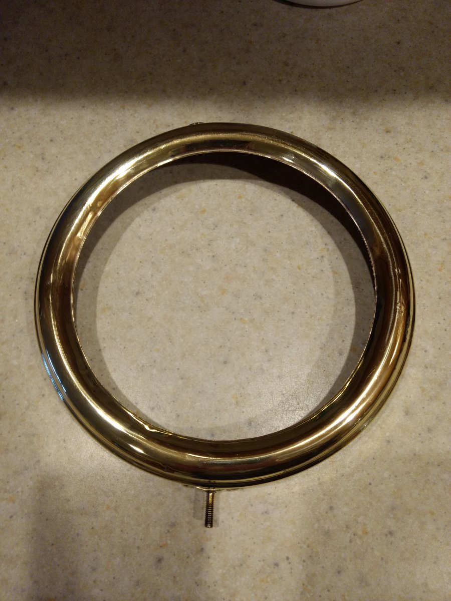

After disassembling and reassembling my headlights to polish them I ended up breaking a lens. Is there a source for these or do you have your local glass company cut them? Thought I'd share the before and after as well. Bottom one is before. Second is after vinegar bath. Third is polished. Turned out pretty good with minimal work.
