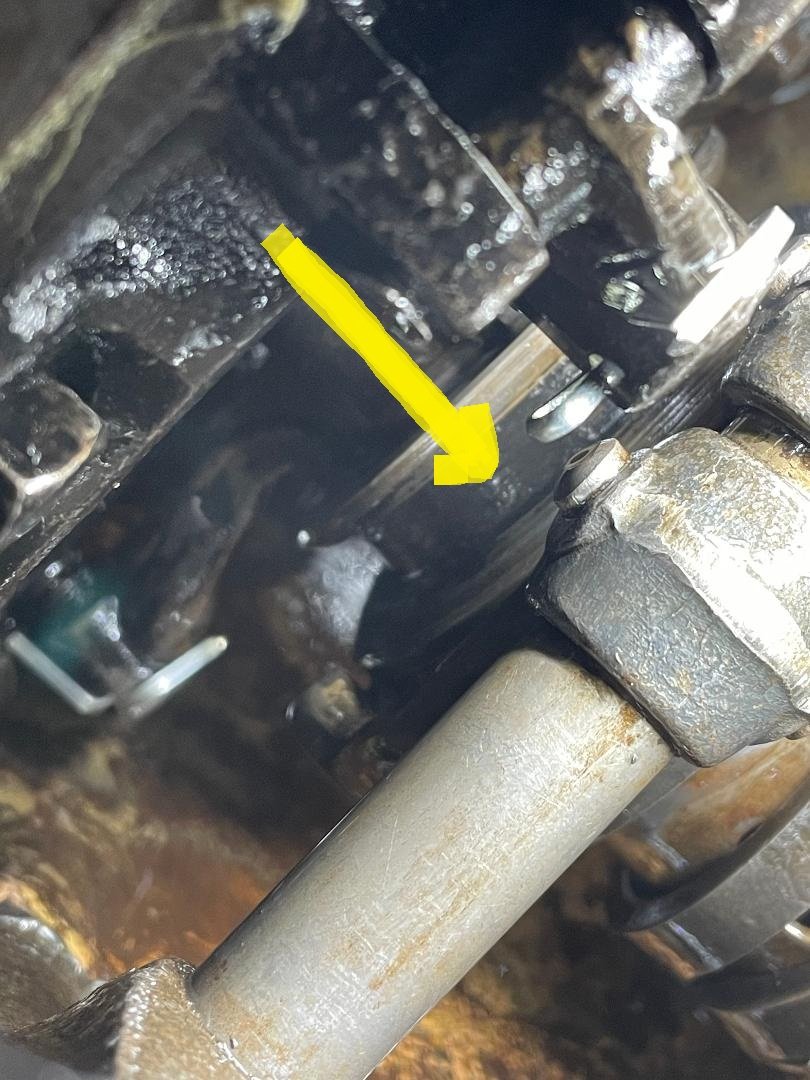

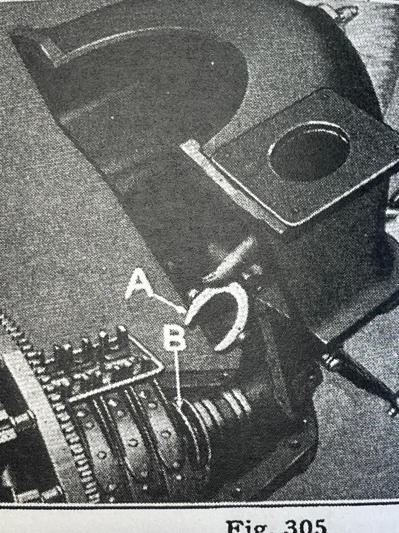

I think I installed my clutch release ring in the incorrect location but wanted to confirm before pulling everything apart again. Is the location, as pointed out in the handbook (pictured below) the same as where I put the arrow on my picture? Thank you in advance!

You have it correct - it goes in the slot closest to the spring - not up by the clutch adjustment fingers.
It only fits in one of the 2 cutouts. The front is a larger diameter, larger than the brass throw out will fit into.

Just for clarity, as I reread my post and not sure if I was clear with my explanation. The picture I posted of my transmission, the location where the yellow arrow is pointed is NOT where my clutch ring currently is. That picture is of the transmission cover already installed and the clutch ring is beside the area where the yellow arrow is pointed. Hope that makes sense, lol, just need validation...
Even so, you still have it done correctly. :)
