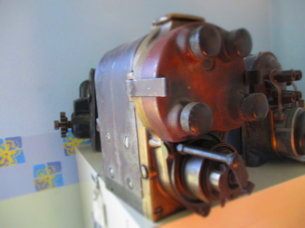

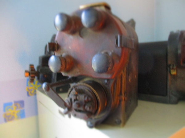

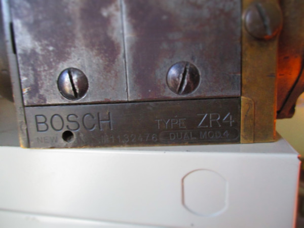

Just found this magneto in my parts accumulation. Although I've been fooling around with Model T's for years don't know much about this magneto. Please educate me.

Your magneto looks like it’s missing some bits.

I believe that distributor cap is incorrect. I think the correct cap should have a 5th terminal in the center of the cap which is connected to the dual coil switch.

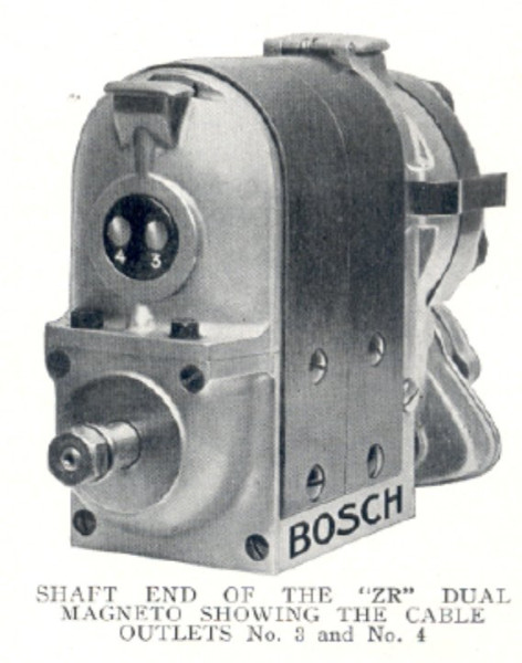

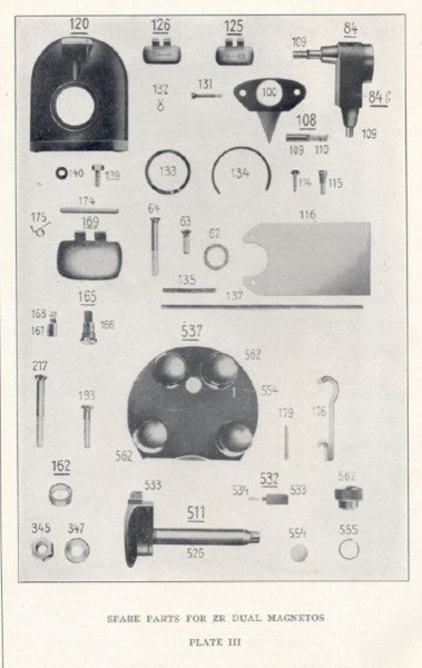

The distributor cap looks correct for the ZR4 Dual. There should be two connections on the other (input) end of the magneto. One of these is the "5th" terminal.
