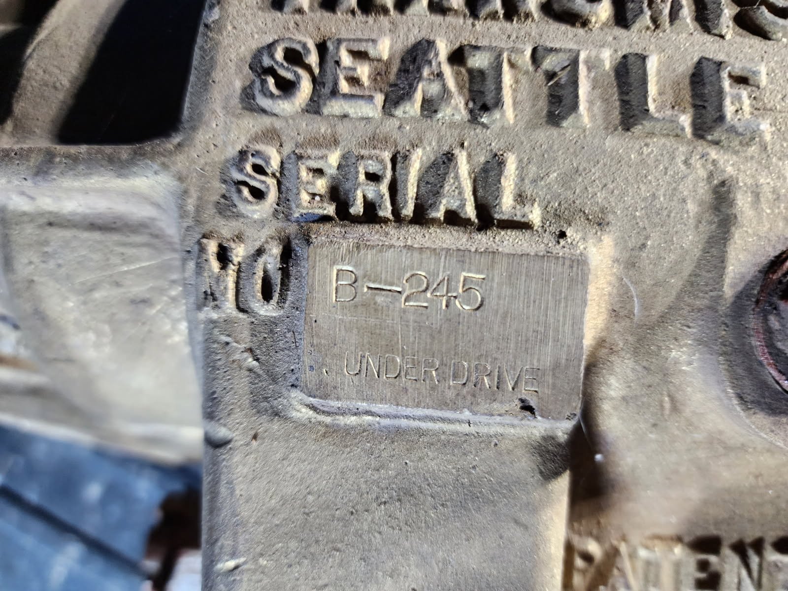

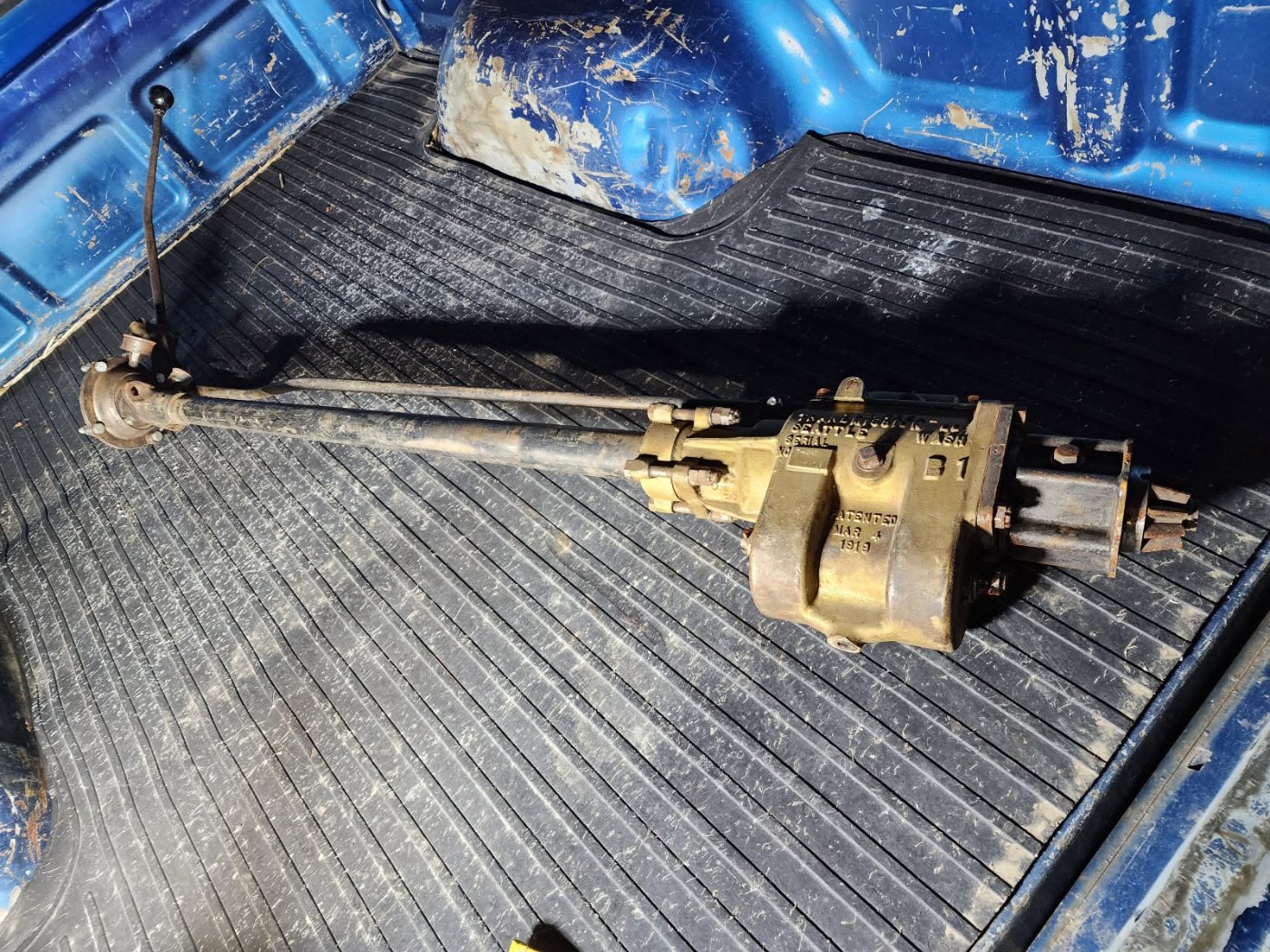

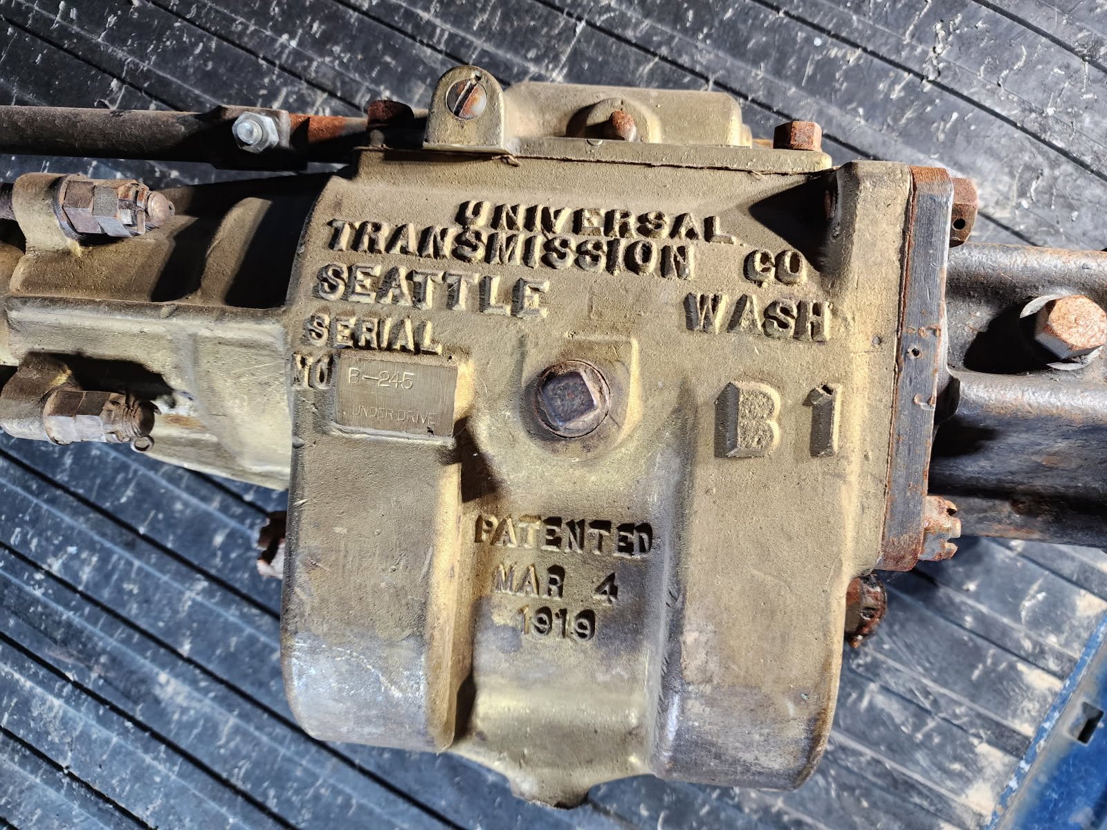

Hi I have a complete under drive that was manufactured by Universal Transmission Co of Seattle Washington, it looks as if it has never been installed. The back gear that attaches to the rear end is 10 tooth, any help would be great and if you might have a idea of what it is worth. I already have a Ruckstell in my 1927 roadster and a spare so don't see where I will ever need this.

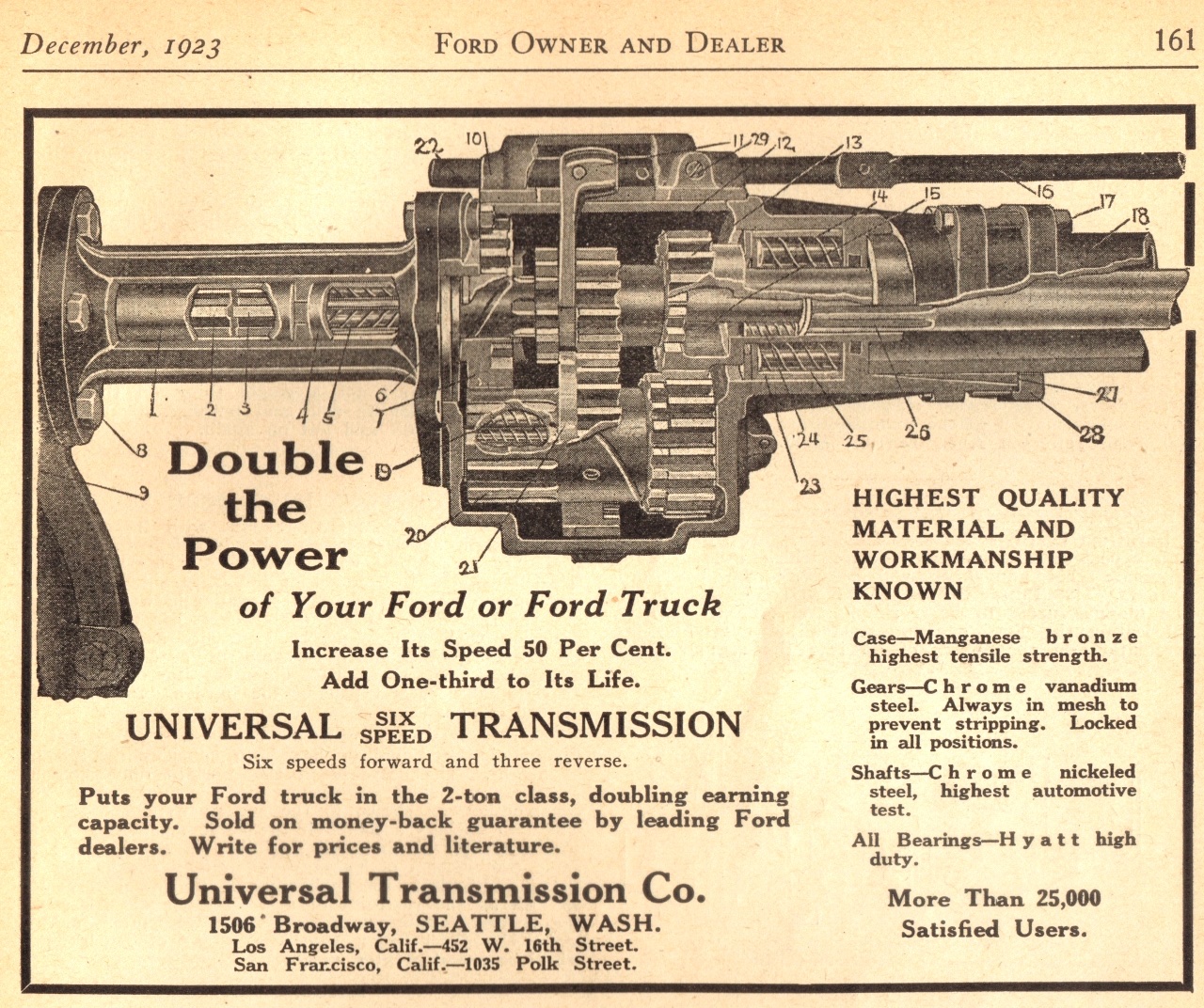

Here is an adv. on the Universal, the TT version, the T would have std. pinion housing as yours.
Don't know value today, but it is complete so someone may make you a good offer, if you place ad in Classifieds.

Universal made several variations of driveshaft mounted auxiliary transmissions for model Ts and TTs. I have had several of them over the years, and really like them.
The underdrives are desirable to some people in the HCCA crowd for early model Ts where they want the advantages of a Ruckstell for hilly driving but want to keep the early axle housings (which the Ruckstell does not fit onto) in their car.
Notice how the "UNDERDRIVE" is letter stamped onto a flat embossment on the main casting. They were designed so that the factory would use the same castings for both over drive and underdrive versions. It is possible however not practical to re-machine parts and convert one to the other. You may want to check to see if someone may have done that to yours? The underdrive was usually around fifty percent, and when turned around becomes nearly a one to two overdrive! That is really tall, and might explain the ten tooth pinion gear on an underdrive housing?

One point to add?
The three speed progressives and the two speed under or direct transmissions used different housings.
The TT ad that Dan T posted is for the TT three speed progressive shift version.
