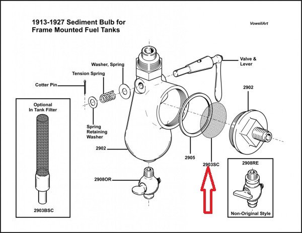

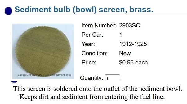

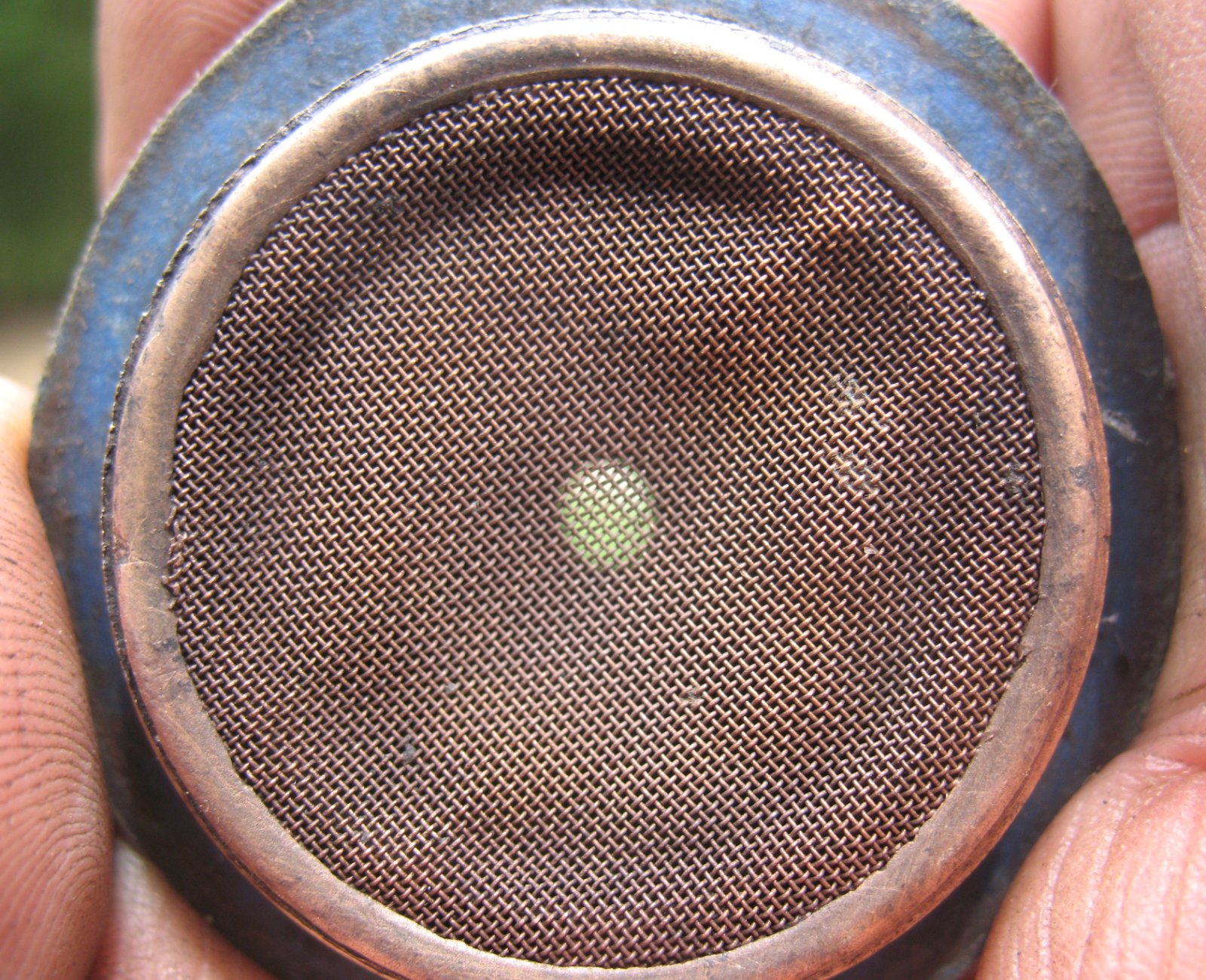

If you haven't checked the sediment bulb, its time to do it. I'd first drain the tank & take a peek inside to see if there is any residue in the bottom. Then check for any crud in the gas. Next the screen in the sediment bulb. It may have done its job & needs to be replaced. If you replace it don't bother to solder it back, just use some RTV around the edge. Makes it easier for the next time. Best to use an 8-point 11/26 socket so its flats match the covers

You do have a filter. When you de-solder it you might notice a very narrow edge of cap was rolled over the screen then soldered. Save time just use RTV to hold it in placeJugster wrote: ↑Tue May 06, 2025 12:17 amThanks for all the replies. The surging would indicate a fuel starvation problem. I have no filters and no fuel pump; I'm just gravity-feeding as per original configuration. I think the next step is to check the gas-cap for venting (but it won't be that), then pull the fuel tank out of the car to have it cleaned out. Because of the baffle, I can only see part of the bottom of the tank. Because of the stalling in 20-degree weather, I don't think the problem is vapor-lock, but it wouldn't hurt to insulate the fuel line and exhaust pipe.
