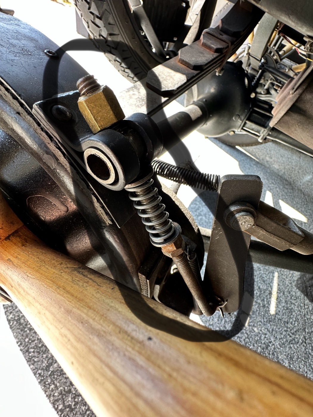

Part of my rocky mtn brakes came off and vanished into the ether the other day. I don’t need a whole new set, but some of the parts that went missing on my country drive. Where can I get just some replacement parts?

This part fell apart on my drivers side.

Re: Parts for Rocky Mountain Brakes
Post by speedytinc » Sun May 11, 2025 6:17 pm
Your adjusting nut is upside down. The ridges keep the nut from backing off.
Post by JBog » Sun May 11, 2025 8:03 pm
Thanks! I’ll fix that one. That’s probably how I lost the other side.
Post by speedytinc » Sun May 11, 2025 8:24 pm
Yep. If cotter pinned correctly, the rod should have stayed attached.
You should have lost the nut, 2 washers & a spring only.

I also lost the bushing or whatever it is that bolt passes through.

Post by Mark Gregush » Mon May 12, 2025 2:27 pm
Don't recall seeing that bushing on other setups? Otherwise, take the other side apart and make a trip to ACE or other hardware store and match the spring up and other missing nuts and washers as needed. The adjusting nut might be a little harder but longer type nut with bevels ground would work like the sample from the other side work, even a steel one. The sleeve would just be a piece of steel tube with hole drilled through it.

Post by Jerry VanOoteghem » Wed May 14, 2025 12:00 pm
Or even a solid piece of steel rod with a hole drilled through it.
Post by Craig Leach » Thu May 22, 2025 12:12 am
Hi Jason,
Have you been able to get the parts you need for your RM brakes? If not Mc Master-Carr has L bolts in 3/8 x 16 in many lengths of both
dimensions in Tensile strengths of 58,000-120,000 lb.& thread length. Look under Hook anchors for concrete. The adjuster nut can be made
from a 3/8" coarse rod coupler, the swivel tube can be made of any tubing of the correct Diameter & every thing else is hardware nuts, washers
spring & cotter pins.
