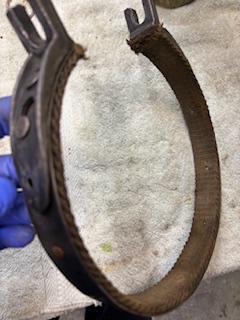

The cotton linings look a lot like cotton web you can buy by the roll off Amazon, can I use cotton web that's the right width and length of course? (I need to just replace my low band)

They're not all the same. What year?

1917, I'm no expert hence my asking but cotton web looks just like Scandinavia cotton linings and are a good deal cheaper.

Whatever current "cotton" webbing you are looking at, in no way has the same weave pattern as original Scandinavia & some later Cantex lining - the latest Scandi "tar babies" have a weave like modern cotton webbing - all I looked at online has the weave that "fades" under pedal pressure.

The labor to change bands is not worth the savings. Ask around many may have a extra band they will part with, I sold a single cotton band some
time ago when someone was just looking for 1 band. If you buy a set then you have spares. Remember you use the low band going down steep hills
& to slow the car before you brake.
Craig.

Craig makes a valid point. Changing bands is a labour intensive and time consuming task for even the more experienced T owner. To that end, to push the process further down the line, I don't bother with cotton linings at all, preferring to use longer lasting Kevlar linings. Others have different opinions about using Kevlar linings.

I would not suggest using nos cotton bands. They are usually dry rotted and will quickly fail in use. Been there, done that.

I asked what year to find out about the transmission. Before 1926 all three drums are the same width. If you can't find just a single lining, a full set of three will leave you with two extras.

I don't see the mention of several other things such as the weave and thickness of the belting. Most of the woven belting is going to be too thin and a loose weave.
