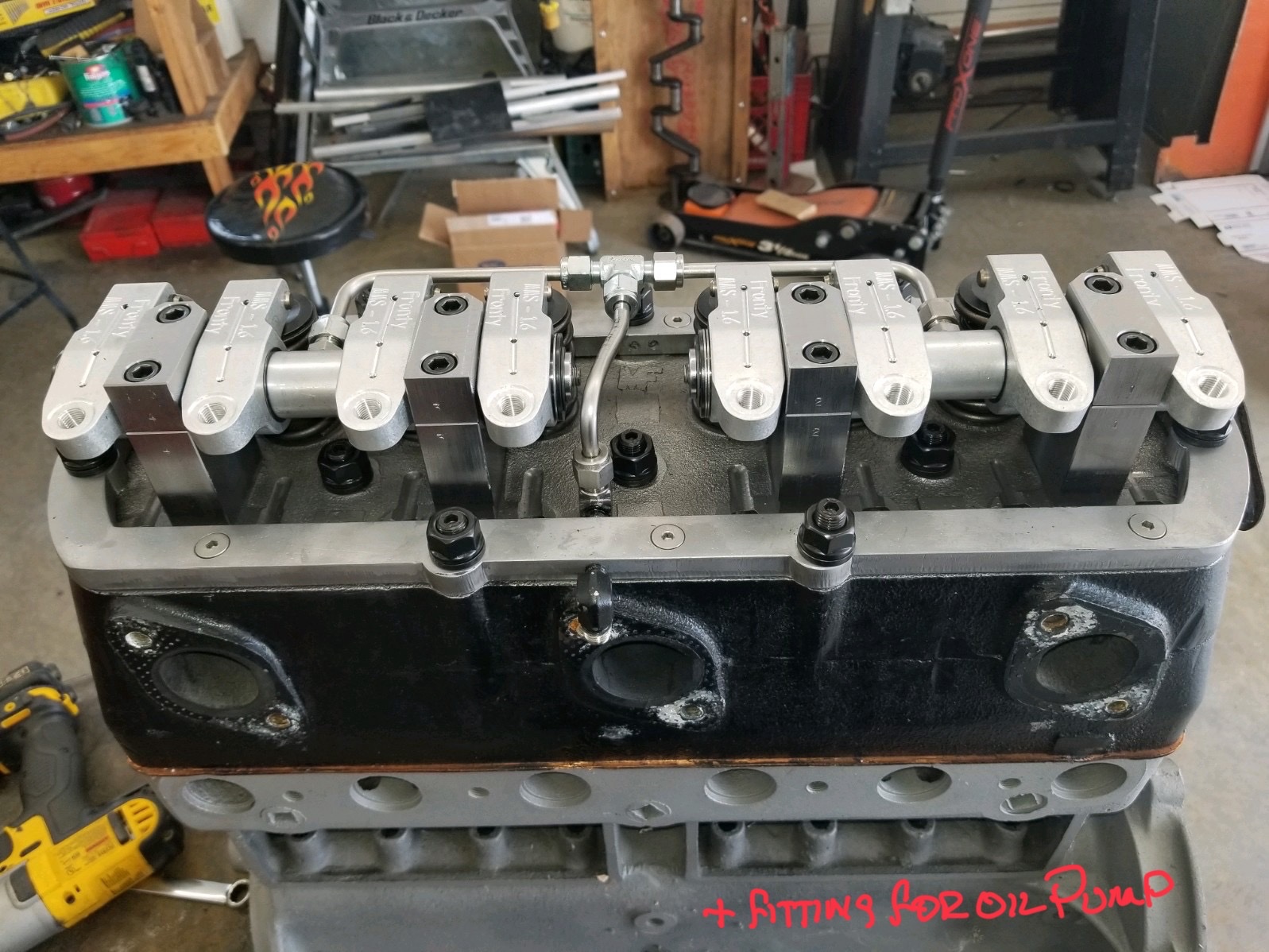

Both Roof and Frontys I have done the same way fundamentally…. Make a spacer 1/2’ thick. You can then drill and tap a 1/16 pipe thread oil line fittings Sent you a text
Shown is my Fronty set up

Mike,
That is entirely too beautiful.
Those Fronty rocker arms are exquisite!

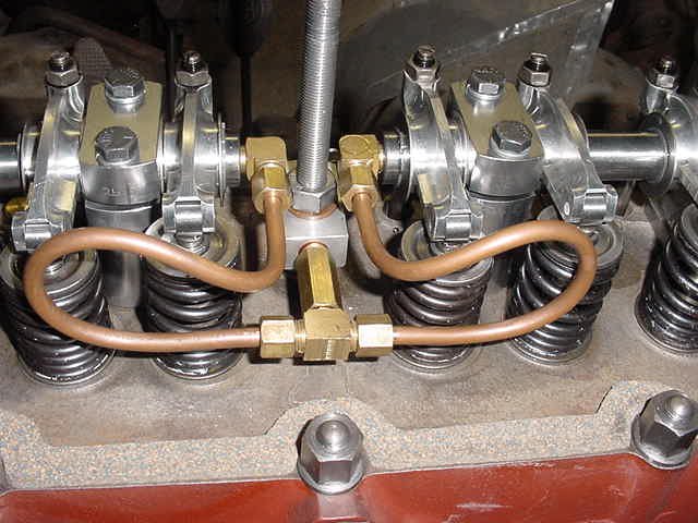

Re: OHV question - oil pressure to rocker arms?
Post by Mark Herdman » Mon Jul 07, 2025 2:41 am
Mine are pressurised via the rocker cover hold down stud. Stands are in steel and clamp onto the shaft so shafts can be used for oil ways.
