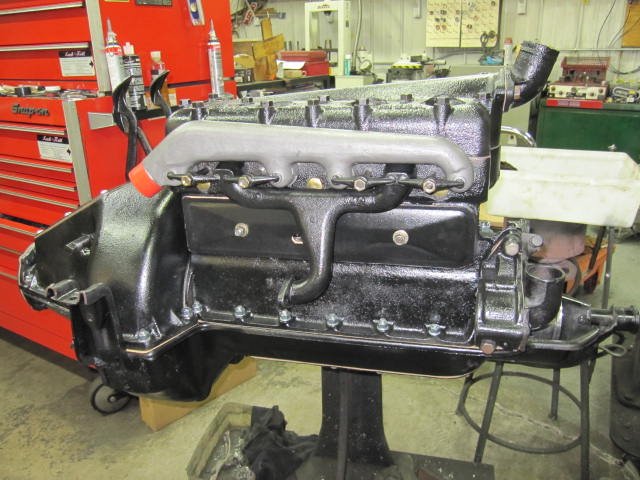

Mine also mounts on the two side water inlet bolts. I have two 5/16" bolts on the low side on which the block is fitted. These are just locators, rather than fixtures. The up side down block hangs on these while the side
bolts are fitted.
They stay that way throughout the build, the two pan rail bolts only being fitted once the engine is installed.
						bolts are fitted.

I don't see an issue as we've been doing so for 40 years now. KR Wilson was an authorized supplier of FORD tools . These are KRW stands we support the T, A and V8 engine's on .Martinbuilt wrote: ↑Wed May 28, 2025 10:55 amI'm new to model T's.
The motor i bought came mounted on a small wooden cart.
I recently overhauled a model A engine, which i had hanging on one of those water-inlet brackets that Snyders sells.
Is it safe to hang this T motor with the hogshead and everything together?
It seems like a lot of stress on those two threaded holes.
I'm sure Henry Ok'd how the engine was to mounted on an engine stand.
