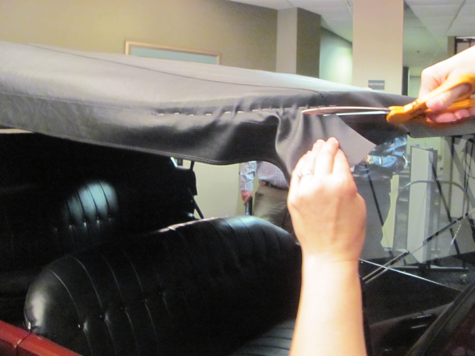

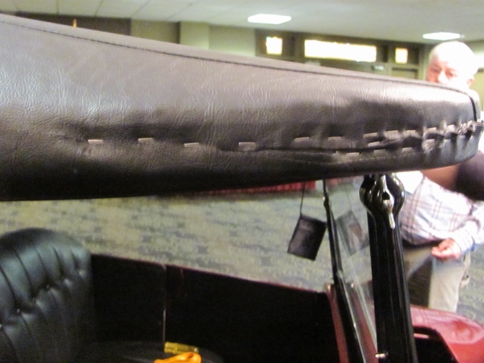

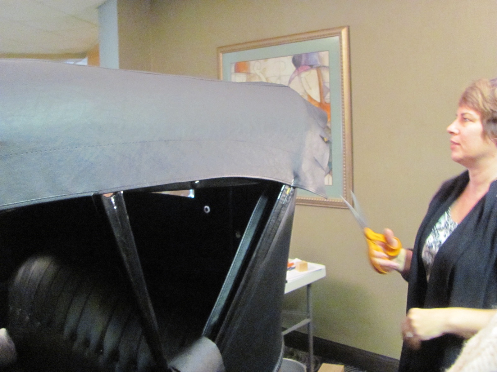

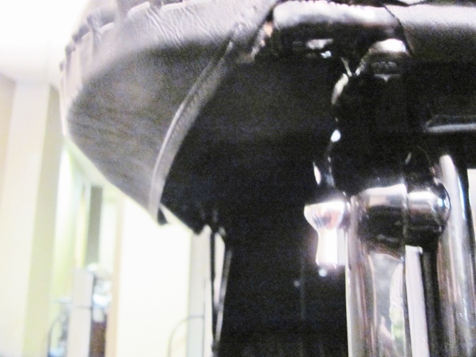

And some photos of of Elizabeth on doing a '27 top, these were taken at a work session she gave at a T meeting.
