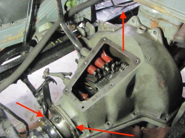

Pull the inspection cover and check the bands aren't still attached to the pedals. It should slide off but could be stuck. Other than taking the 4 bolts free from the 4th main (top and bottom) it should wrestle out.

Few other people seem to do it but I have never had luck pulling a hogshead with the exhaust manifold on the engine. With the manifold removed I can lift the hogshead straight up and then back to clear the flywheel/bands/drums.

The hogshead should remove by lifting straight up, sometimes a small tilt to the rear. Then when free of the engine block, tilt back to remove.
But be sure the rear U joint ball cap is free, remove bolts top and bottom. Sometimes sealant there keeps the back end down.
Free bands, and all other attachments like outside oil lines.

Check the back of your block. Early blocks are made straight just above the HH. Later blocks have a taper there to make it easier.
It can still be done on an early block, just takes a little more effort.

Is it possible that the clutch release ring is caught on something?. Try wiggling the clutch shaft while cover is being pulled up
In any case, you'll need lots of elbow room to put it back on in order to slide the clutch ring into position

Remove the exhaust manifold. (it may be possible without removing the manifold, but I found it must be removed to re-install, so pull it now.)
Remove the 4th main bolts.
Pull back the 4th main about 3/8". You can use a stack of spacer washers or a 7/16 nut with a longer bolt to keep the ball cap back @ one or both of the lower 2 mount holes.
Pivot the HH up @ the front.

Reading all the problems of removing the hogshead in the car, I believe that it would be easier to take the engine out then it would be easier to remove the hogshead.

If you are having this much strife getting the thing off, imagine putting it back on!
On our RHD cars getting the exhaust pipe out of the way often means taking the system off.
Sometimes the HH scrapes on the exhaust manifold getting it off. This means the exhaust manifold should come off, so you don't have to fight against it going back on.
Pulling back the fourth main cap widens the gap, also a help getting the thing back on.
I made a cradle to use when re-fitting the cover to take the weight of the thing as you juggle it into place. Then it can be a one man job.
Anything you can do to open up the gap and get stuff out of the way will help getting it back on.
