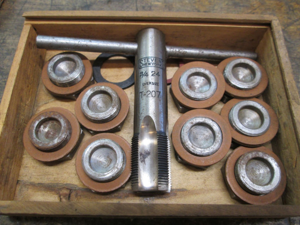

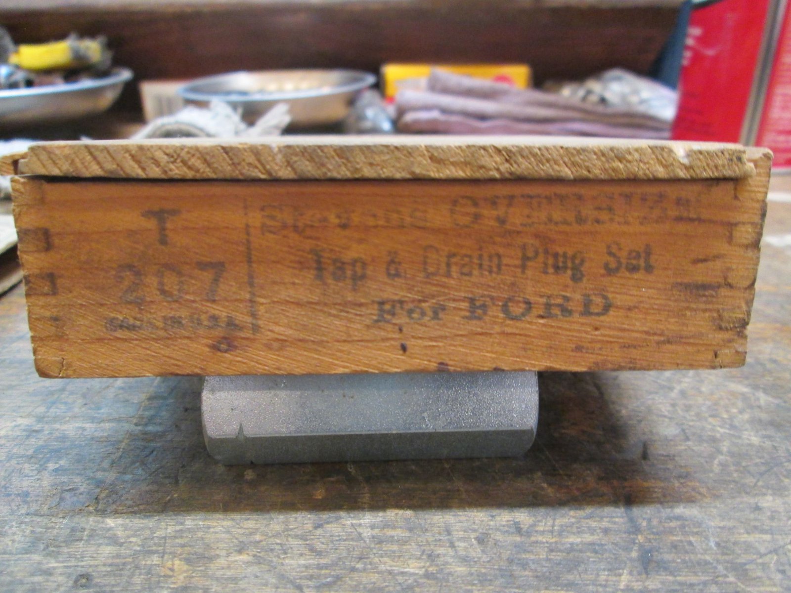

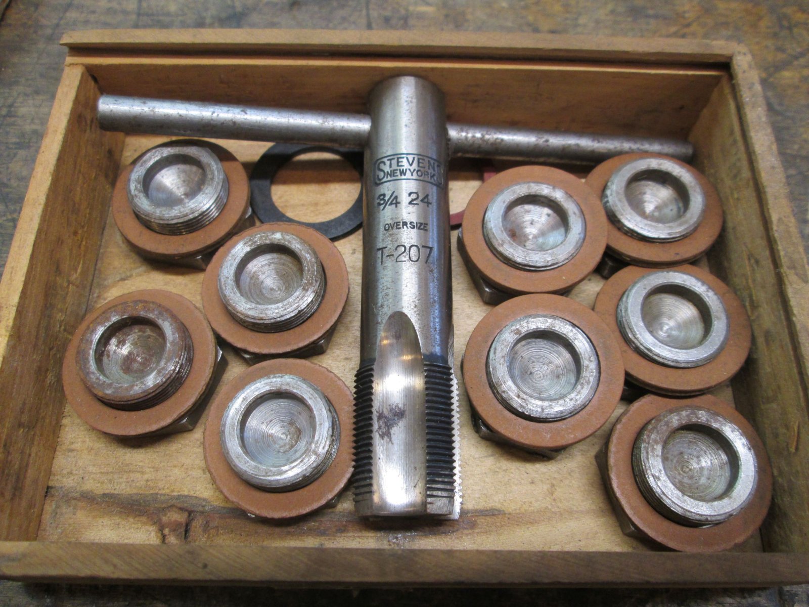

Post by RajoRacer » Sat Jun 14, 2025 2:49 pm
Any luck ? Here's a couple repair tools that Stevens Co. put out back in the day - both quite useful !

Post by NoelChico » Sat Jun 14, 2025 4:47 pm
Yes, there are drain plug kits. I recently purchased 2 of them. But Bruce wants to get this car going for Father's Day. Since you can see a few threads, it's partially out. Try the putty knives or some thin pry bars simultaneously with unscrewing it. Good luck, Bruce
