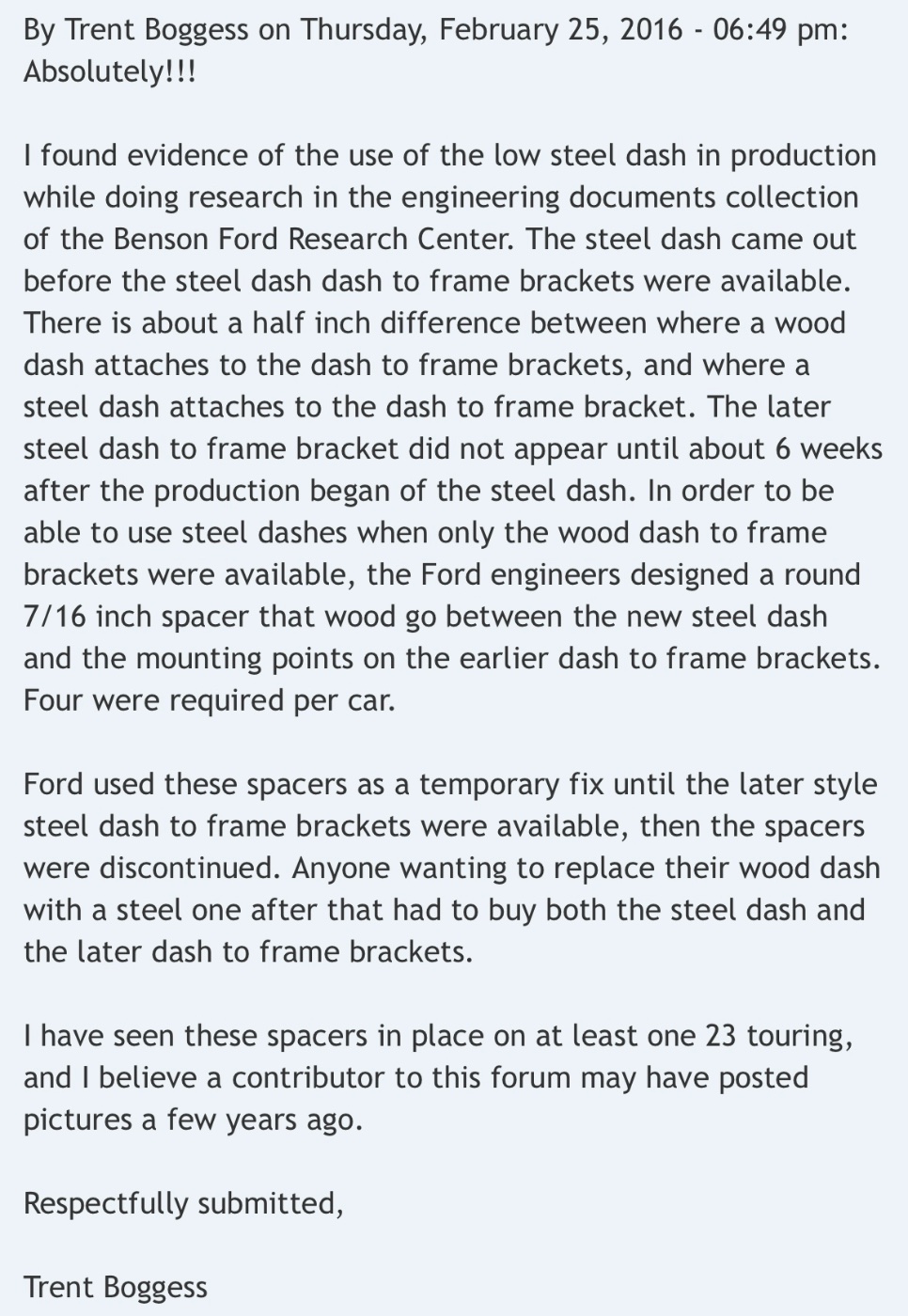

Jack - somewhere, I believe in the Service Bulletins there was an article referring that - Ford suggested using the outer radiator thimble as spacers (4).

Here is info on those spacers.

In Trent Boggess's article posted by Dan, he stated...
".... the Ford engineers designed a round 7/16 inch spacer that WOOD go between the new steel dash and the mounting points on the earlier dash to frame brackets."
Trent's subconscious led him to the better solution than that of the engineers.
