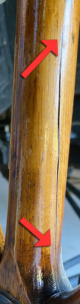

I have 30 x 3.5 demountable wheels. Two have been rebuilt by Stutzman and two are original. One of the original wheels has a single spoke that has a crack. In fact, there is a crack on both sides which may go all the way thru....I don't know. The spoke is otherwise very solid and the other spokes are likewise very solid. The tenons are in good shape, not eroded away like some.
My question for the group..... I'm considering a repair by injecting an epoxy resin into the cracks. Alternatively, if the collective wisdom of this group is that it's time to rebuild....that's what I'll do. I've some health issues that have slowed me down this year but I do hope to be able to drive my car and participate in a couple of Michigan events before the season ends.

I always lean on the side of caution when it comes to wheels. I’d say rebuild the wheel with new spokes. The rest of the spokes might not have visible cracks, but they are just as old and have just as many miles on them.
Here is another way to look at it. If you try to perform some type of repair and you are driving your T down a bumpy dirt road or swerve in traffic to avoid a collision are you gonna think to yourself, “I sure am glad I saved some money and epoxied that cracked spoke.”
Or if you rebuild the wheels with new spokes and are presented with the same driving situations, I’m sure you’d think to yourself, “Man, I sure am glad I have some rebuilt wheels!”

I will most likely get in trouble for this but one spoke does not a bad wheel make. I would think if you can get a thin epoxy that you can get deep into that crack would think you can get a few tours in then next off season send them to Noah. I would keep an eye on that one for piece of mind. I drove a T a while back that the spokes were so bad they sounded like a River Dance concert. Just saying.

Last time I injected Epoxy it lasted about a year until it let go. I don’t think you can get it clean and prepped well enough for epoxy to hold long term. IMO.

I would not rebuild the wheel for that alone. If everything else about the wheel is in good condition, I would go with the epoxy option, not so such to add strength, but to seal it from moisture.

Thanks for your comments. I have to scale back my driving this summer due to medical reasons so this is what I think I'll do. Inject epoxy into the cracks, at the same time giving the wheel a very thorough inspection. When the season ends, the wheel is off to Stutzman's for rebuild.
