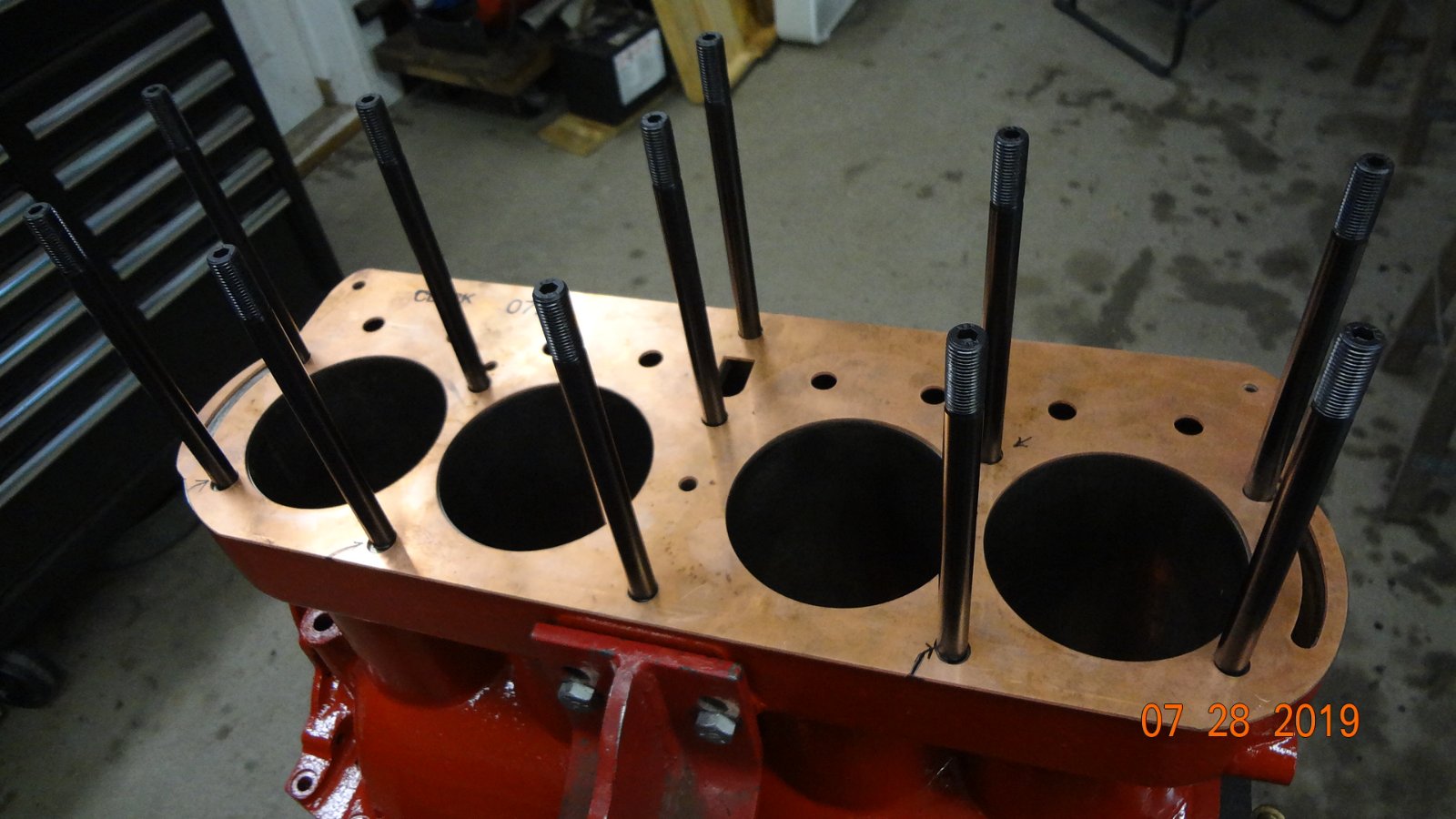

Hello: I used https://arp-bolts.com/. I used them on my 4 valve Rajo and my 8 valve overhead DePaul. I cleaned each block hole and measured the depth and wrote it down. Measure the thickness of the head gasket and write that down. measure the thickness of the head and write that down too. Call them they may have something close in stock. They have high quality products. Gary
PS: Yes that was a thick head.
