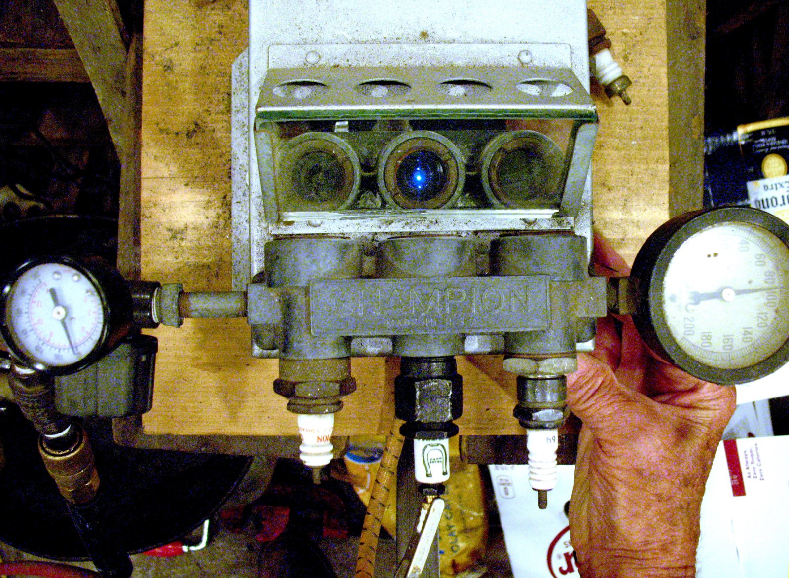

Posts: 7376
Re: stumbling / bucking
Post by Steve Jelf » Tue Jul 01, 2025 10:13 am
If you want to really test spark plugs, see how well they work under compression.

I am reading and listening to all comments. The Autolite 3095 is not a resistor plug. Steve, when I was much younger, the shop I worked in had one of those Champion spark plug tester. Ours was smaller and also had a sandblaster on it for cleaning the plugs too. An older mechanic showed me one time why he wouldn't use Champion spark plugs in large Chrysler engines. The spark would be intermittent at about 100 pounds.

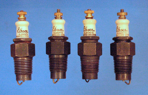

Posts: 7376
Post by Steve Jelf » Wed Jul 02, 2025 10:37 am
