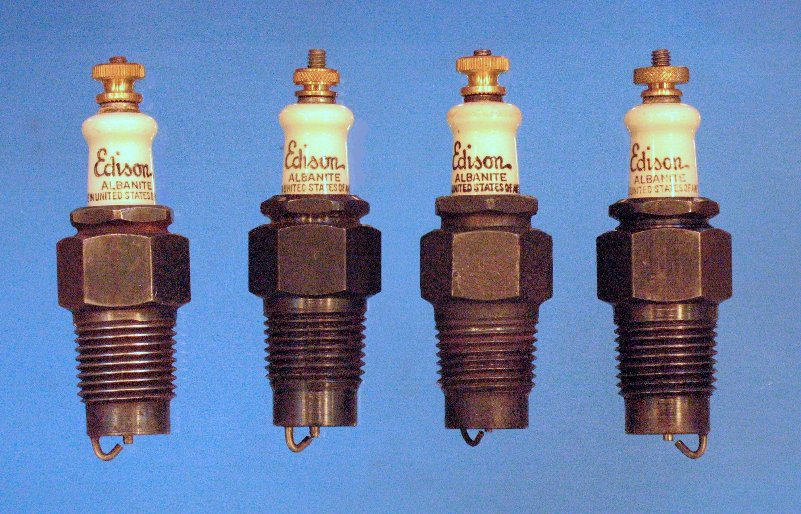

Posts: 7411
Re: stumbling / bucking
Post by Steve Jelf » Wed Jul 02, 2025 10:37 am
