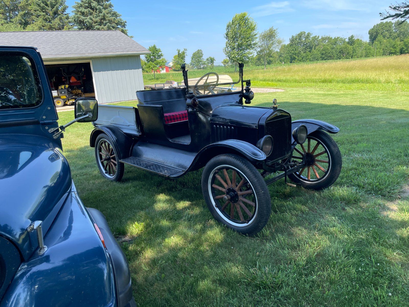

Hi Everyone. I have been wanting a Model T for a long time and finally got one. I picked up a 1917 Touring that has been converted to a pickup with the Ford metal pickup bed. It's a project and not restored (what I wanted so I can learn about it). It also needs upholstery work and its missing the wood backrest frame for the seat. Its pretty complete other than that and very little rust which is impressive for something so old. I also got a extra set of body panels (fenders, splash guards, running boards, etc). Must be from another car the owner had. Original owner died and the kids did not want it.
I have been learning a lot. I rebuilt the carb and got it running and took it on a short drive. Seems to work good after I figure out how to drive it. I thought I overheated it, but I made the mistake of overfilling the radiator (seems to like it just above the cooling fins?) This thing is nothing like a modern car so I have to reset my thinking. The radiator Motor Meter shows red but when I measure with my IR temp gun I get about 190 on the top of the radiator and 170's on the bottom. The engine head itself 204F. Seems okay? but who knows its 90F outside today and super humid. I was idling it a lot so I know that does not help as it likes to move. Fan works and belt is good.
One thing that concerns me is a clunky ratchet noise I get when I use the transmission brake from a higher speed say 20mph. Sounds like it is from the transmission and scares me to death but maybe its the rear end. Not sure on that.
So... I ordered the Service Manual and all the MTFCA books from Langs. I think I will check the transmission out and the rear axle for trouble. Maybe something is worn out or sloppy. Overall I love this thing! They drive really nice. Starts super easy too usually on half crank (no electric start for me).
