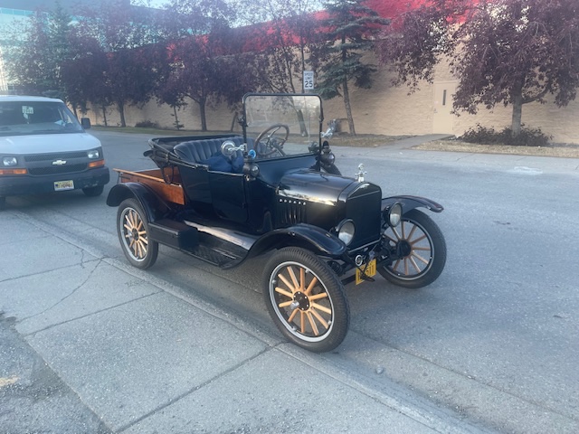

I went out tonight for dinner with the car club and my 22 conked out as I pulled into the parking lot. It has spark and compression so it is a fuel issue. Turns out my NH carb was pouring out gas. I tapped it and the fuel stopped. Then I could start it and it would run fine but would conk out after a bit, I think when the float was overwhelmed and it flooded. It was getting late so some friends towed me home. It was my first “failure to proceed” in the T. Here is a photo to commemorate the occasion. I will pull the carb and get it sorted. Luckily, I just ordered one of Scott Congers full flow valves to put it while I have it out.

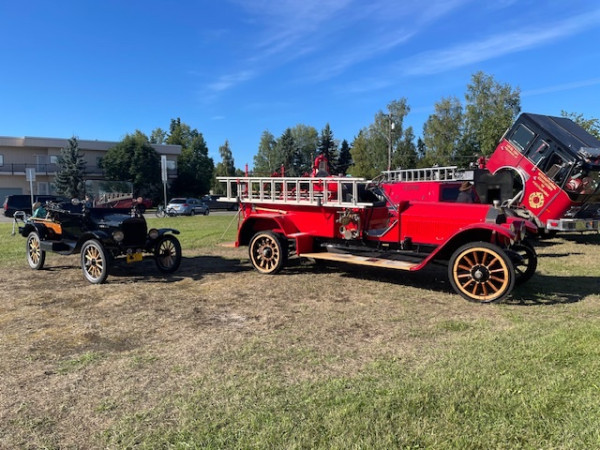

I took the car to a show today and it ran fine with the new needle. As the oldest car there they asked me to park it next to the fire department’s restored 1923 fire engine.
