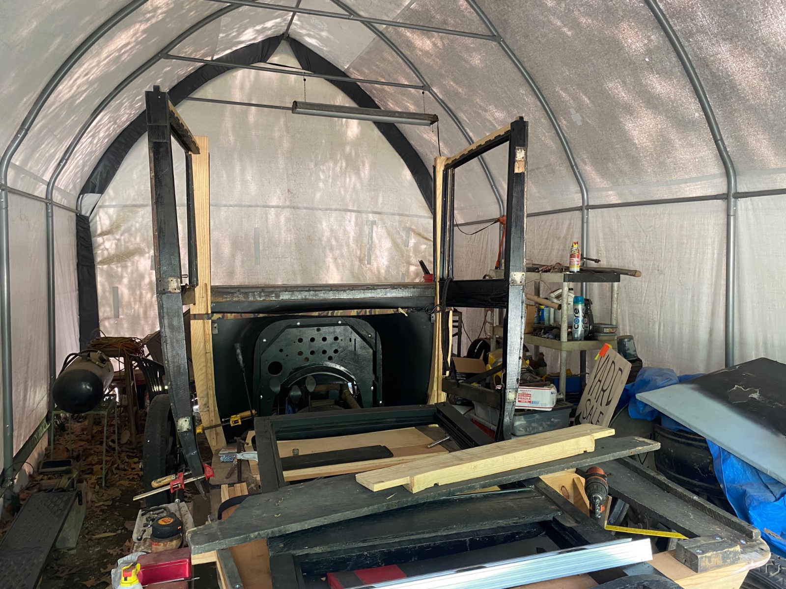

Nothing but a giant jigsaw puzzle with no instructions on the box.
Work is going slow as I am taking my time and test fitting to get the best fit I can get.
Maybe in another year I’ll have the windshield installed.

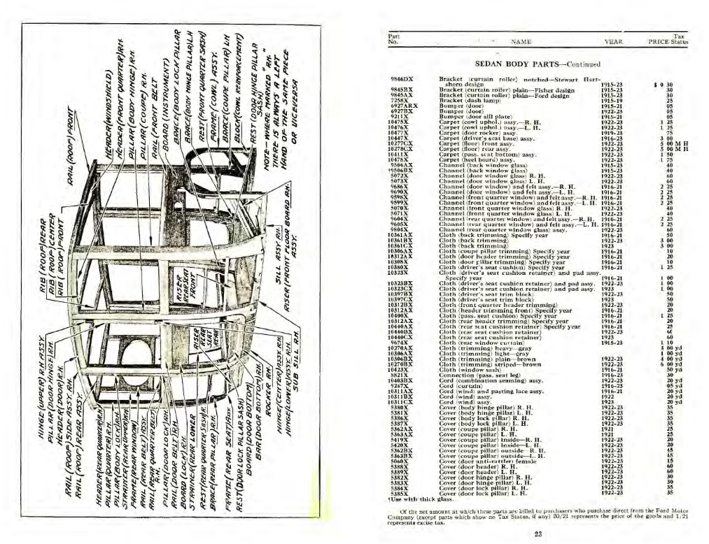

Maybe this will help visualize he puzzle https://www.cimorelli.com/mtdl/1923/1923bplsep.pdf
Scroll down to page 26 & then more pages

I have all of that plus several hundred photos of other cars in various states of repair.

For what it’s worth Fordwood sells the top wood and related parts but you probably already know that. Yes they are slow but the top and other wood parts might be a way to at least start getting a better idea how the parts go together. I have a feeling the sedan body wood was put together in a general way at the factory and not every car was exactly alike in the fit up when they were put together at the factory.
