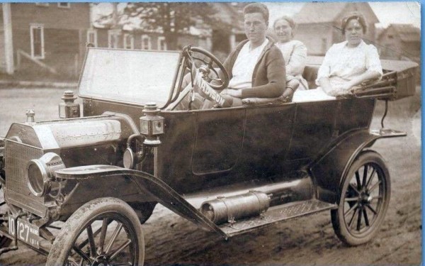

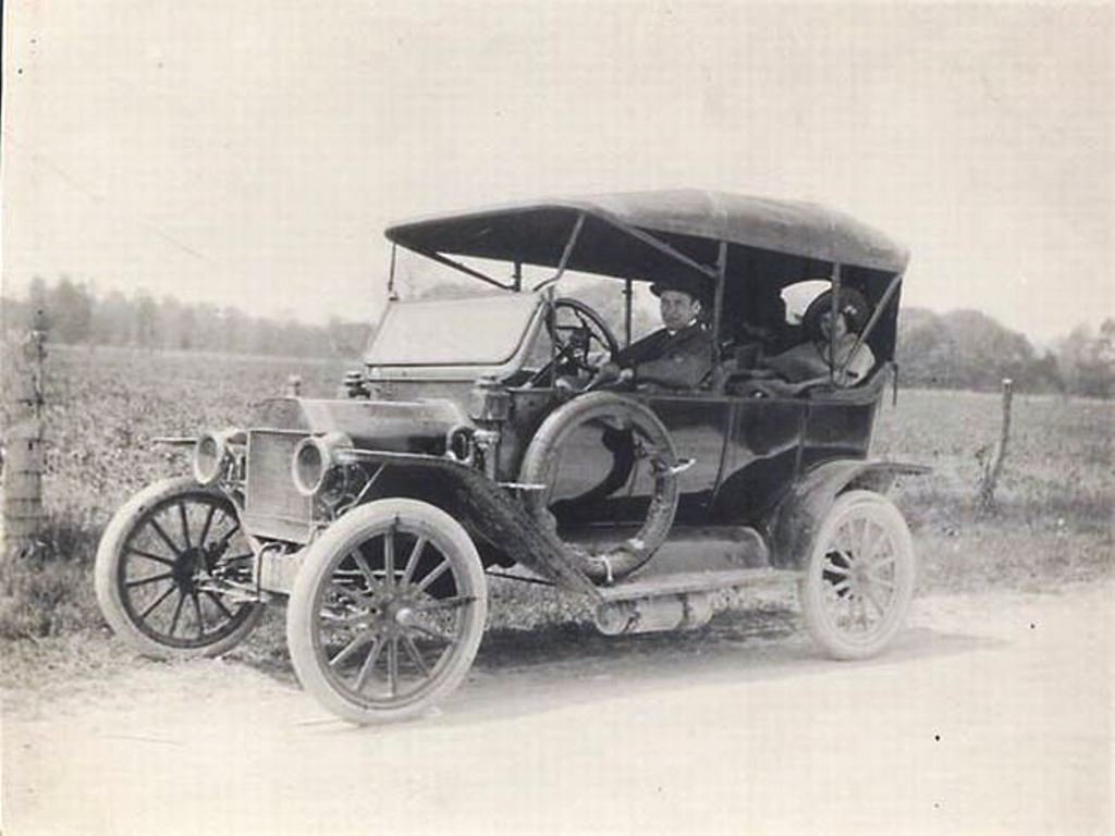

As to the the valve at the front or at the back, I have see it both ways in period photographs and on restored cars. I suspect that tank orientation was entirely owner preference and convenience. For some, it might have been easier to have the valve at the front and the gauge at the rear of the tank would be protected from flying stones. Good luck with your project, Bill

The tank is mounted horizontally with the valve at the top. Generally the valve is at the front (closest to the headlights). All the original tanks I have seen were nickle plated.

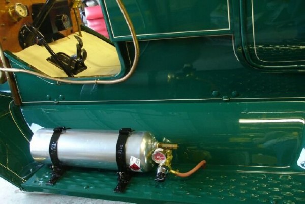

Hi John, I also have 2 P O L tanks & both have the galvanized finish. I have one on my '14 Touring and I painted it with Rustoleum silver. I mounted it with the valve to the front of the car, and of course with the offset valve to the top. I agree with the others that the valve can be to the front or rear of the car, which ever the owner prefers.

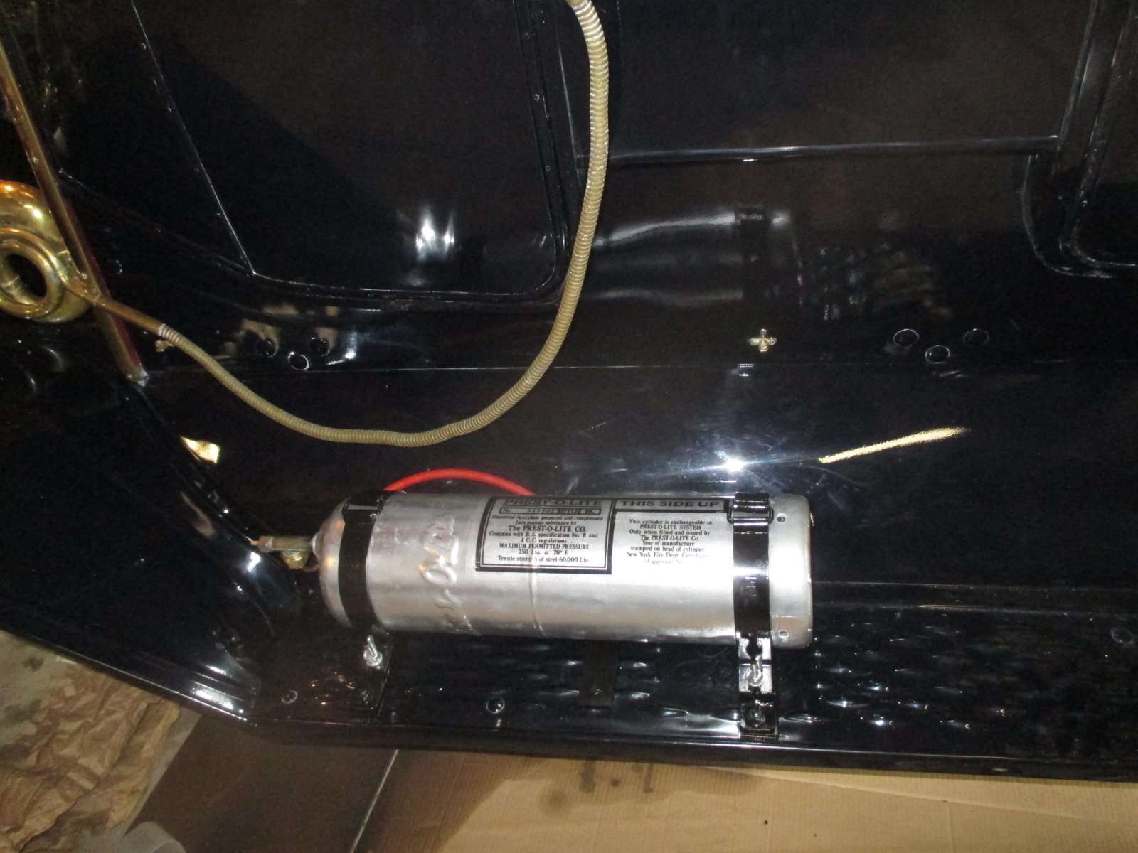

Here is my Prest-O-Lite tank:
It is a B type tank.
Restoration Supply has a decal for the "E style" tank, which is shorter than the B.
I got my "B type" decal from a forum member who had some made.
Keith
