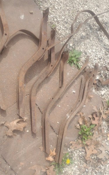

I don't what is typically used but TT brackets have have a different flange on the end of the bracket. They don't go across the frame.
- Attachments
- 20240423_100130.jpg (62.23 KiB) Viewed 789 times

I believe those are TT brackets. They should have the same drop, as the front mudguards are attached just as they were on the cars.
- Posts: 7309
Re: Speedster running board brackets?
On second thoughts, when mounted on the bottom of a deeper TT frame, the drop in the arms will be smaller than on a car, so they may be better for your purpose
