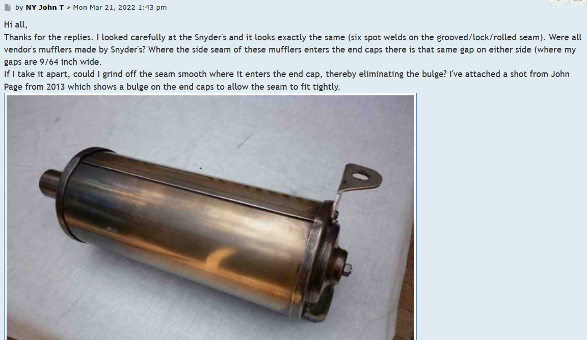

Some more info viewtopic.php?t=27863
Posts: 7275
Re: Stainless steel muffler with tail pipe
Post by Allan » Thu Jul 31, 2025 4:51 am
The muffler shown in Frank's photo is made incorrectly, stainless or otherwise. Rolling the outer shell was not done as it should be. Because the shell needs to go INSIDE the lip on the muffler ends, the joint ridge should be folded with the overlapping edges on the INSIDE of the shell. Then there is no need to beat a relief in the muffler ends to accommodate it.
That type of rolled joint, on the outside of the shell, should be reserved for the cast iron muffler ends, where the shell goes over a land on the shell, rather than into it. Making them correctly is not difficult. It just requires attention to detail. My sheetmetal worker who rolls the shells for the mufflers I assemble calls them inside and outside seams.
