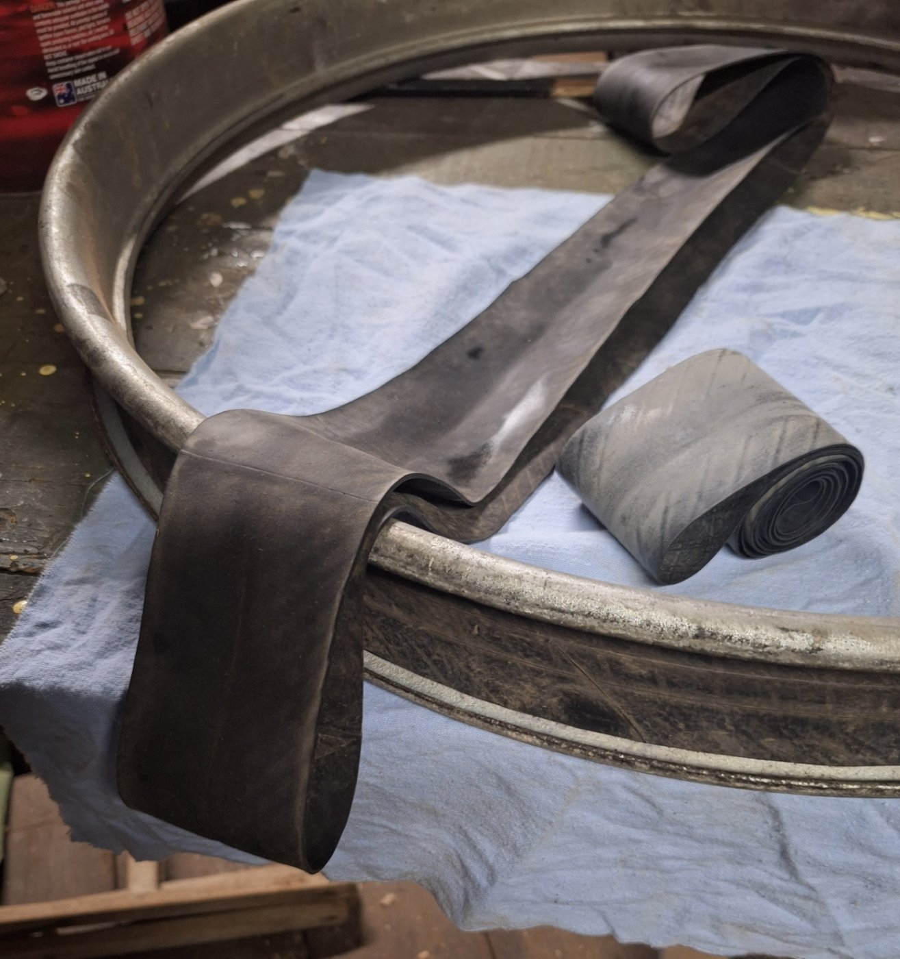

Here you go Steve. Not a $54 flap, snap fit rim liners cut from old 13-14" inner tubes, usually free from any tyre fitter. Give the waiting list a miss, unless of course you are looking for 21" flaps for split rims.
Allan from down under.-
